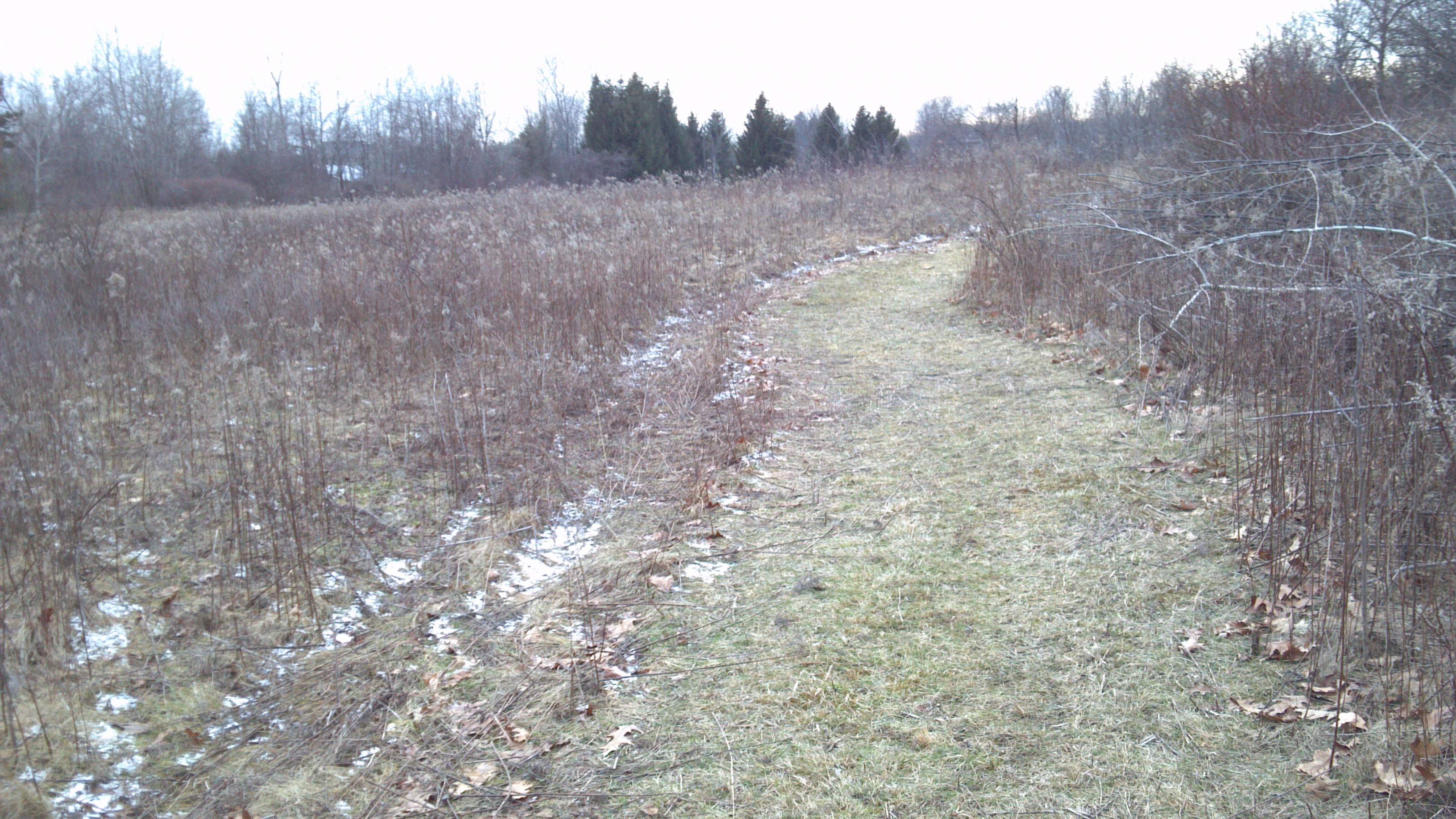

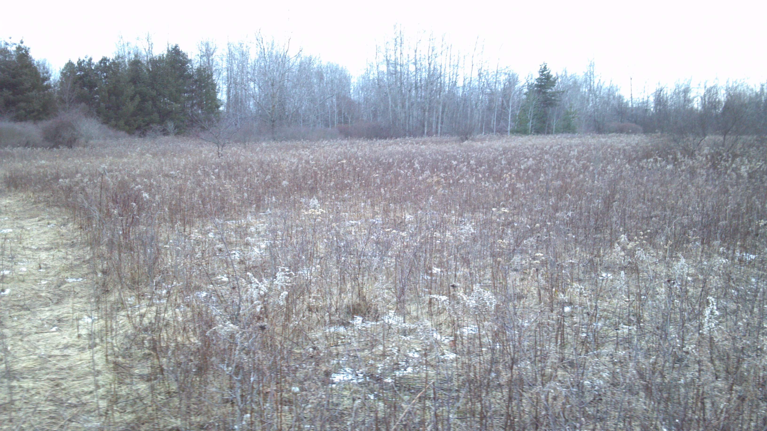

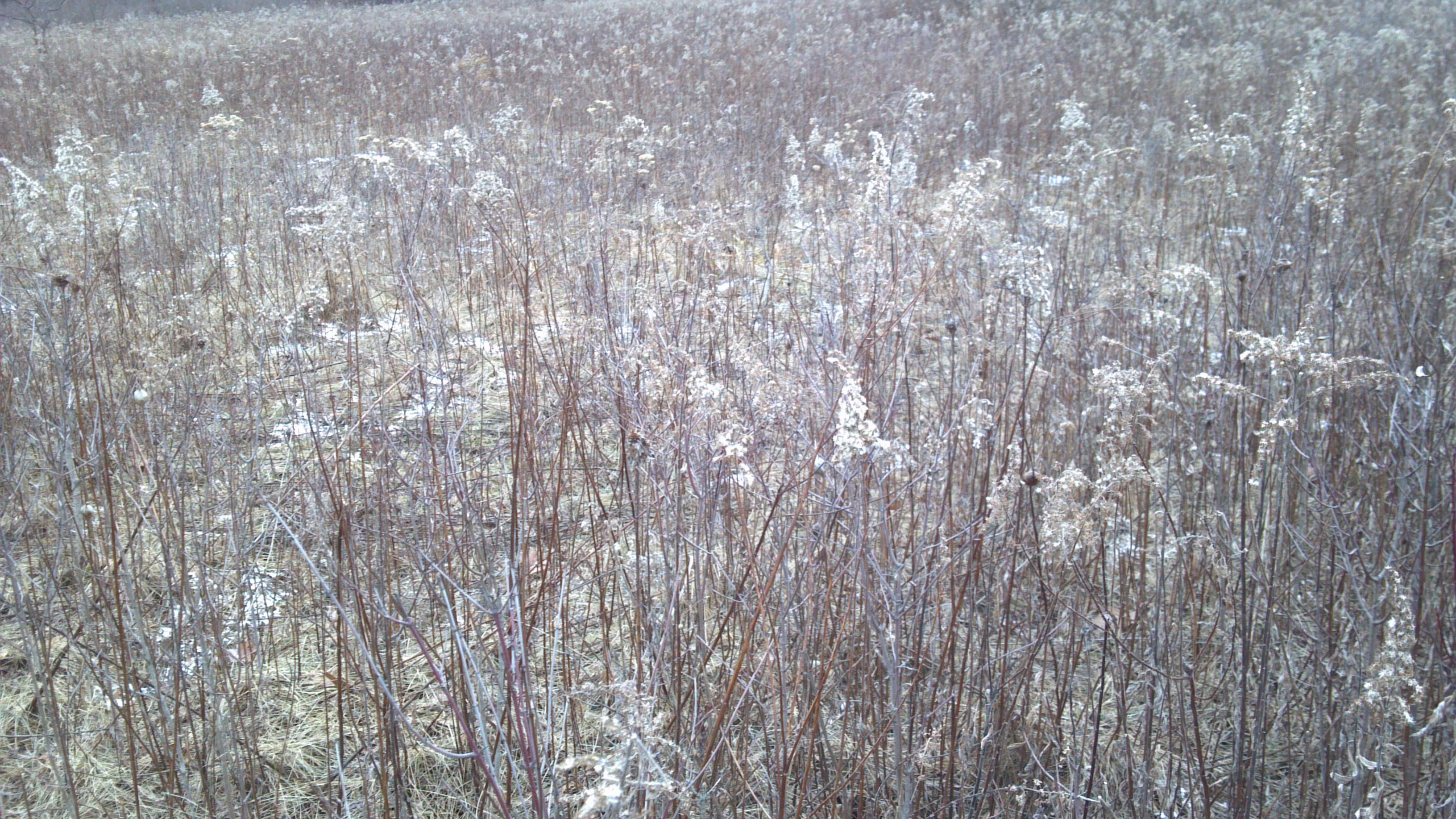

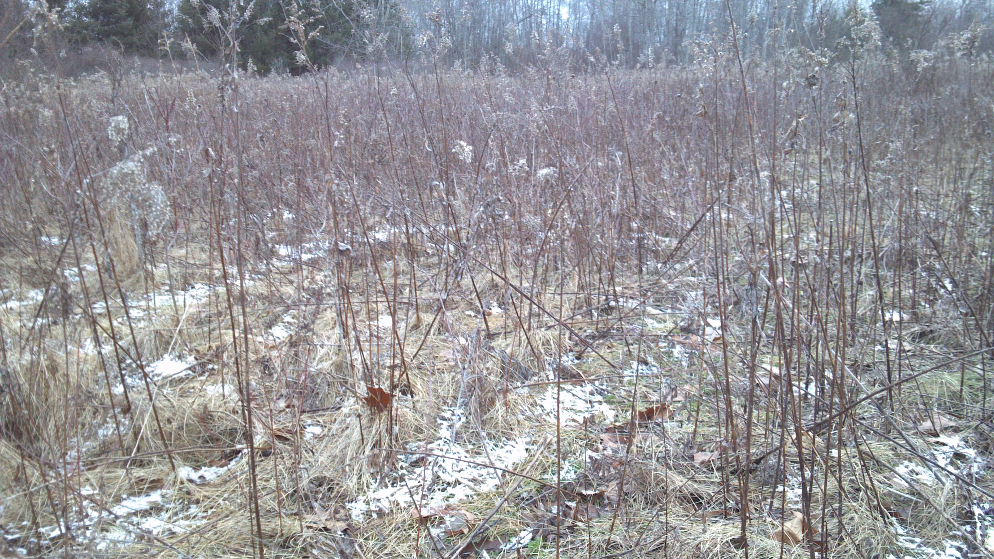

Here is a pic of one of the fields, approx 3-4 acres inside of the tree lines. I was told that it was used for farming "Winter Wheat" back in the day, but I never verified that. The edges of the field have rock piles, so I'm assuming that they removed most of the rocks when they were farming it. All I really do with it now is Hunt. The other field is also 3 acres and is a mowed grass field - no brush & minimal weeds. Looks like fescue. We use it as a driving range now, but I can scale back on THAT.
Can anyone tell me what type of plants (WEEDS) I have here now? This summer/fall, in bloom, was a mix of white, yellow, and purple flowers on top of the stalks. I mowed a path around it with my finish mower, and it looked like grass underneath.
Also, if growing hay on this small of a scale wouldn't be worth it, is there any crop that would yield a better return? And, keep in mind, this is only for part-time (weekend) hobby farming. Anything that my tractor would handle any better, and/or, with cheaper equipment?

Check soil test and bush hog what is there for a year and broadcast red clover that works in your area. next year cut hay and bail where you can and bush hog what you can't, keep doing that for a while and you can learn cheaper than if you work it all up and plant alfalfa ect. there is a lot of good grass in there just have to get ahead of the weeds.

If it was my field I would be mowing it regularly to get the weeds under control, spraying to get the weeds under control, and talking with the local AG agent to see what grows well and getting that soil test done. Our 8 acres of fields are for horses. Not enough fertilizer and lime on it for proper grass in my eyes but we have easy keeper horses that if I did what I wanted with fertilizer, aerator, and lime they would have founder problems. I have soil on my land that seems to grow nothing but on other parts I seem to have a foot of topsoil and things grow well there. The only thing I can say is I have the bitterweed and blackberries under control. Some of the other weeds are edible and some of the others take too much 2,4d to control and that is contrary to our minimal impact, bad to spray poison around the horses philosophy.
