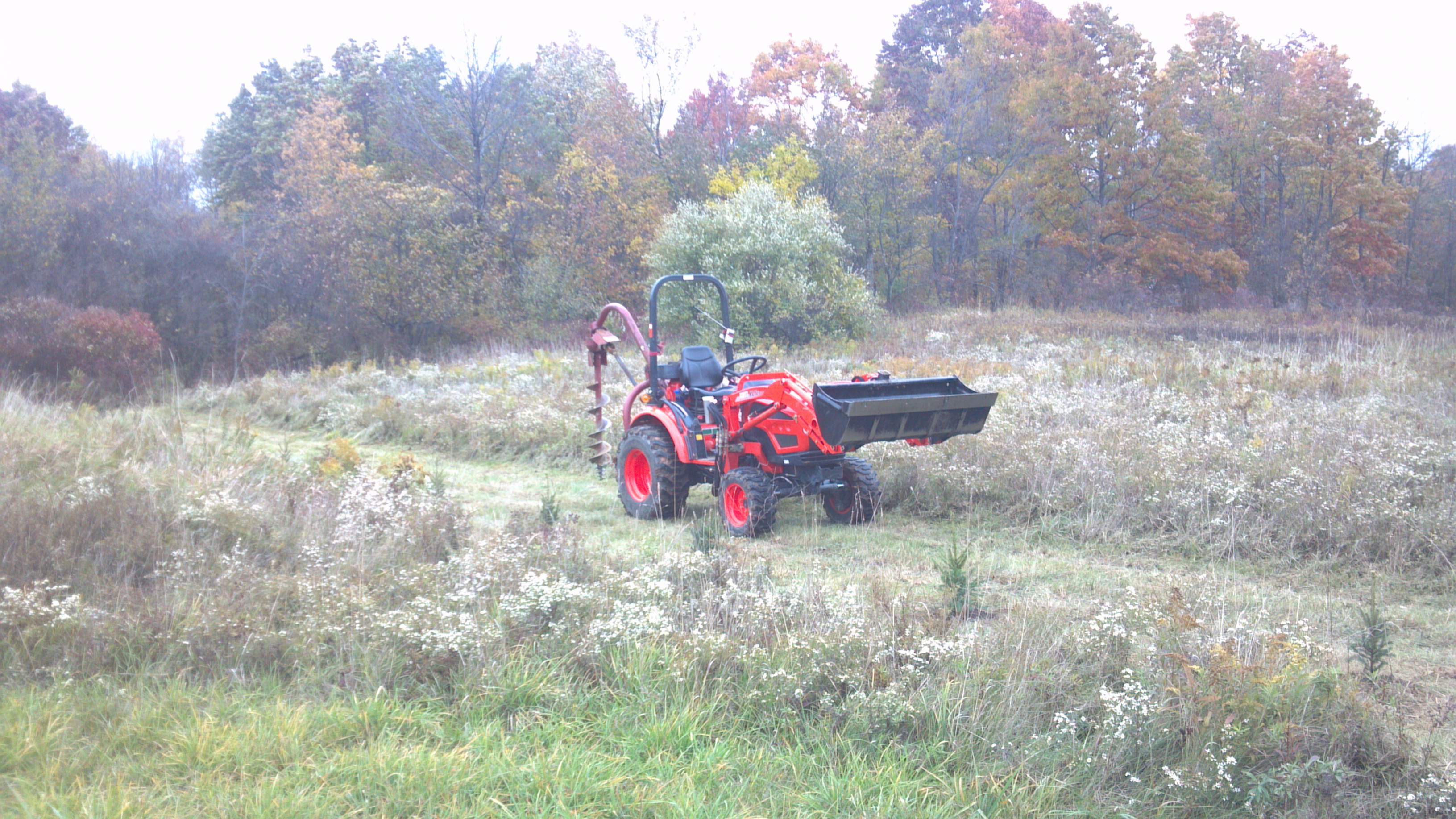

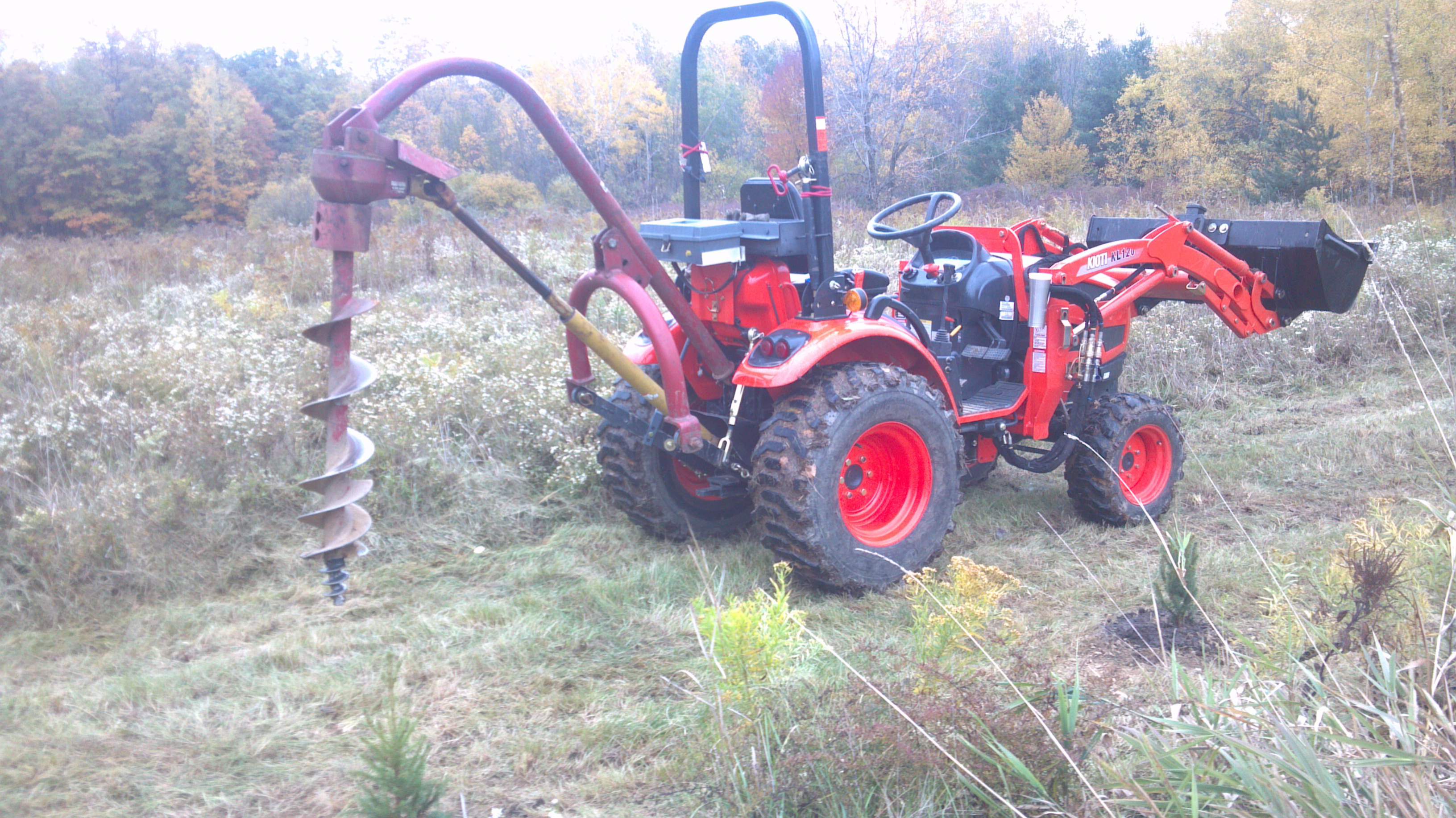

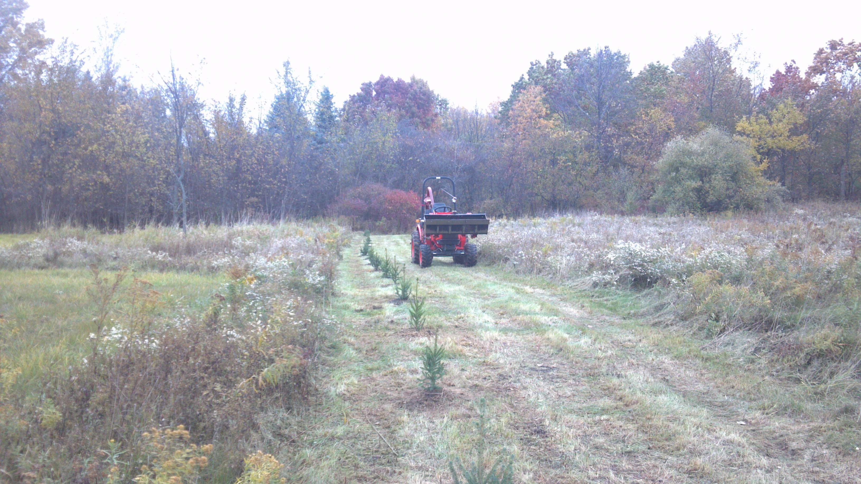

Also, here are a couple more pics from a few months ago... It's already past full bloom, but maybe you can tell me what weeds/plants this is. Also, someone mentioned I should brush hog it continuously this year, and apply "Red Clover" to keep the weeds down. Is that condusive to getting it ready to plant for the following year (2014) ??? From what I'm reading, 2013 will probably be a "prep" year to get the ground ready to start growing in 2014. True?

I'm no expert... but the yellow flowers you mentioned are probably goldenrod and the purple flowers are probably ironweed. Typical stuff that grows up in an old field. Ironweed is a sign of poor soil quality. Have your NCRS - ag extension guy come out and he will give you good info. Also, have your soil tested. And finally, for the love of god, cut down that big invasive autumn olive bush in the background!! :) And learn how to control them. For an autumn olive that big you'd want to hack a notch in the bark with a machete or hatchet and treat with Tordon RTU. If you just cut it it will grow back. Spray smaller plants with good strength roundup. Your NCRS might even have an "EQUIP" program to help you control invasives.
