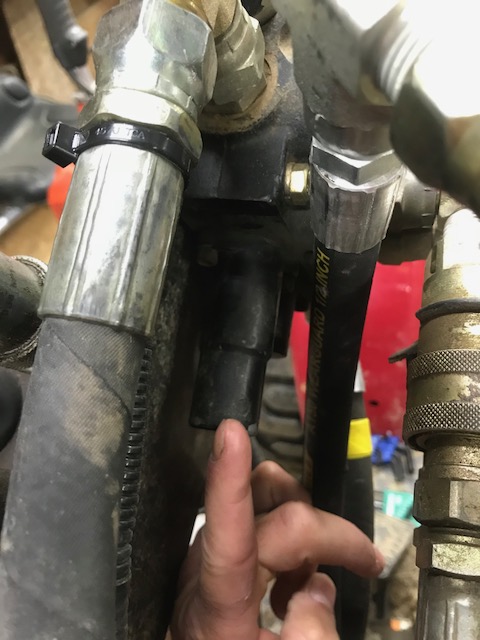

Tony83 I had the same issue about 6 months ago with my mahindra 4010 bungee cord and all to keep the valve from slowly lifting my loader arms unless I had about 1000 lbs hanging off the front. It ended up being the spring centering unit on the end of the valve assembly needing tightened up. I will try and take the cover off mine tomorrow and snap a pic of the adjustment I had to make. I believe it took a large flat head screw driver if I am not mistaken after taking the plastic cover off with 2 Allen head screws. Hope this helps because I understand your frustration with it.

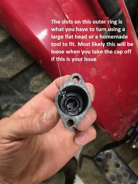

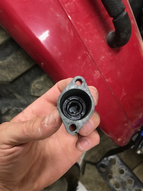

I noticed this was posted about 2 months ago so maybe the issue has been resolved but here are the pics of what the issue was for my loader valve. The cap can be taken off with a 4mm allen wrench. And then the outer ring in the cap with slots needs to be tightened up.

We moved about a year ago so I’m just looking at this. It was the loose slotted piece inside the back cap to the spool that Whfabrication showed. Thanks for the tip, I would never have realized that.
