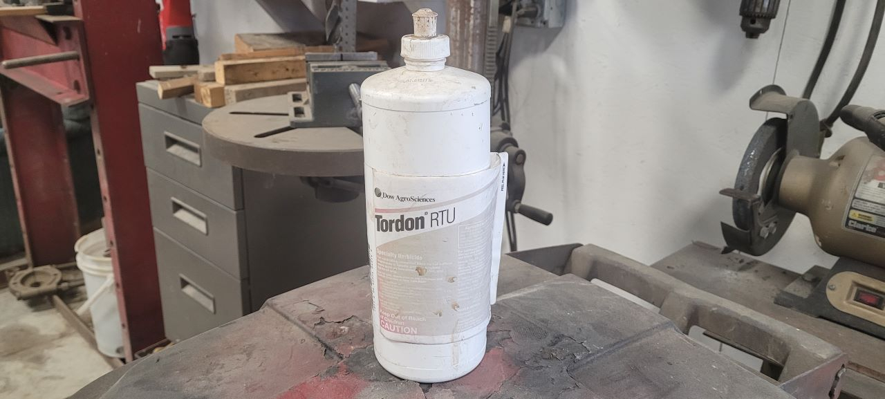

Tordon RTU is already blue. Easy to see treatment. On a stump 2-3" diameter a teaspoon full is enough. I buy it in Quart squirt bottles. Extremely easy to use versus a product that requires transferring to a usable container.
For spraying I prefer Remedy. Have also had good luck with Crossbow.
   / lopping young trees, Remedy or Tordon? #17
For the primary purpose of treating fresh cut stumps, nothing can be simpler and easier to manage than this. No mess. No broad kill. I have no idea how many small stumps this bottle will kill. Takes a teaspoon or less.
   / lopping young trees, Remedy or Tordon? #18
I believe I may try this type product rather than the Tordon. There are reports that Tordon can migrate. If I get a quart of something with triclopyr and use it straight, in a small squirt, bottle, it should last a while.

Tordon will root translocate. Witnessed personally at a state tree farm the sprayed brush along a road and killed the 75 foot tall cottonwood trees 50 feet behind them
