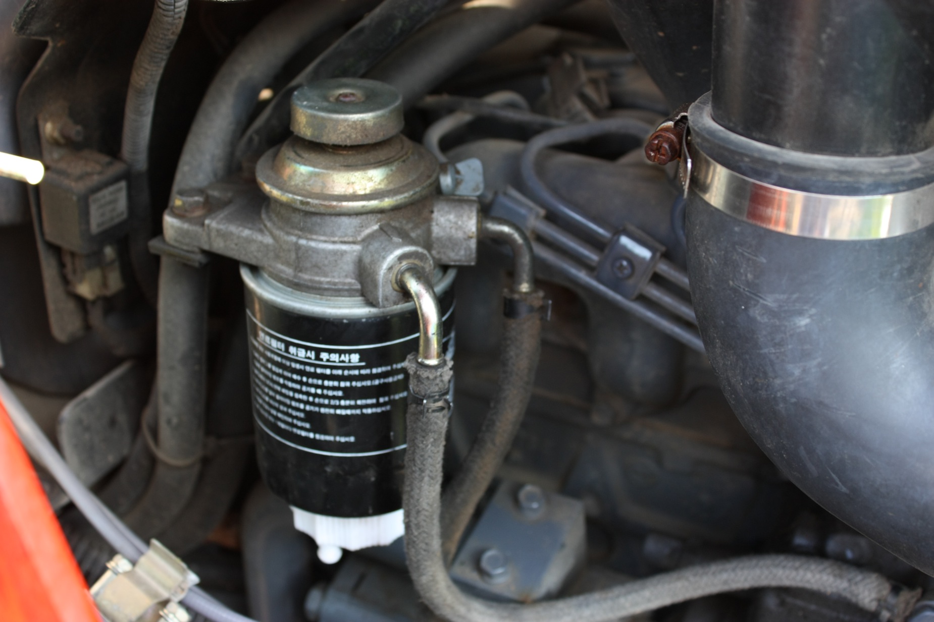

Thanks all... couldn't wait for dealer to try and fix this. I didn't get a filter but did the following.
Kiotidave, I completely drained tank. I also took hose of pump - a little bit of brown gunk
came out. I submerged filter in diesel fuel and put back on. When I emptied the tank there was a considerable amount of water coming out towards the end. I filled with new fuel and let it run for 10 or 15 minutes. I ran down the lane and did my usual return in 4th gear. It didn't bog down as much and I didn't need to shift down.
Hopefully it was just a case of water in the tank settling at the bottom. Do they make a filter that can separate water from fuel like you would see on a power boat? They usually have a glass or see through plastic bottom with drain you can open to let the water out.
I will have dealer go through his routine next week and replace the filter. I will leave it parked till then.
Thanks all...
   / Loss of power #14
I would expect the OEM filter and bowl assembly to be a water separator. As in, the bottom of the clear bowl should show visible water if there was any.
   / Loss of power
#15
HBeam,
My filter has a plastic white bottom that threads into the filter and a hose attachment on the bottom of the plastic unit.
I will take pics and post later.
lloyd

   / Loss of power #16
I know this is off topic but if you do a search on the fuel filter housings you will find a few threads about trouble they were having with the white housings developing creaks and leaking" not the clear one"
Just a note of interest.
   / Loss of power #17
Chances are the new replacement fuel filter could/will plug up. Cheap insurance, after the dealer changes the fuel filter, buy a second fuel filter as back up.

Dealer tech dropped by today.
A number of factors:
1/ fuel filter
2/ Fuel conditioner
3/ Brake adjustments - he adjusted the brakes at the last service and may have over adjusted them.
All is well for now....
