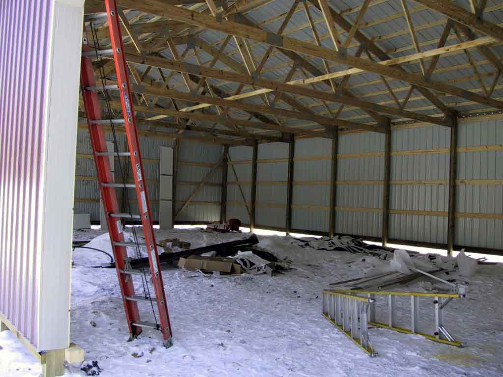

</font><font color="blue" class="small">( If I buy a kit, will it explain things like setting the posts -- and how do you get them all even at the top? )</font>
I liked the method that Cleary used when they put up my polebarn this past December.
The poles were all prefabbed from the factory - 3-ply 2 x 6's, nailed together, and were over length by several feet. The center ply (2 x 6) was shorter than the two outside ones. It flush with the bottom of the other plys but 5' shorter at the top.
What they did was set and level all the poles, and then install 4 rows of 2 x 6 girts all around the outside to tie it all together and keep it from moving. After that was done a spacer block was cut for each pole individually to fill in the center of the poles and provide the correct height to set the trusses (which were made from 2 x lumber) on. This allowed the poles to be set without having to make sure they were all exactly the correct height initially ..... they only had to be close and it created a saddle for the truss to lay in.
Once the trusses were set they installed two 1/2" x 8" stainless steel bolts thru the poles and the truss for each connection point. Then the extra length of the outside two plys (which stuck up above the trusses) were trimmed off flush.
