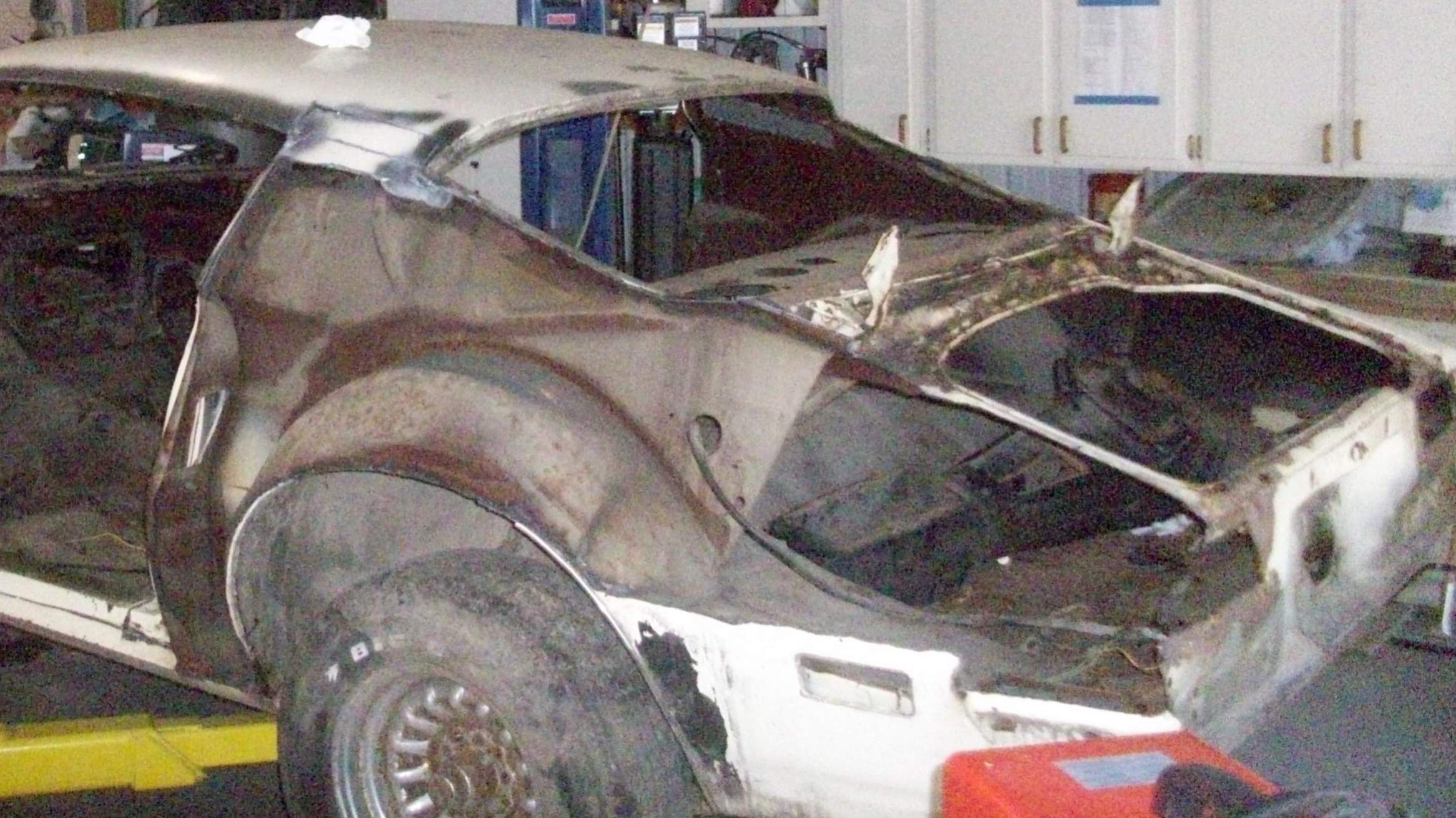

I have used the plasma cutter a fair amount- sectioned parts of a quarter panel from a 73 firebird for my sons formula 400, it helps to have some kind of guide but the cutter has worked well. plasma cutting 009.jpg
Edit - went ahead and completely stripped this firebird for parts and usable sheetmetal

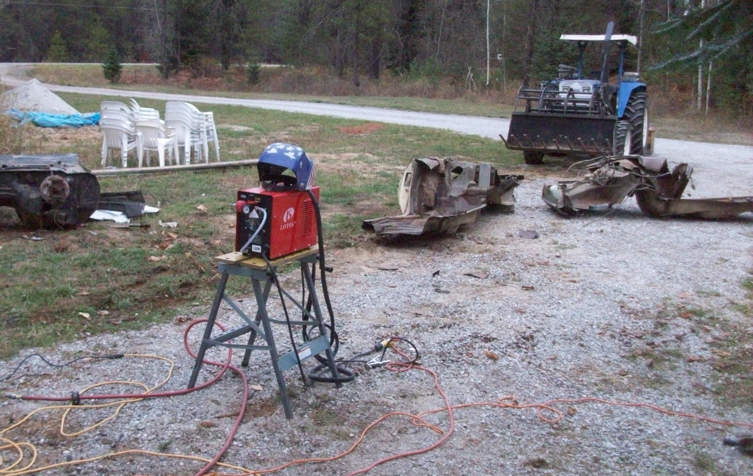

used the plasma cutter to cut the unibody apart into multiple pieces so that it could be hauled by pick up and unloaded by hand at the local metal recycler plasma cutting 019.jpg

I have used the plasma cutter a fair amount- sectioned parts of a quarter panel from a 73 firebird for my sons formula 400, it helps to have some kind of guide but the cutter has worked well. View attachment 445218
used the plasma cutter to cut the unibody apart into multiple pieces so that it could be hauled by pick up and unloaded by hand at the local metal recycler View attachment 445219
