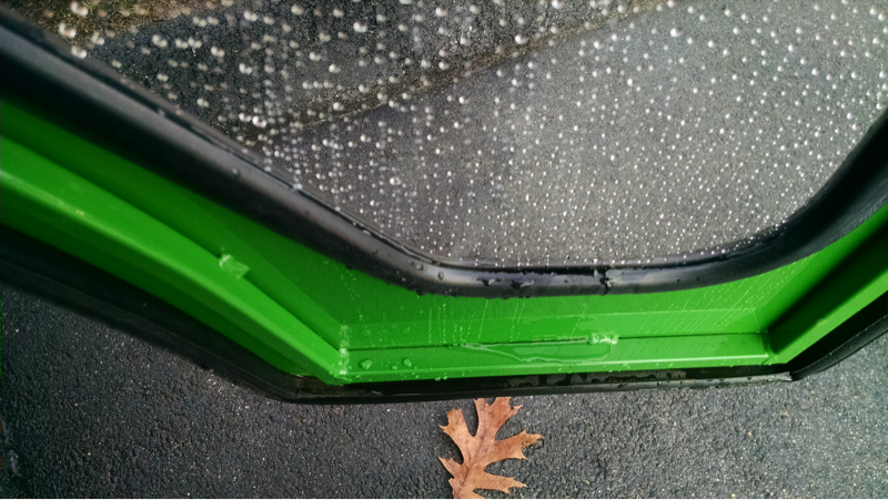

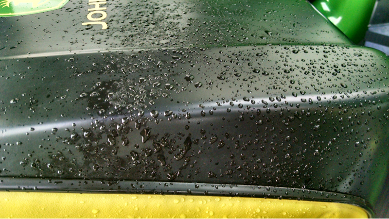

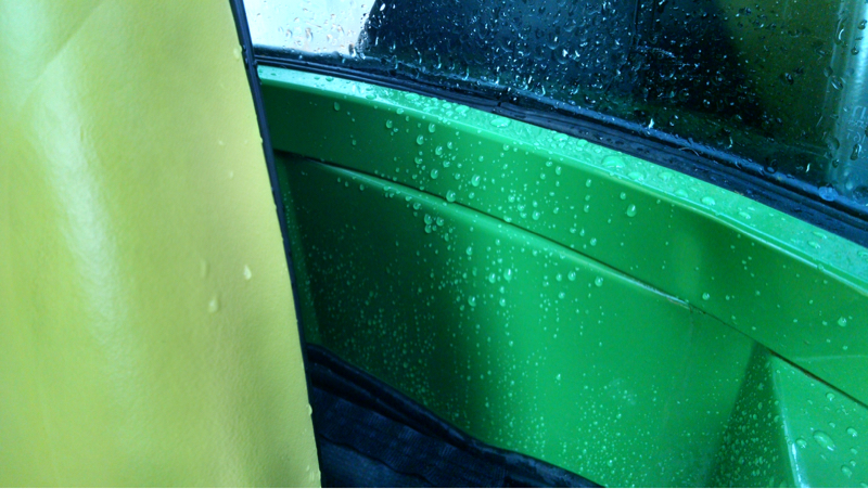

I am guessing that your JD dealership is DH marvin, who is mine as well. Wonderful dealership, wonderful people, can't say enough good things about them.
No Midstate tractor. Good guy working real hard to get it right.
New cab did not arrive so I took more pictures this morning after rain, here are a few. Not happy yet.

any update on this? I'm looking at a Curtis cab now.
The dealer took it apart and re sealed the Windows and doors it is better but still some leaks in heavy rain. Dealer did all he could can't fault him, as I was told Curtis was very difficult for the dealer. Unfortunately when tractor was ready winter was fast approaching and I know I should have just refused it after the leaks but needed it for snow and would have been up the creek as they say. I have to say if I were to do it over again I would still get the John Deere have a great dealer, but would look for another option for the cab. As a side note it is not noise insulated and very loud inside, poor rear and side visibility if you are work in a tight place. I have a 2032 R not sure how the Curtis cabs for other tractors are. I had a Curtis on an old JD 855 that was great, more room, good visibility and no leaks that is why I went with Curtis in the first place.
