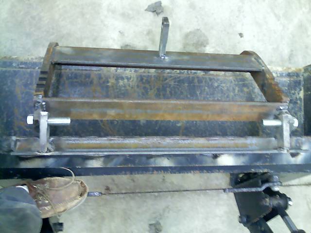

For the past two days after work, I have been working on building a low buck grapple for the fel bucket of my farmtrac 270. The main components of it are two large scarifier teeth bought at an auction for $10.00, 1 peice of 1/2x30x3x4 angle iron, 1 peice of 1/2x32x3x4 angle iron, 1 peice of 3/8x36x2x2 angle iron, and one 15 inch peice of 1x2 inch hot finish flat stock cut into 2 4 inch peices and two 3 inch peices, total for steel including cutting to sizes listed above $57.00 10 pounds of 6013 welding rod, $8.00, one 2 inch bore 6 inch stroke hyd cyl pn.992001 northern tool, $87.00 w/shipping{do not have yet, just ordered tonight]. and a 3 way hyd control valve from the hyd deck lift of a 782 cub cadet, free, 2 1 inchx5 inch grd. 5 bolts used for pivot pins, free [had in bolt drawer in garage], total so far $162.00 ., I will need an additional 10 dollars worth of steel to mount cylinder when it comes, and I have a freind who will supply me hoses for free. Here are some pics from my phone, digital camera died tonight, so this is all I have to take pics with

Lookin' good!
Keep the commentary and pics coming.
   / Low Buck grapple build #3
Mornin Ryan,
That looks like a pretty beefy grapple to me ! Lookin foward to the finished product ! :)
BTW, your deck shoes like a bit like mine ! ;)
   / Low Buck grapple build #4
Very nice. I think you have the proportions just right. Many bucket grapples have unnecessarily narrow grapples with means brush especially will spill out and not be held as securely. Your grapple is a bit more than 50% of the width of the bucket which to me looks perfect.

Yeah, I wanted a wide grapple to aid in picking up large brush piles and fallen trees around my property, I can hardly wait for the cylinder to arrive next week so that I can try it out, I am also thinking about adding some serated teeth to the front edge of bucket sides to help hang onto logs and brush, but do not know for sure if it will be needed yet, I will probably wait and see how it works first
   / Low Buck grapple build #6
I think you will find that simply trapping the log(s) in a triangle between the grapple arm and the two bucket sides will hold things steady. Serrated teeth do nothing for brush.
