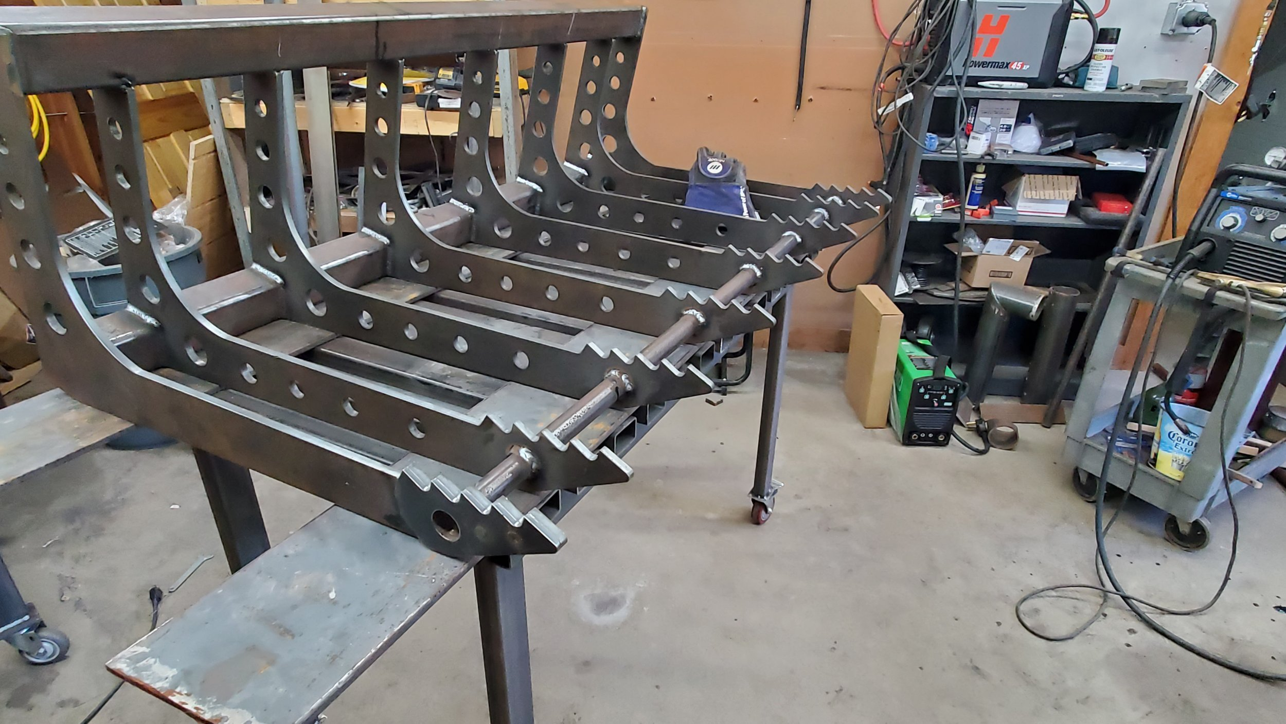

Initial layout of the lower tines-
Fit up and tack welding the lower tines. I spent a lot of time making sure these were as aligned as I could make them. I had an issue with one tine which seemed to be slightly warped. I choose to have the end tines cap the tube steel for strength and they are a slightly thicker depth than the "inner" tines which creates a different geometry.
The first fitment issue was adding the 1-1/4" rod at the lower teeth. The one tine that wasn't sitting flat was in the middle and it made it really difficult to slide the rod through. If I were to do this again I'd slightly oversize the plasma holes due to the bevel that the cutting tends to create.
The last part of the lower tine work on was the gusset teeth. I ended up cutting the back section off each one, grinding a slot, bending and welding each one back together to get the right offset I was looking for. The first two ended up being different because I wasn't exactly sure what was going to work best here.

Some additional details on the gussets. I elected the grind a slot in the front of each one, weld it and grind smooth for added strength. Despite the plug welds I was worried that eventually something would wedge in there and bend one of the teeth. I had to grind one side of the weld at the bend to make the teeth sit flat against the tine in the front.
Here's the lower section welded up and ready fit the upper lid and hinge brackets. Just about every weld on this build was full length and double sided, except some items that I didn't think needed it.

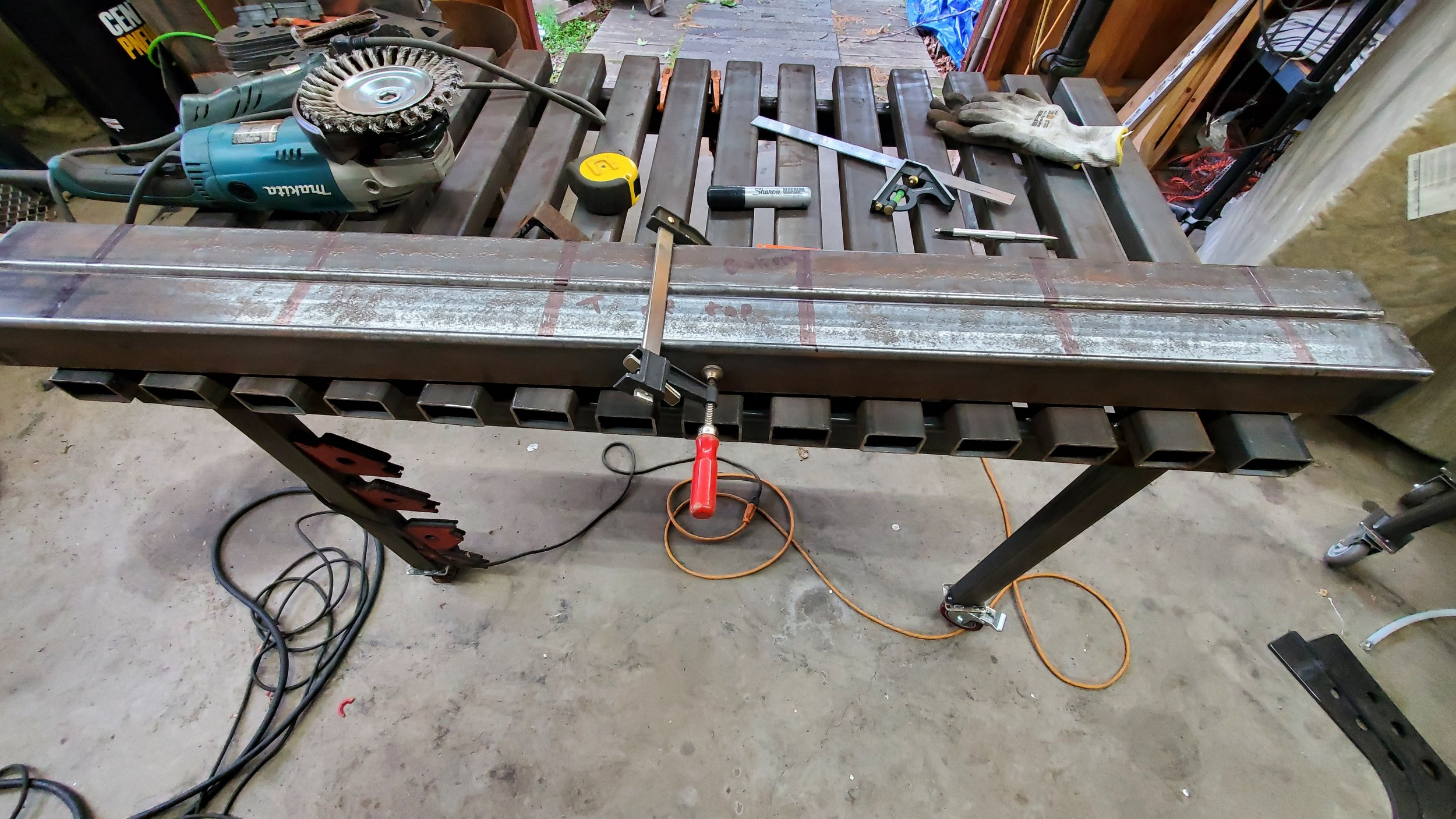

Here's one of the parts I elected to fabricate myself that really took a bunch of time. I know you can buy the SSQA, but they're typically a full plate section and I wanted to keep the grapple as light as possible while still being really stout. I spent a lot of time measuring my fork carriage and test fitting this part of the build to get it just right. I ended having to grind a lot of the welds to make sure the attachment plates sat really flat against the grapple.

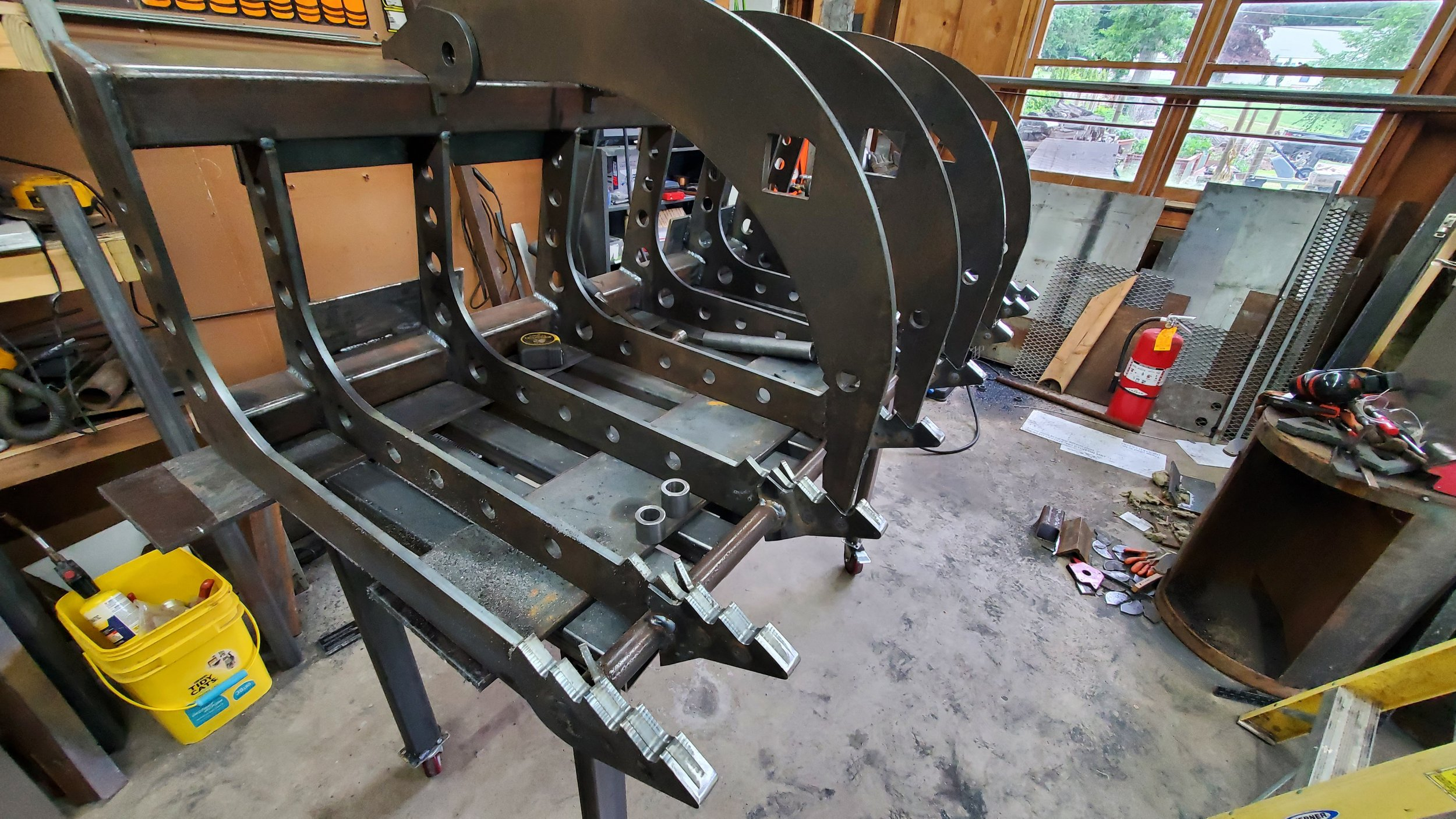

Now we get to the part that really took me the most time on the project, the upper tines. This part of the project was really about 2/3 of my total time building this attachment. It wasn't that it was difficult but I checked and recheck to make sure parts were square and aligned properly. I didn't do myself any favors by electing to use a 30" long 4140HT pin for the hinge point. I designed the hinge brackets to accommodate a 1" pin and the upper tines where cut out to accept the full 1-1/2" OD of the DOM tubing. My biggest initial issue was that the 1" pin didn't quite fit in the 1" OD of the tubing. Each had a tolerance of about .005" and somewhere it was off enough to cause an issue. Since I didn't have a lathe I decided to use a 220 grit sanding disc. It took me about an hour to get just the right fit without any binding. I do plan on polishing the pin again before it all goes back together.

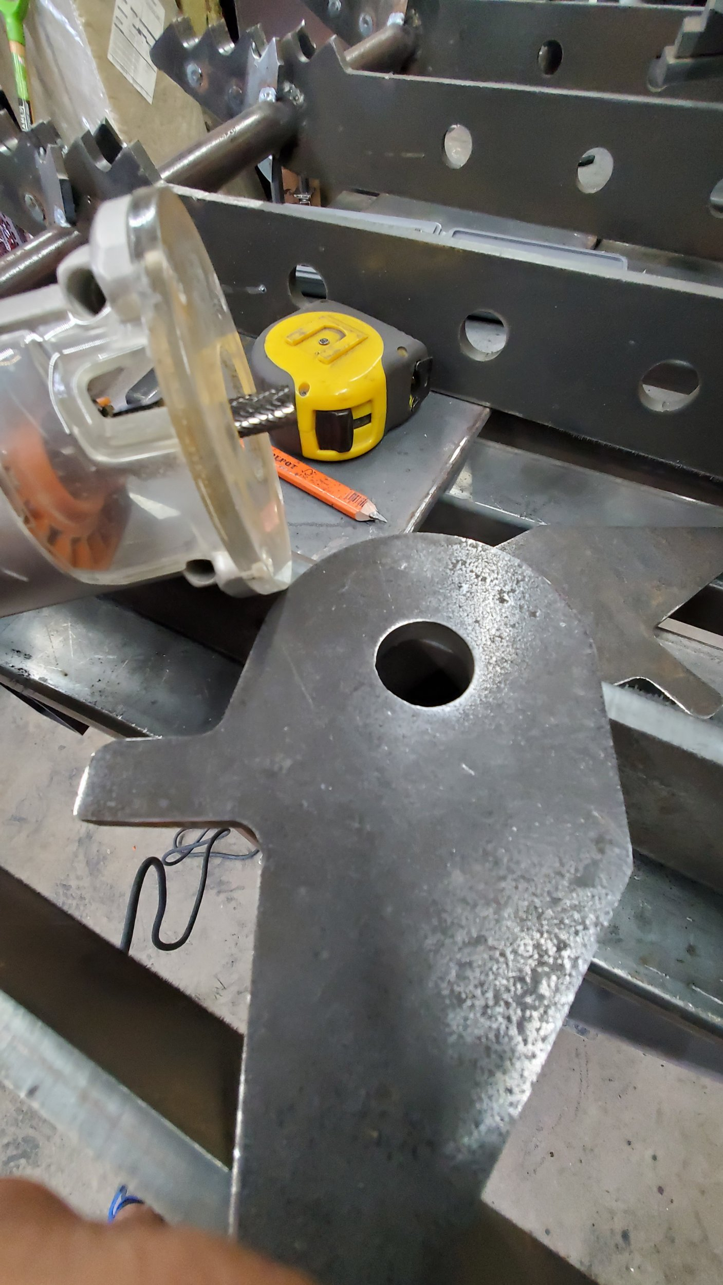

I talked about the beveled edge that sometimes can be created with the cnc plasma cuts. The holes cut in the hinge brackets had this bevel and some blowout from the piercing cut on the machine. What I ended up doing was using my hand held router with a carbide burr to take out the beveled edge. Now the holes were perpendicular to the adjacent plate surface.
After

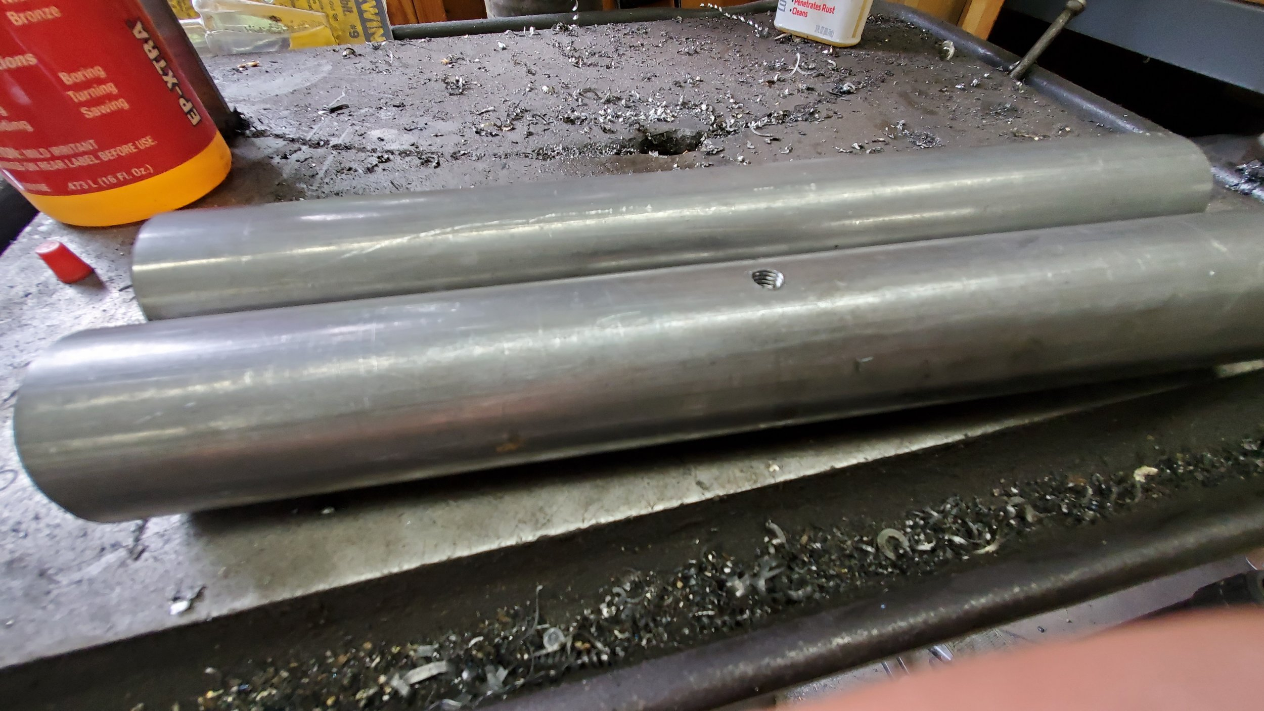

Next step was to drill and tap the tubing to accept the zerk fittings. I did make a mistake here that wasn't realized until the very end of the build.
As Smokeydog pointed out the nice part of the wicked grapple is that the tines align in the front which is what I was going for. The fact that the tubing inserted into the upper tines really helped in this step. There was only two surfaces that needed to align, the tube and the hinge brackets. What I ended up doing was setting the tines back one tooth and getting them square and gapped for paint (using wire), tacked the tubing and the brackets. I eventually slid the whole section forward and hammered the pin in to check for alignment and function.
After I know everything was correct I install the tube steel bracing that will connect the cylinder from upper to lower.

I was shooting for #350 and I think I'm pretty close to that weight, I don't think it's #400. The bottom tines I can actually move off the bench onto the ground one end at a time. The upper tines surprised me with how heavy they got despite only having four.
I wanted a beefier setup because I have the feeling that after this tractor is paid off I'm going to want something larger, the next size up

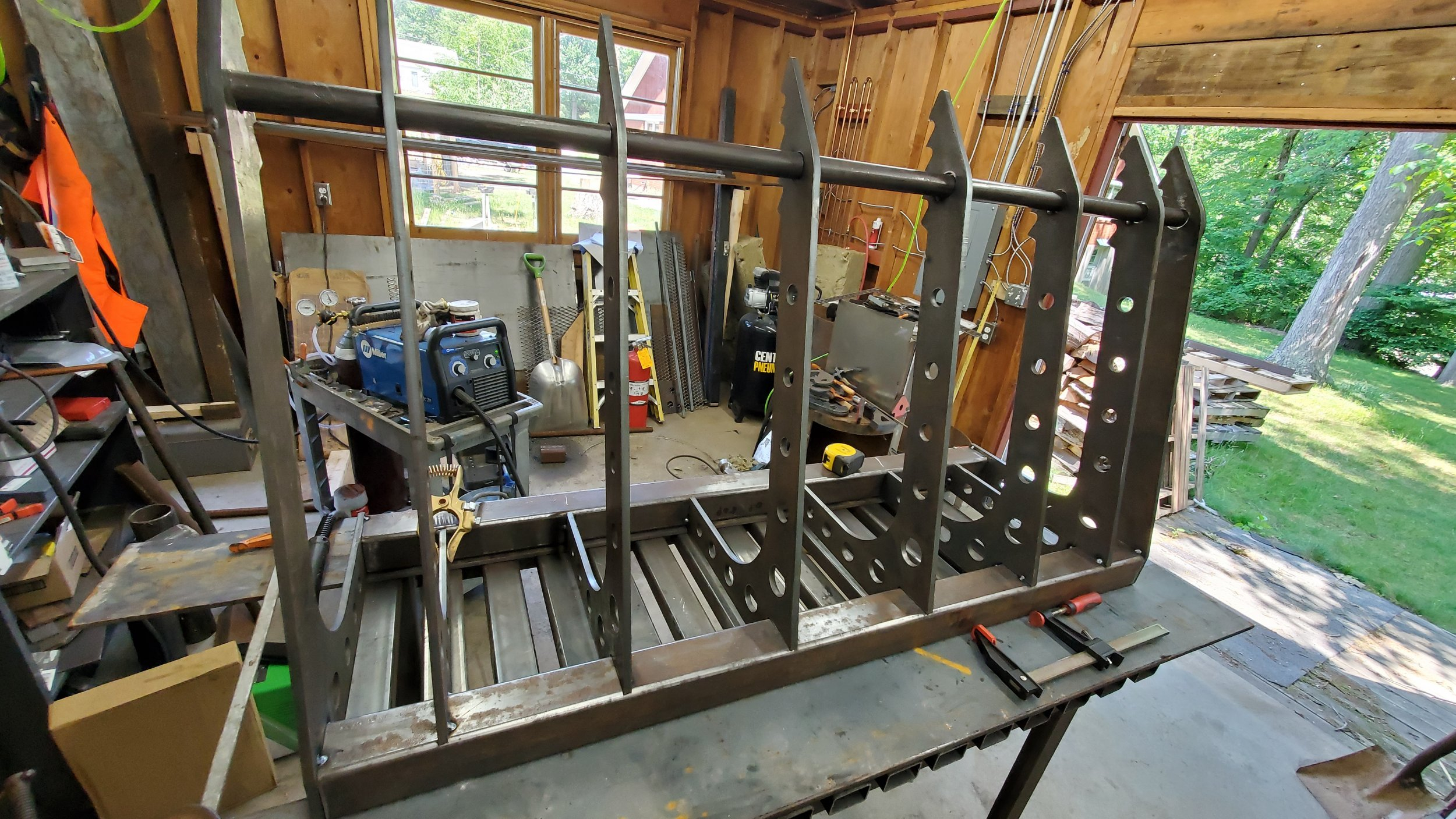

That was my next step. Surprisingly these things are sharp and hell on the hands trying to manually operate the lid. I did make a small mistake here since I was using a smaller dowel to hold the hinge point in place after I took out the 1" hinge pin. The tooth alignment left to right shifted slightly and I didn't realize it until later.
Here's the other mistake I mentioned in previous post. The left two upper tines and the right two upper tines are held together with the DOM tubing to create the hinge point. The center being stationary has a section of tube welded between two of the hinge brackets. I drilled and tapped a grease fitting right in the middle because that's what I did for all of them. For that section it puts it right in the middle of the upper cylinder mount and the cylinder. To fix this I ordered a 90 degree zerk fitting. I'm hoping this works because otherwise I'm going to have to drill and tap this in a new location while being welded in place.
Here's the upper cylinder mount with gussets added. I still have a lot of clean up on this part left to complete which will be this weekend. The cylinder brackets are definitely something I could have drawn in CAD and had them cnc cut, but I wasn't exactly sure the best way to mount it. I also wanted to make sure I had enough of an elevation change between the upper and lower mount so the cylinder would have some advantage as it extends. I ended up with 5" of height differential between the two mounting points. The bad part about this design is that I'll have to pull the pins to lube the pivot points.
After testing the clearance of the cylinder multiple times I finally settled on the location of the protection plates. I ended using a 2.5"x6" stroke cylinder.
Not a whole lot left at this point. I'll spend sometime this weekend grinding, sanding, checking for missed welds and then wash the whole thing down with acid to prep for painting. I might add some steel flat stock in the middle to protect from branches that might come through the middle towards the tractor.

Clever trick using a router to square up plasma cut holes. Used die grinder with burr many times. Have to remember that one.

Cross tube mounted cylinders are easy to drill and tap for grease fitting but requires two brackets on each end.
Might find a loader pins with end grease fittings that work?
Option of making pins or drilling bracket mounts.

I think I'm going to drill the pins and put a fitting in the end. This should be serviceable and easy enough to do.
