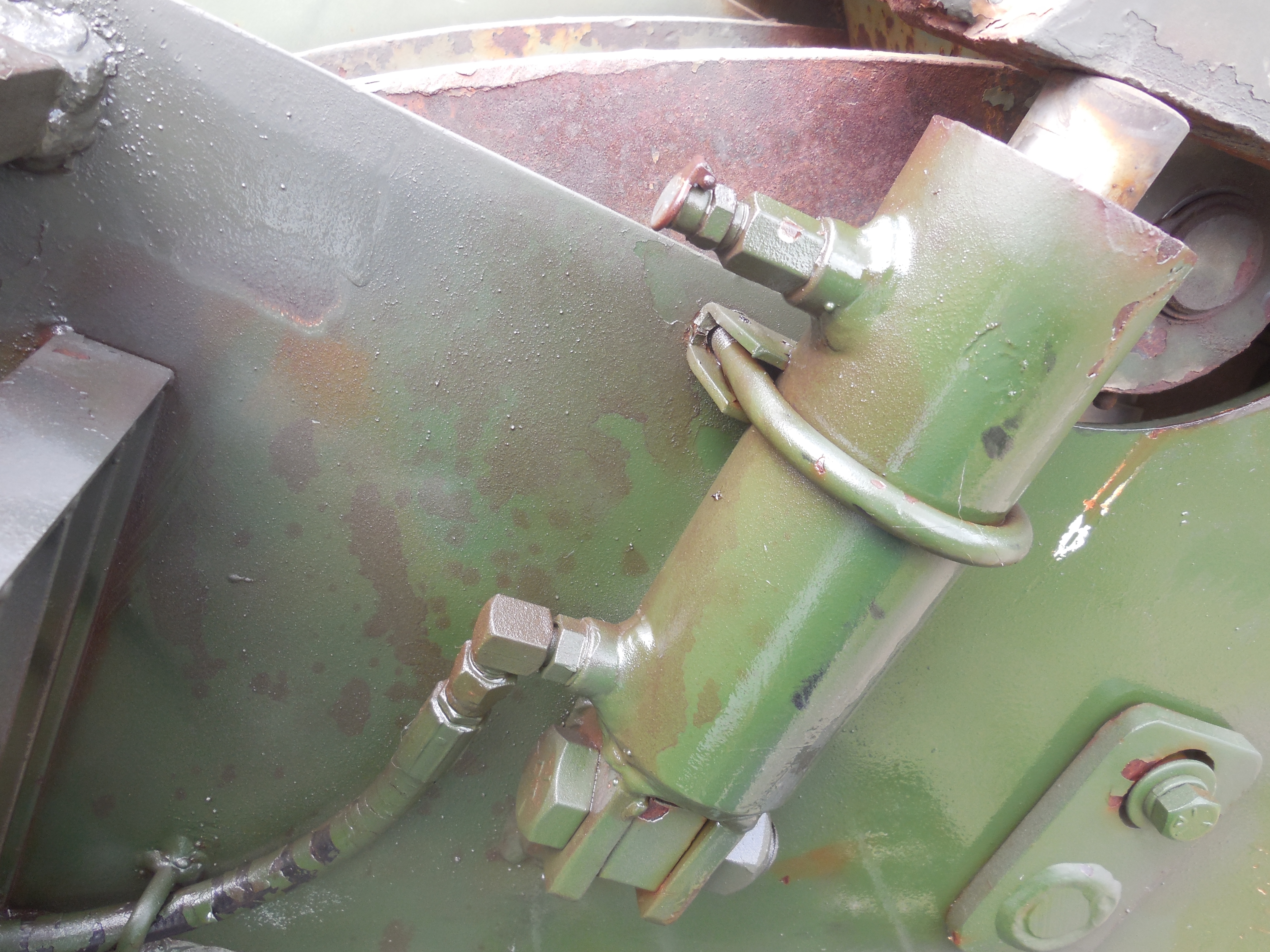

Speaking of leaks, has anyone seen a cylinder with only one hose and the other end with a mini flapper on it?
Well, it was more of a very enthusiastic spritz than a leak, but anyway.
   / Low hour used tractors #29
Well, it was more of a very enthusiastic spritz than a leak, but anyway.View attachment 3540044
That's a double acting cylinder being used as single acting. Usually the non used port gets a breather, instead of an oil cup meant, well, to oil things.
If it's leaking from there, you have bad piston seals in that cylinder.
Sometimes they also route that port straight to the tank using low pressure hose. This way there is no moisture that can possibly get in there and any leaks go straight to tank.
