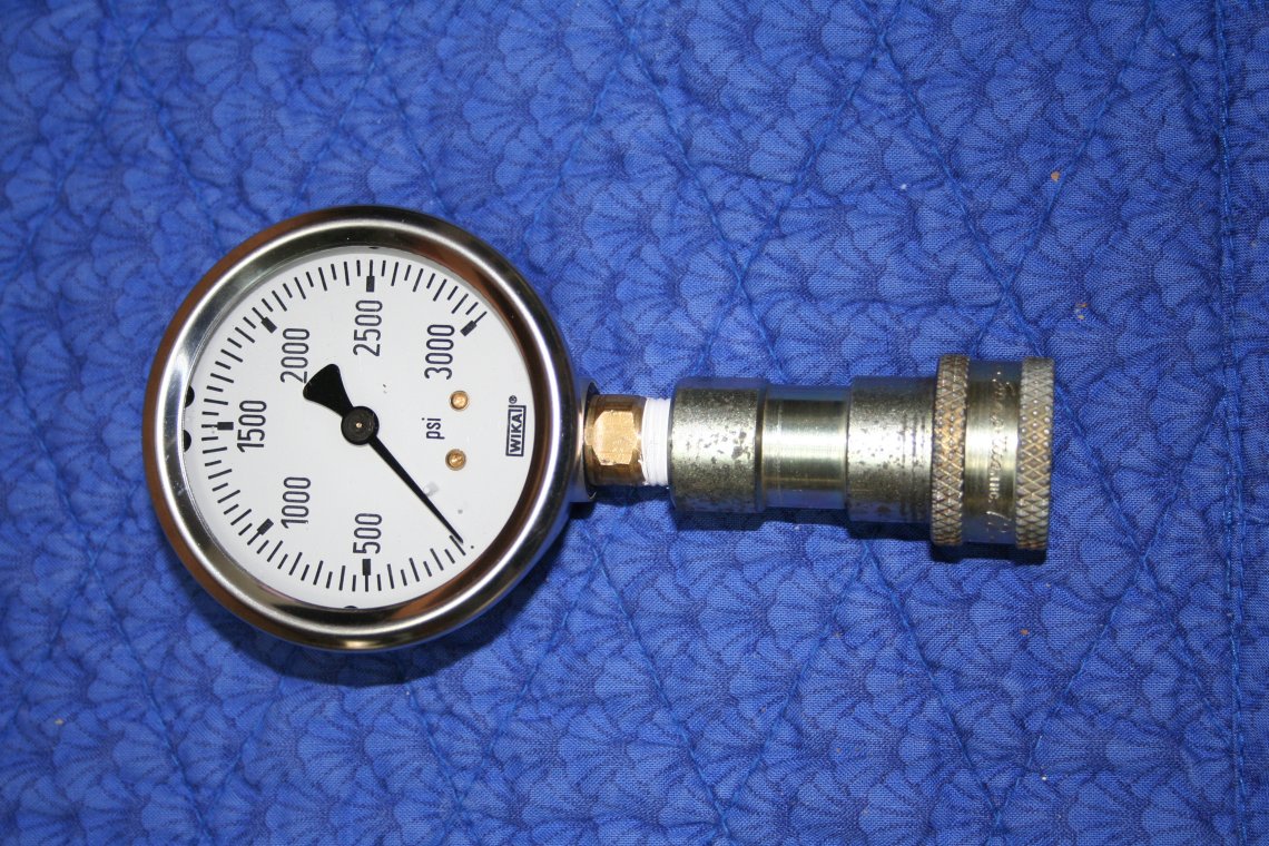

About pressure gages.
If the circuits have QD's, then you make up a 3000 psi hyd pressure test set like these two. The gages are only about $15.
If you have a single pump system, then you can mount a pressure gage on the FEL valve IN port so you can see it and monitor the hyd system.
By knowing the flow rate and pressures in your hyd system you can do some logical trouble shooting.
