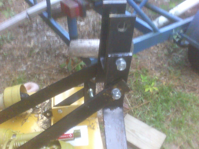

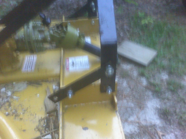

txkevin said:
When you get a chance, can you snap a few pictures of your alteration? Due to limited experience with implements in general, I would be very hesitant to alter anything and pictures would really help.
Here ya go- sorry about the poor quality.
First pic you can see how I redrilled the bottom brace to allow for the lowered vertical parts...second pic shows the redrilled and cut off braces that go back to the rear where the whell fram mounts. The vertical parts just had 4.5 inches cut off the bottom and the mounting holes at the ends redrilled.
