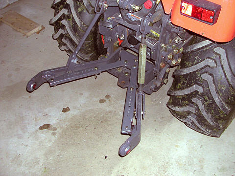

looking for some info on a dealer that has good prices on kubota parts , they came out with adjustable lower links, saw them on the new models . my m4900 is the 2000 year and would like to upgrade to the new style, as to help hook up the implements ,looks so much better and easy anybody know a good place to buy thanks kully

If the price is anywhere similar to what they cost on my B2910 (I was thinking of retrofitting them on my BX somehow) you best be sitting down when you look at the cost... /forums/images/graemlins/shocked.gif /forums/images/graemlins/frown.gif

Don't remember what tractor model that mine were for, but mine cost about $60.00.... This was in October 03. I got the part numbers from a post in this forum. These work great on the BX22 and I remember doing a short picture essay as to the cutting and modifications that are necessary.
6C070-65320 - $15.02@
6C070-65333 - $15.02@

did not get exact price because to many items for local dealer to look up at the time ,but the lift arms were $200.00 each not counting all the telescope parts ,he said quick guess was around 600 to 700 dollars ,so I would like to get a few prices just to check . he is not allways the best price around, most of the time he is the highest .my problem is that I run cat 1 and 2 implements , and cat 1 is 27 in. wide and cat 2 is 32in wide so quick hitch {speedco} will not help. there are not adjustable so I hope these telescope links will help. unless somebody has a different idea

Looking at that photo wouldnt it be fairly simple to make those? Not that the 60 bucks is outrageous.
Some time on the drill press but should be farly straight forward I would think. Or am I just missing it completly ? Maybe adding a heim joint on the tractor end for the angle ? Just thinking out loud
   / lower links telescope #8
There is more to it than that which appears in the picture. One piece is a tube type channel, so it is more than drilling a few holes.
   / lower links telescope #9
</font><font color="blue" class="small">( There is more to it than that which appears in the picture. One piece is a tube type channel, so it is more than drilling a few holes. )</font>
Yea, I did see that, what I was thinking after the fact is if switching between cat 1 and 2 items wouldnt those be the same width respectively. So you would need one set of holes for cat 1 and an other for cat 2 or do makers very the widths? I don't know enough to know you know /forums/images/graemlins/tongue.gif I am still trying to get over the foam filled tires /forums/images/graemlins/smile.gif
   / lower links telescope #10
I believe the original poster was talking about extendable lower link arms (the main lower link arms themselves can be extended out a few inches to make it easier to hook up implements)
