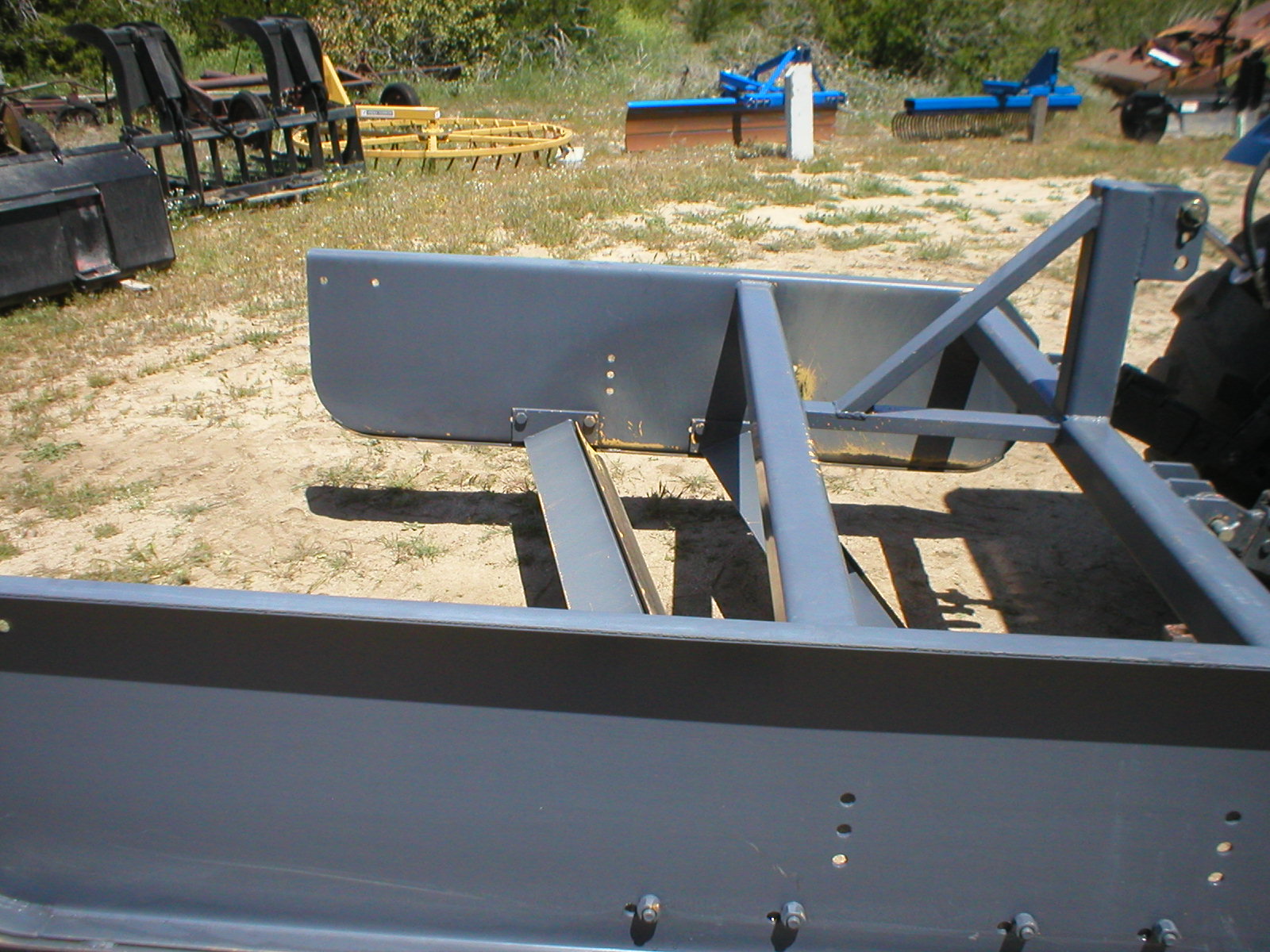

I don't know if anyone has ever come up with an optimum cutting edge spread. :confused3: On my bigger LPGS, (7' runners) the cutting edges are 22" apart, there is room to move the back one back, I want to put it so there is a 30" spread between edges and see what and if it actually makes a difference. My thinking is that it will, I just need to find the time to do it along with everything else. :sigh:
