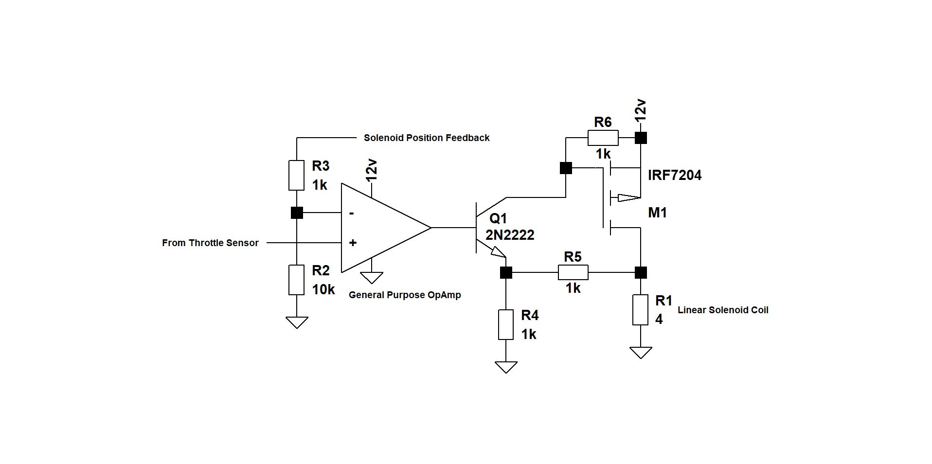

We have a WM 33. The burner was replaced by the dealer under warranty. After about 100 more engine hours, it won't regen. An independent diesel mechanic said, the high heat eventually kills one or more parts in the burner. I believe there is a way to get around the ECU emission functions. The service manual shows that the ECU controls the Engine Main Relay and Fuel Pump Relay. These can be controlled independently of the ECU with two MOSFETs and a bit of rewiring. These engines have a hybrid injection system. The injector block runs on an engine cam just like the Kubota 2501 or older tractors with mechanic fuel injection. The WM33 and similar do not have direct mechanical throttle control, but instead a linear solenoid with position feedback. The throttle input control to the ECU is a variable resistance and this gives an output voltage of about 0.5V to 3.75V. The ECU then uses a voltage/current to control the linear solenoid, which controls the mechanical input to the injector block. If this function bypasses the ECU, then the engine cannot be shut off or have power reduced by the ECU. I believe the circuit to bypass this function of the ECU requires some inexpensive parts; a MOSFET, a small signal bipolar transistor, an operational amp, some resistors, and a small circuit board. The MOSFET will dissipate about 10 watts worst case so it needs to be mounted to the frame of the tractor to dissipate heat. Of course, the DPF needs to be drilled out, which is very easy once you get it off the tractor. A mechanic told me that the DOC would probably eventually stop up and would need to be drilled out or removed. Another option is to remove the large DPF/DOC and replace it with a short piece of pipe.

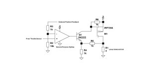

The WM33/37 has a mechanical injection pump, but instead of mechanical linkage to the throttle control lever, they use a variable resistor/voltage to the ECU and the ECU controls a linear solenoid with position feedback to meter the fuel and control RPM. A simple circuit should allow bypassing this function of the ECU. Attached is a concept circuit that simulates, but has not been built/tested:
