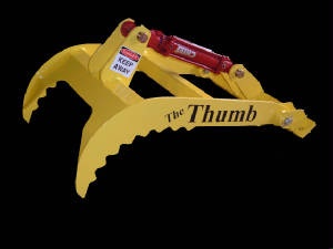

Just have to save up again to order the thumb. I'll probably have to call them since I haven't seen the one I want advertised in over 3 weeks. It'll take time but I'll get it.
   / ls 4047 grapple #24
I have my eye on that too, looks like a well-built & reasonably priced unit and very adaptable for many uses.
I would like to know what the travel is on the 36" is. I would like to mount the 36" on my 48" forks.
   / ls 4047 grapple #25
I'd like to know the travel also. It will be pretty much the same on any of his thumbs since they all use the same cylinder. Only problem I see is the cyl. only has a 6" stroke. I haven't found a video of one installed on anything yet. I'm sure it will close down on the bucket but unsure how far between the forks it will go with only a 6" stroke. I'd hate to buy one only to have to replace the cyl. with a longer stroke one and maybe relocate the mounting hole locations.
   / ls 4047 grapple #26
I suppose if it didn't close down far enough I could weld some extension "teeth" on the end of it. When it is retracted I want it mounted vertical so it is out of the way for picking up pallets.
   / ls 4047 grapple #27

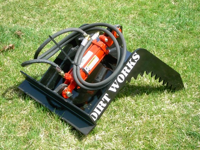

Here's another one I found that looks well built. It's about $675. incl shipping. It also uses a 6" stroke cyl. but a larger dia piston and the tines are 1/2" thick.

That one looks almost too heavy for what I need, I don't know, maybe not! :) :confused3:
