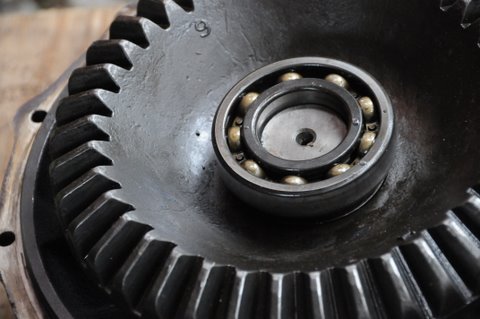

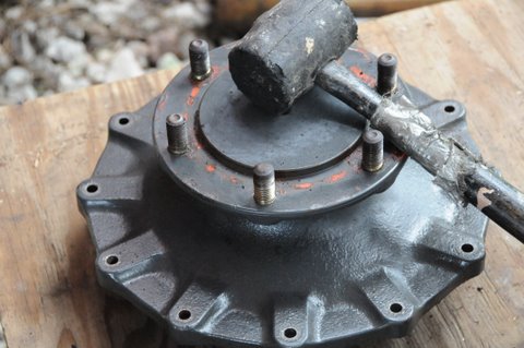

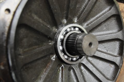

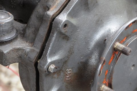

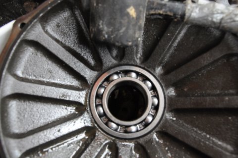

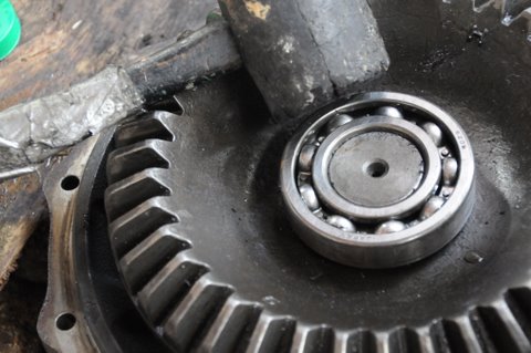

The old keeper was sprung just enough to keep large gear from going onto shaft completely. New keepers and it slipped right on. I then tapped the new inner bearing I picked up at the dealer on spline and tapped it on with rubber hammer. Slipped whole unit together tightened it up added about 6 quarts of fluid until it was weeping out plug hole.

FYI the bearings and keepers were about 1/2 price than what I got online. Bearing was $16.00. A 3" schedule 40 pvc was perfect to tap on bearings and remove old one.
