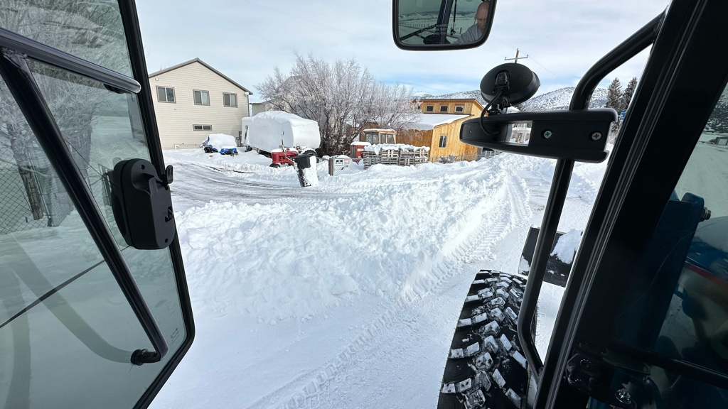

My MT573 did this at 8 hours on the clock. Lost the dipstick in the snow.
That day was moving drifted snow with the bucket in 30 deg F temps. No wind.
Took over a month to get a replacement dipstick. Hope to find lost dipstick this spring
