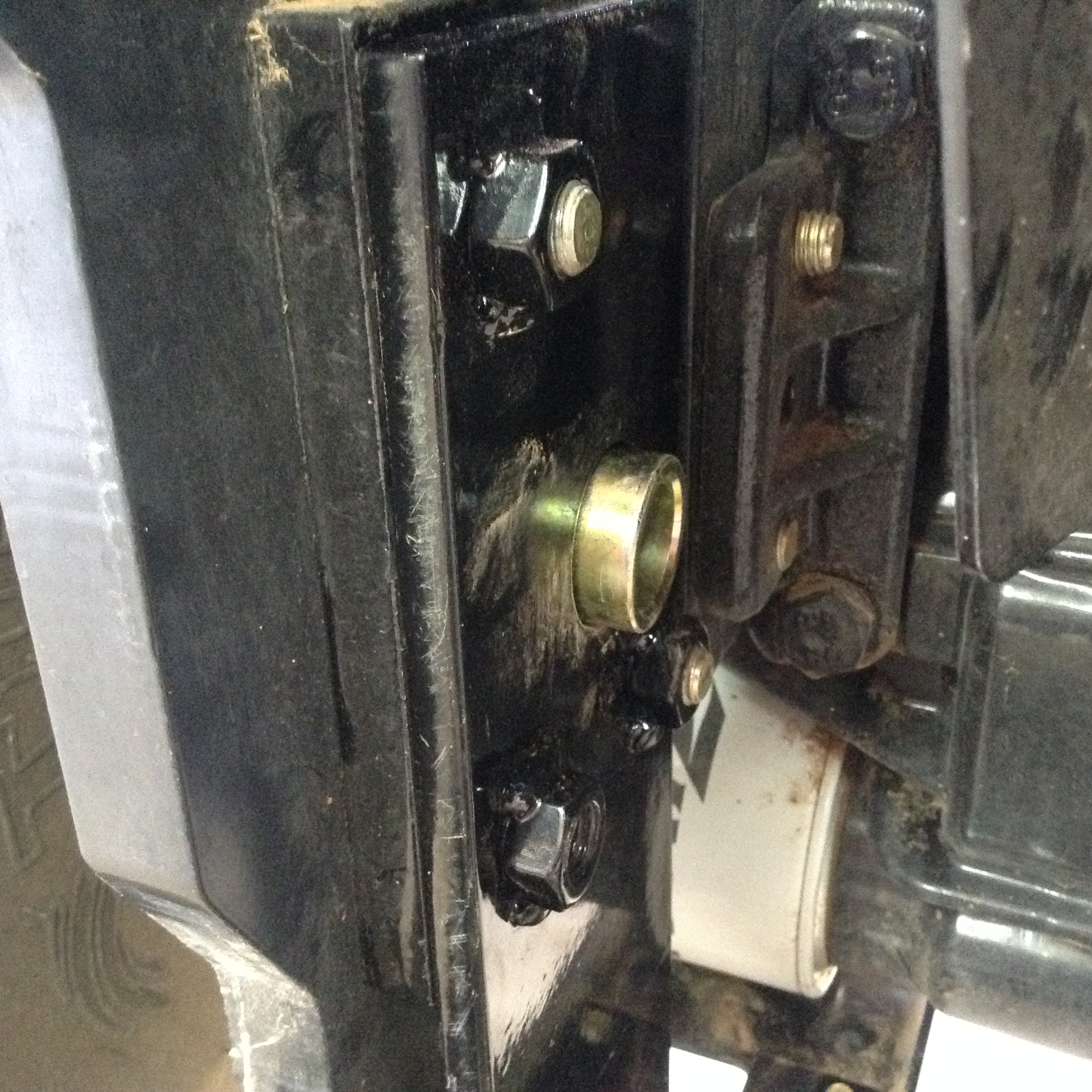

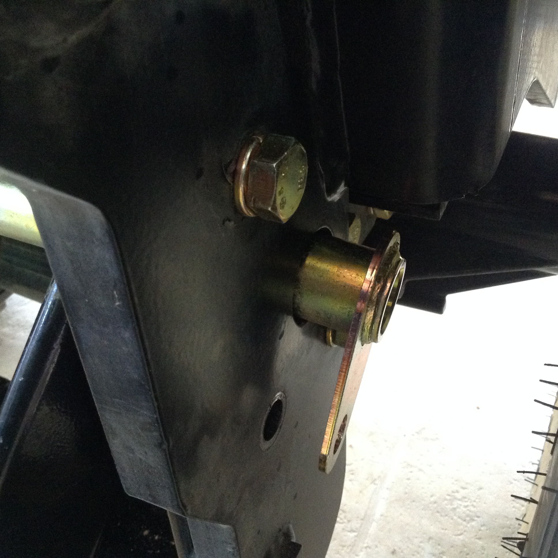

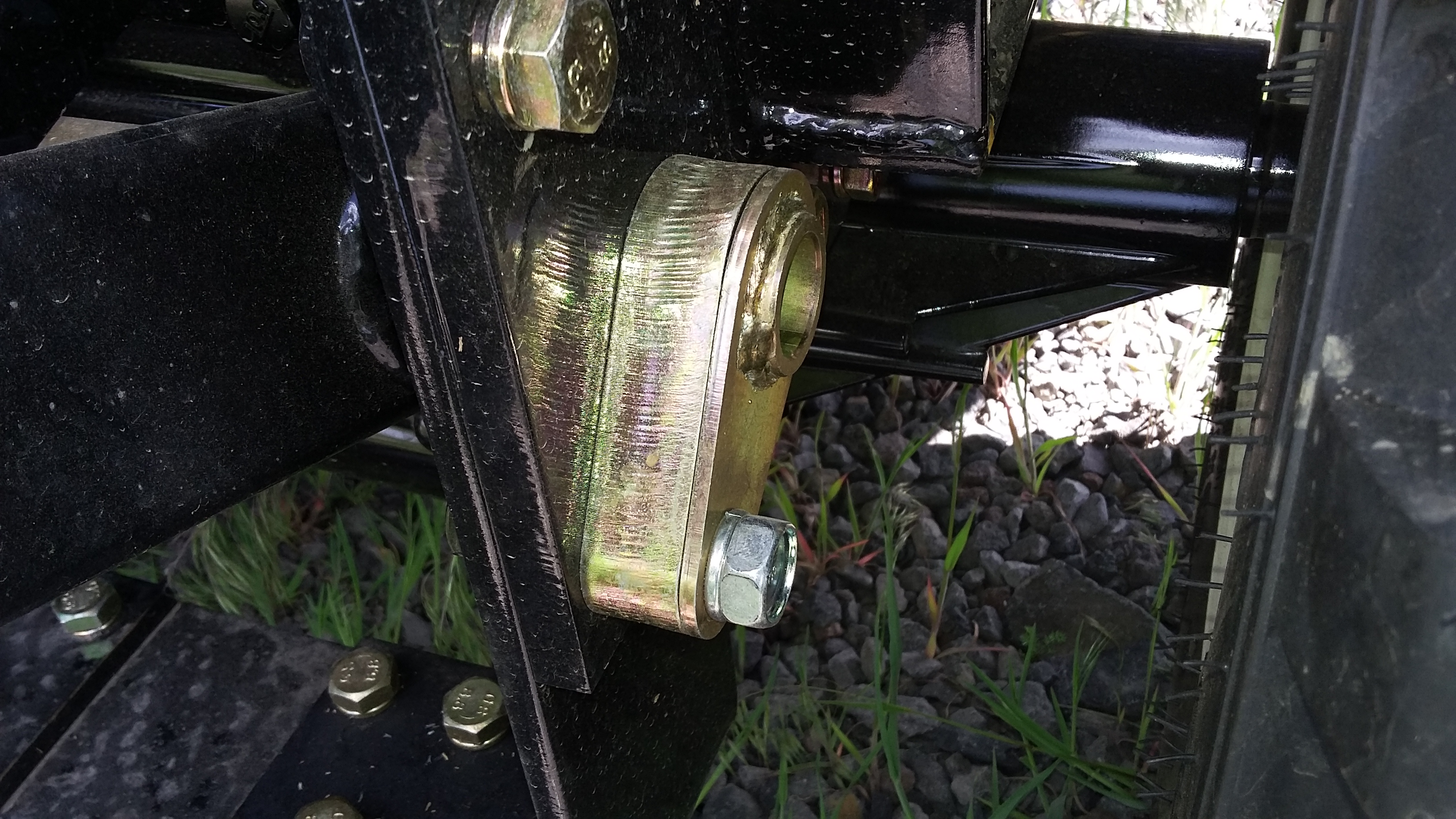

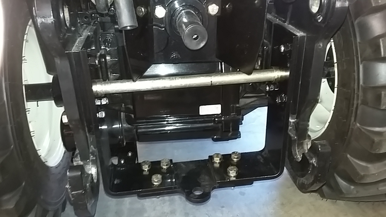

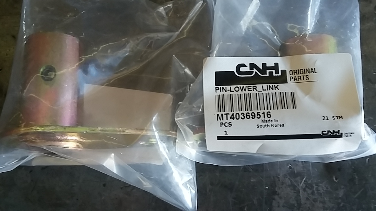

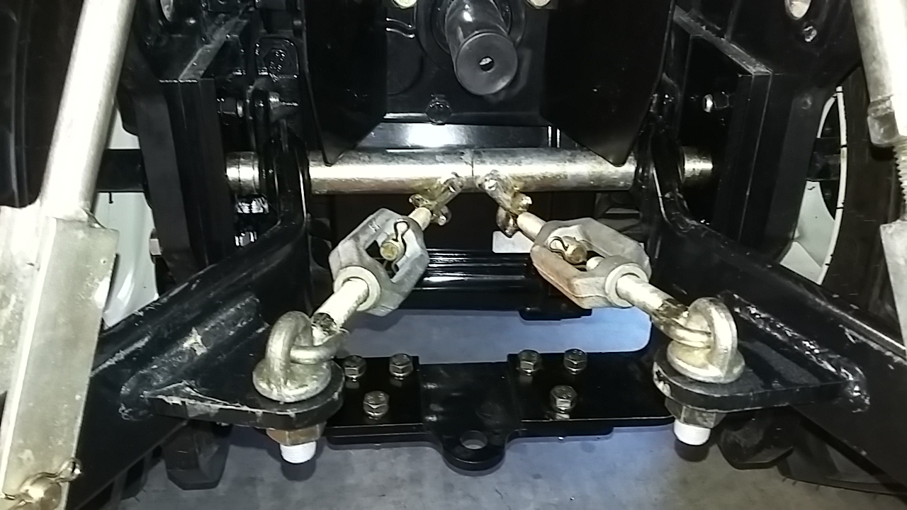

Well "LSmt125owner" this subject just gets more interesting. My local big New Holland Dealer just got in a nice selection of the "New Holland" Workmaster 25S and extremely interesting to look over. The original LS MT125 is truly the factor special as the trim package is much nicer on our tractors but they are truly identical with the Workmaster 25S! They had one there with the backhoe on it like my tractor and they also had a couple of the tractors that were NOT setup for the backhoe. But here is where it gets interesting............ They had their 3 point hitches mounted up and the "NEW" hitch mount was factory installed and I could see all the parts mounted up and in place. The bottom line is all I need to do to install this on my tractor is buy the two "pins" #40369516 and cut my original long bar that we have to take a tire off and install and I'm almost home free. I need to take the lower hitch brackets off and cut the outside welds to slip out the bushings that LS put in there. What I find interesting about his is they had to INSTALL those bushings and weld them in place to make that lousy design work. So for a total of $38 and my friends milling machine to cut the bushings and welds out of the way I can modify what I have to the new design.
Here are some pictures of what I saw today.
If you look closely you will see the "spacer" that we with backhoe's don't need. Also "LS mt125owner" could you measure and give us the length of your new pin so I don't have to cut and fit? In my opinion for $38 and a little work I can have the completely new redesigned hitch.
Gotta love our LS tractors.
Lisa

Yes, it's a pretty neat set up when installed. Takes me under 2 minutes to tack off the whole assembly. Your idea is absolutely correct... Get the "pins", drill out the sleeves, and cut the shaft...your good to go. I went out and measured the shaft. It is exactly 13 1/2" long.:D

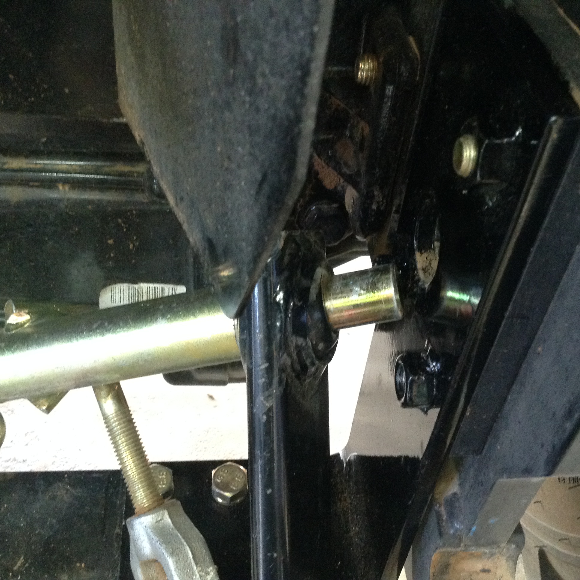

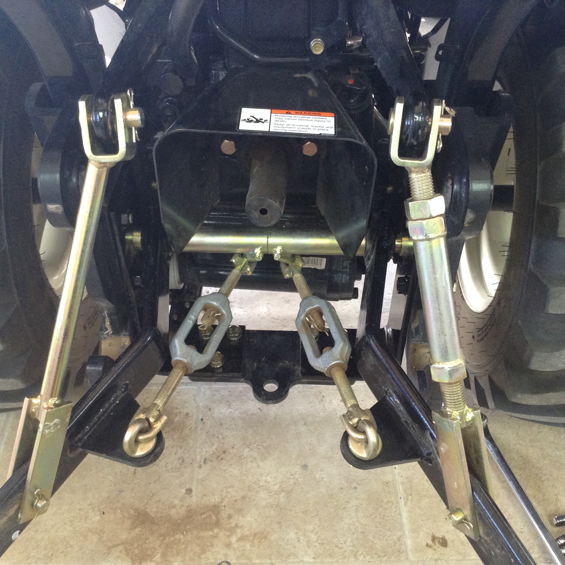

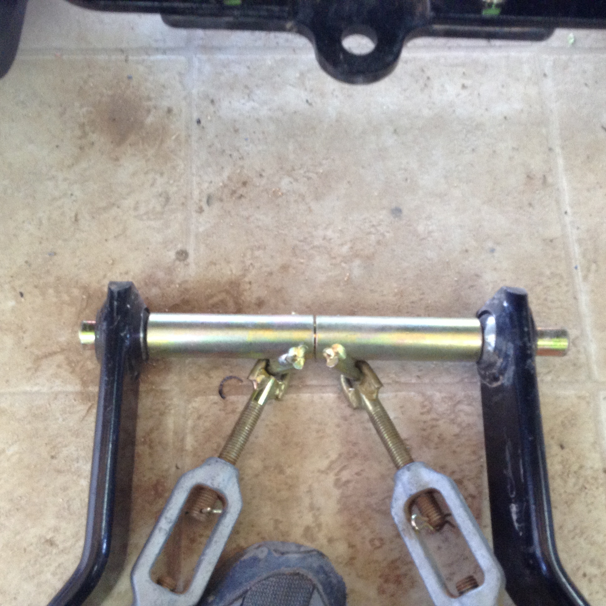

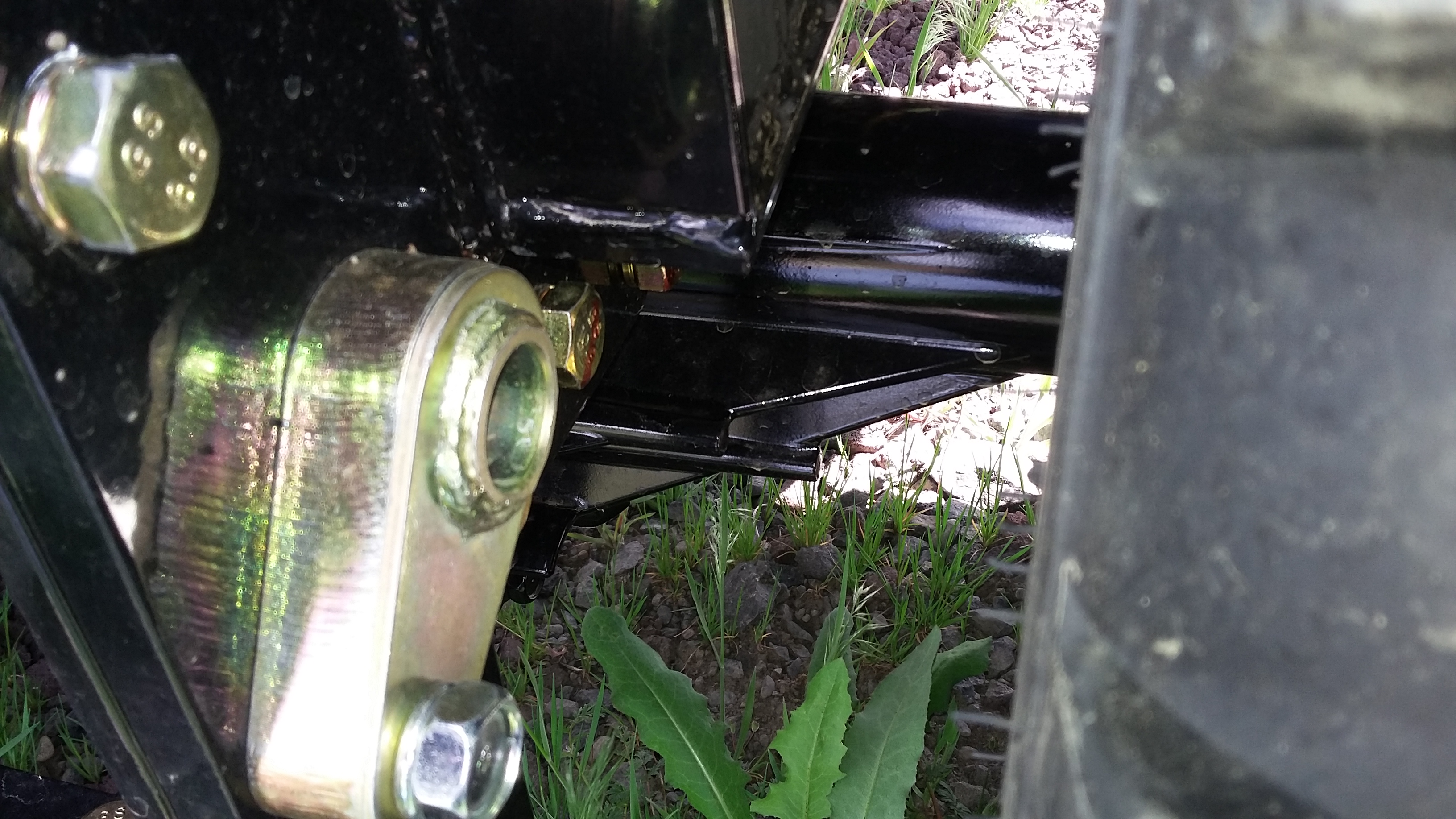

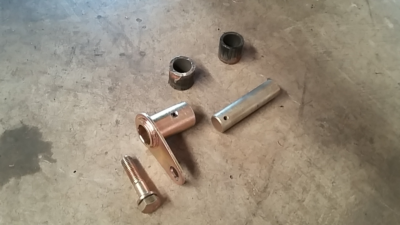

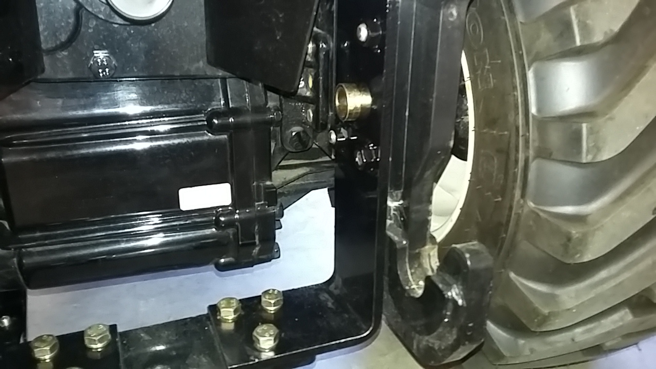

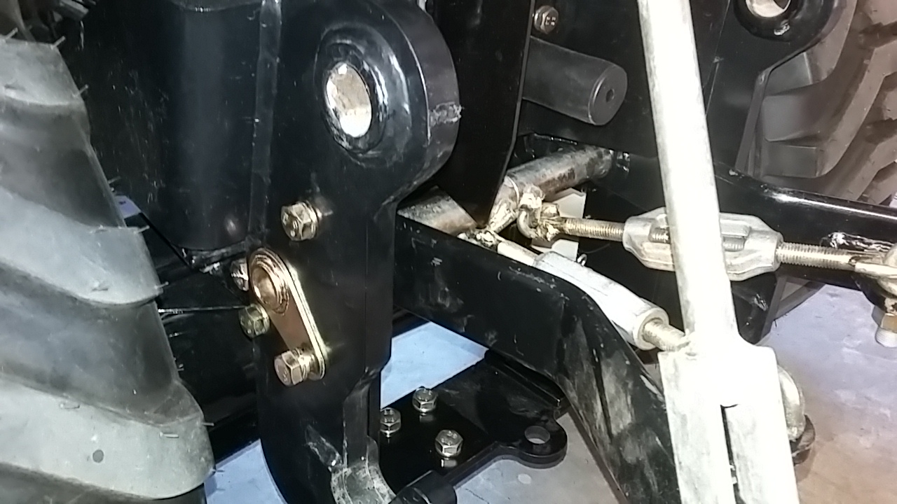

Well today I finished the upgrade to the new LS factory configuration. This was really easy to do as first I ordered from my local dealer 2 number 40369516 "Pin-Lower Kink"s and together they were $30 total. Not bad for factory parts. Next I removed my backhoe and then the three long bolts on each side and then the three bolts on the actual draw bar assembly on the horizontal brackets. Then I took my grinder and cut the welds that secured the bushing LS installed in the side brackets. I painted these brackets to cover my grinder marks and reinstalled them after pushing out the old bushings with my press. Next I cut the draw bar long pin to 13 1/2" in length. In the last picture of this set I show the two bushings I cut out, the short piece of the draw bar pin that I cut off and then one of the two new "pin-lower link" that I installed left and right. Now to remove or install the three point I remove one bolt that retains one of the "Pin-Lower Link"s and remove this part and the main draw bar pin can be removed without removing a tire. Fabulous upgrade that took a total of one hour, $30 in parts and some black spray paint. Exceptional factory fix to a really poor original design. :):thumbsup:
Hope my pictures help you seee what I did.
Best regards,
Lisa

Awesome job! :drink: And a whole lot cheaper too than buying "the kit". :thumbsup: Not to mention the fun working and fabricating! :D

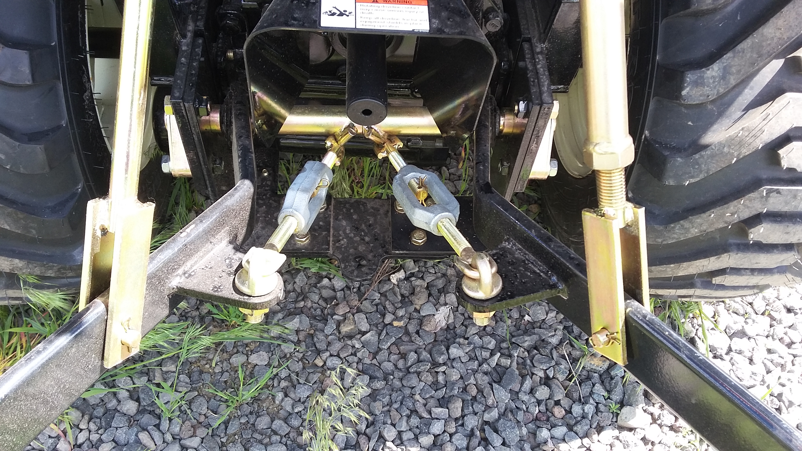

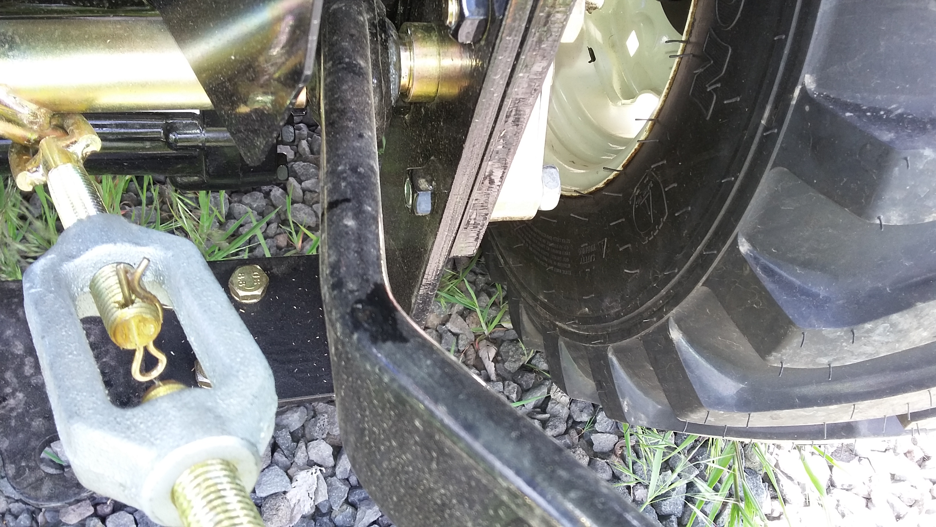

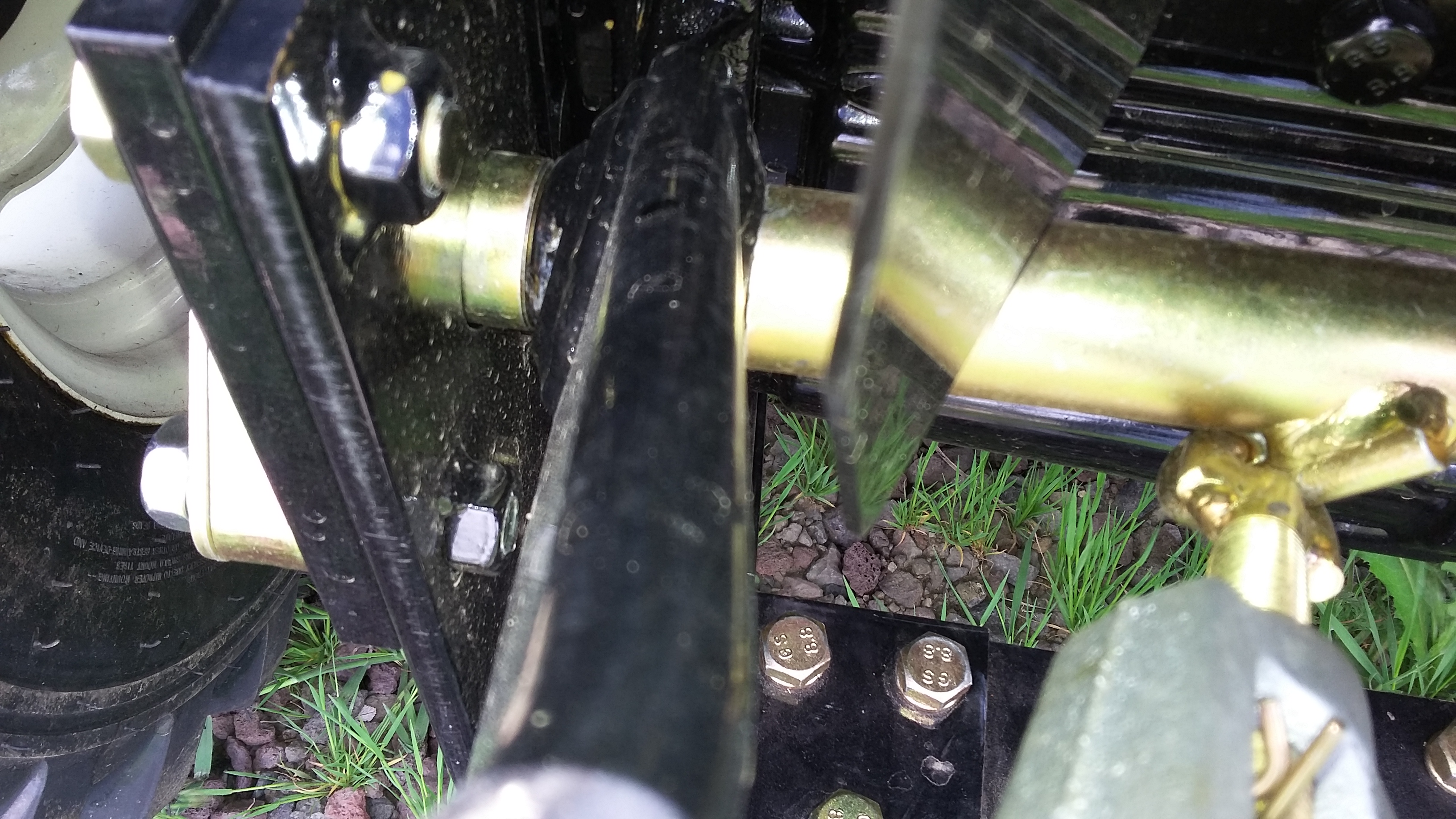

looking at some of Tony's videos for reference. Are you able to remove the pins for the side links and bring arms straight up. maybe use a bungee to hold them up along with the side links?
/ LS mt125 3 point "update" #39
/ LS mt125 3 point "update" #40

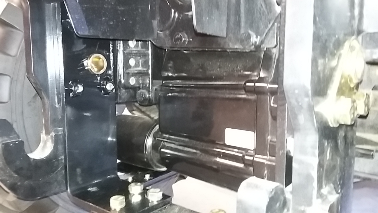

looks like it could be possible. You will want to remove the pins from the lower lift arms at the bottom leaving the side links hanging on the upper lift arms. then bringing the lower arms up. However, you might need to remove the PTO shield...
That's what I was just looking at. The turnbuckles hit the PTO shield keeping the arms from fully clearing. Being under a fresh warranty, I'm not sure I want to get into safety features. Thought crossed my mind though to notch the shield for clearance for those turnbuckles.
Question remains, will they interfere with leg room when the seat is turned around?
