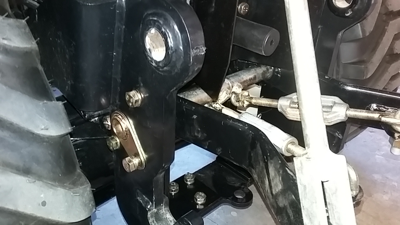

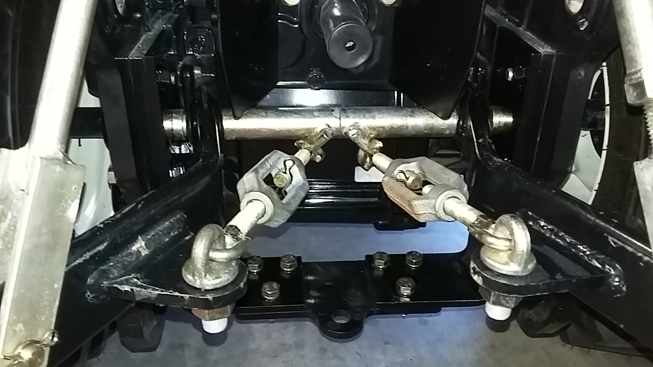

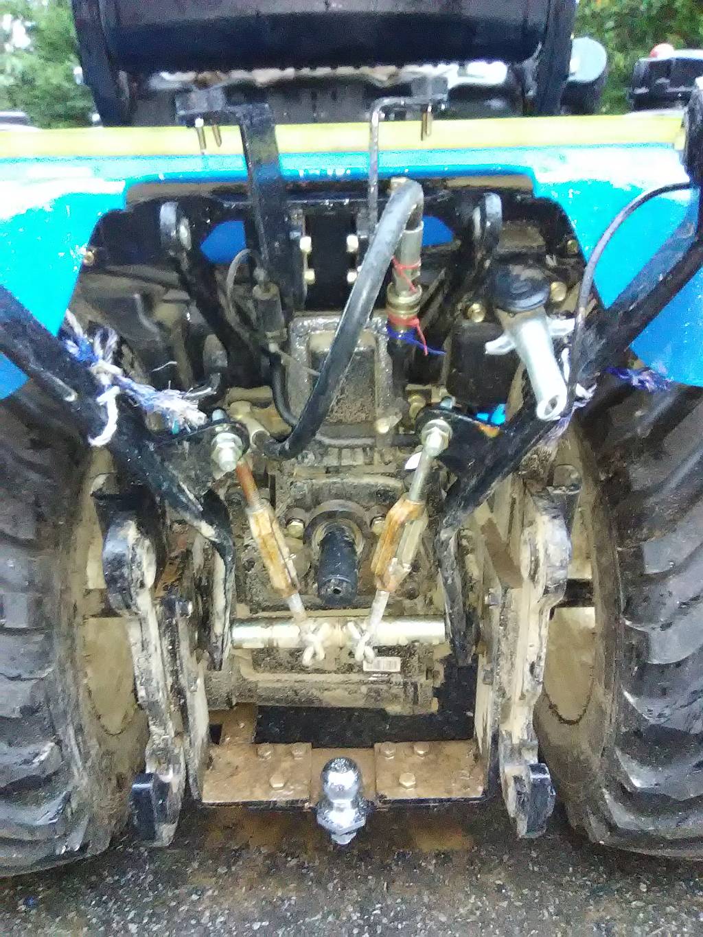

That's what I was just looking at. The turnbuckles hit the PTO shield keeping the arms from fully clearing. Being under a fresh warranty, I'm not sure I want to get into safety features. Thought crossed my mind though to notch the shield for clearance for those turnbuckles.
Question remains, will they interfere with leg room when the seat is turned around?
just take the shield off and store it on a shelf. its what i did because I was having issues getting some of my older shafts to connect...

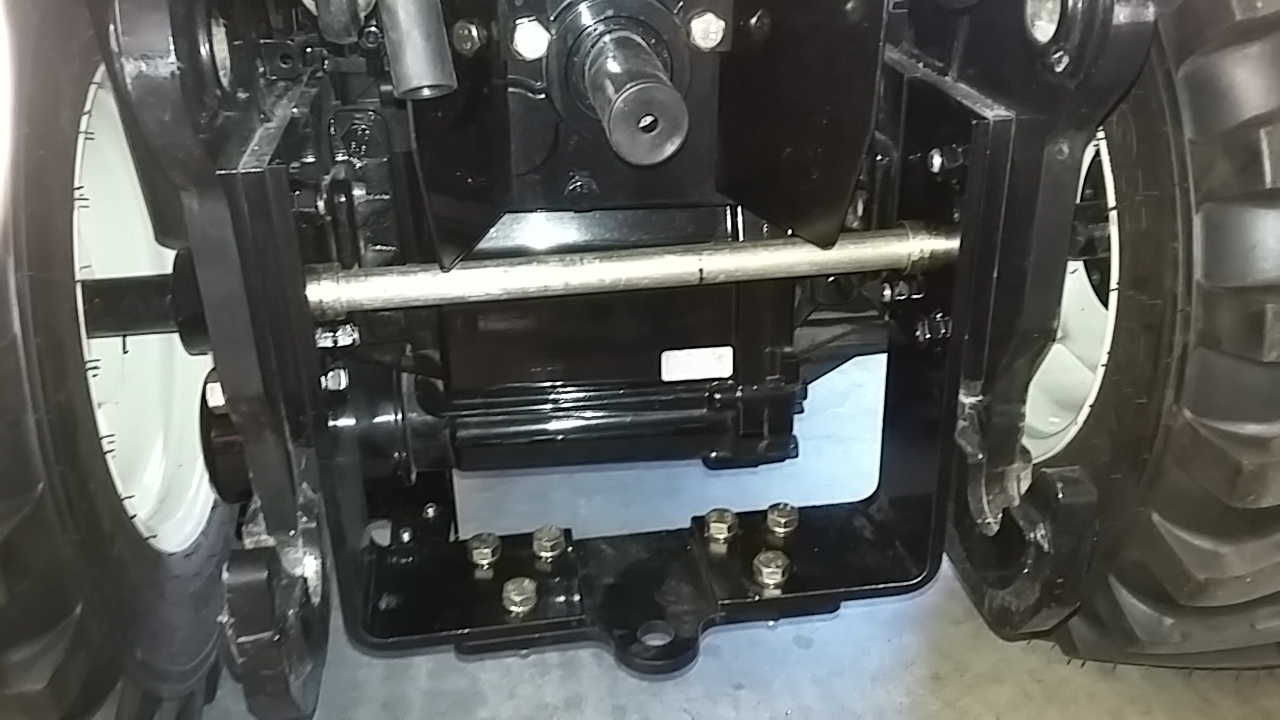

The initial issue discussed in this thread was the easy removal and installation of the 3point hitch components (or difficulty to actually do so). The early MT125's that were sold (early 2017) had an issue on tractors that had the backhoes. You had to take off a rear wheel in order to slide a large rod through the frame, through the 3 point lower link, then through the 3 point stabilizer tubes. If you wanted the BH back on, you had to reverse the process. A lot of work if you switched frequently between the BH and other attachments. This thread was about the "fix" that LS designed. For the early 2017 owners, this "kit" was available to correct the aforementioned problem. The kit made it possible to remove or install the 3 point components in about 3-5 minutes.
All of the late 2017 tractors and, of course, the 2018's come with this new design. No need to order anything.

Well, I just got mine and it has the problem, but I don't know when it was manufactured.
I'll be looking at pulling the PTO shield which make it kind of difficult to connect the PTO to begin with. That may solve two problems as long as it doesn't create a safety issue.

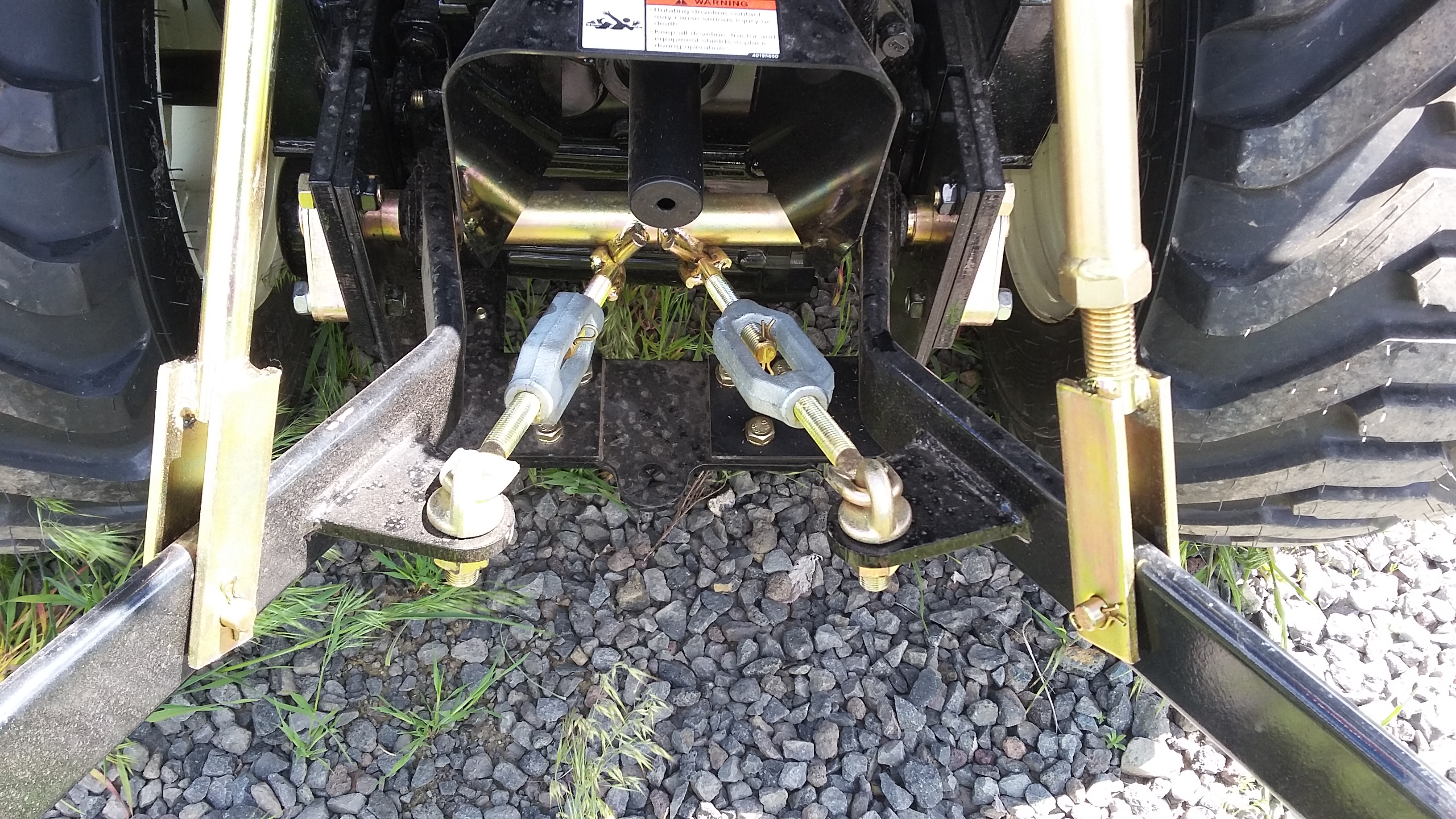

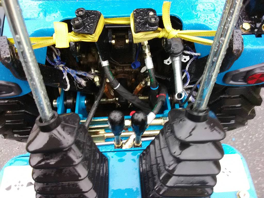

I got it on, but it's a Major Payne to be sure. I have less than a half inch of clearance on either side with the BH raised enough to get the bottom pins over the hooks. Everything has to be lined up exactly right to be able to do it. Had to pull the shroud to be able to even get close. Dealer says he can get me the kit for under $50. I may go that way yet, but for now, I'll try to find a better way to hold the arms up. What you see is just temporary for testing.
   / LS mt125 3 point "update" #45
nice work. How long does it take you to swap?
also noticed you are in the rain and your joystick boots are loose fitting. seal them up really good with some PL black roofing urethane. Other wise you will end up like the rest of us and have rusty valves
loaders and BH only have 1 year warranty...

For some reason I couldn't get the kit without paying, so I just leave the arms on full time now. They lift up and out of the way enough to get the BH on and off. Did have to pull the PTO shroud, which I'd still like to modify somehow so I could put it back on.
   / LS mt125 3 point "update" #49

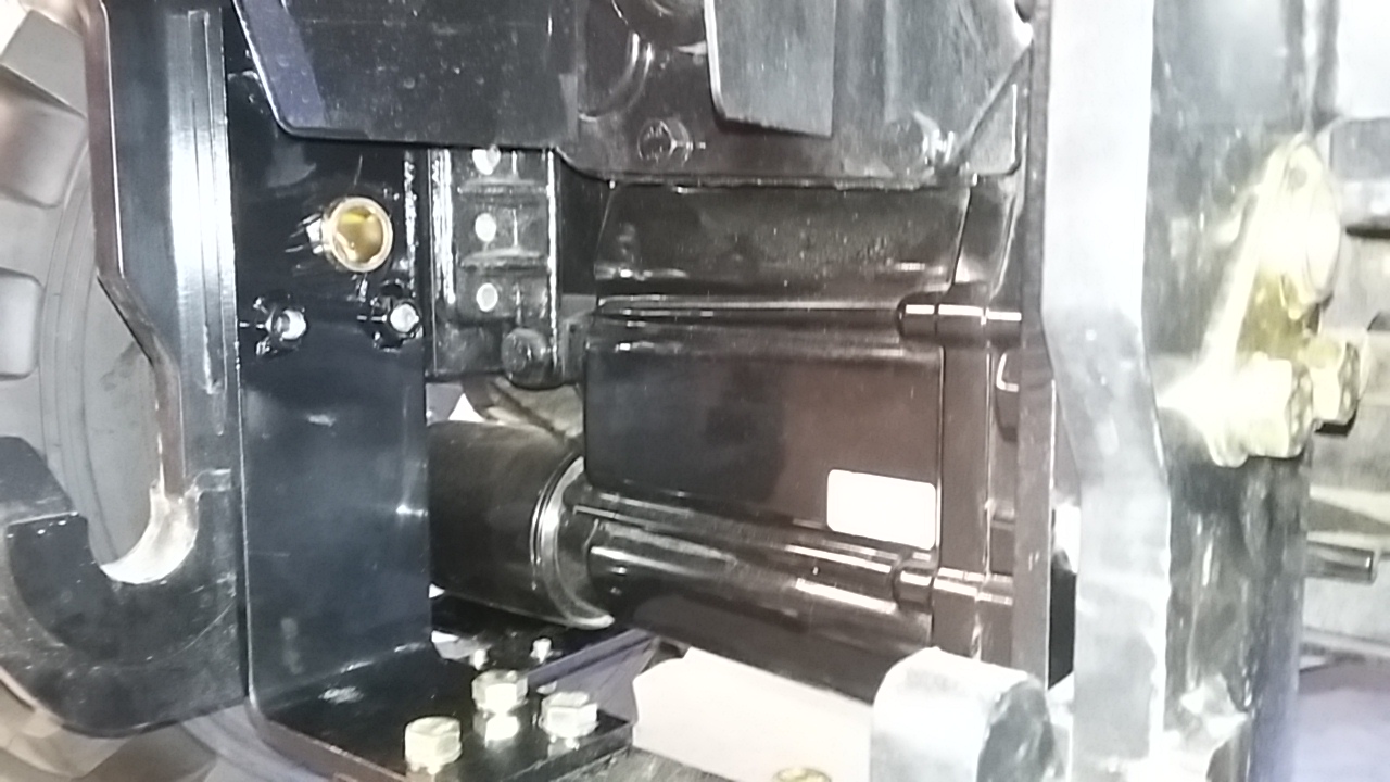

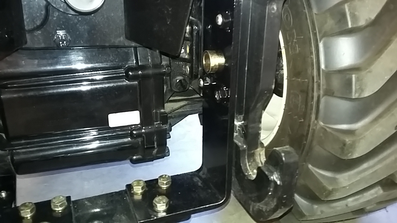

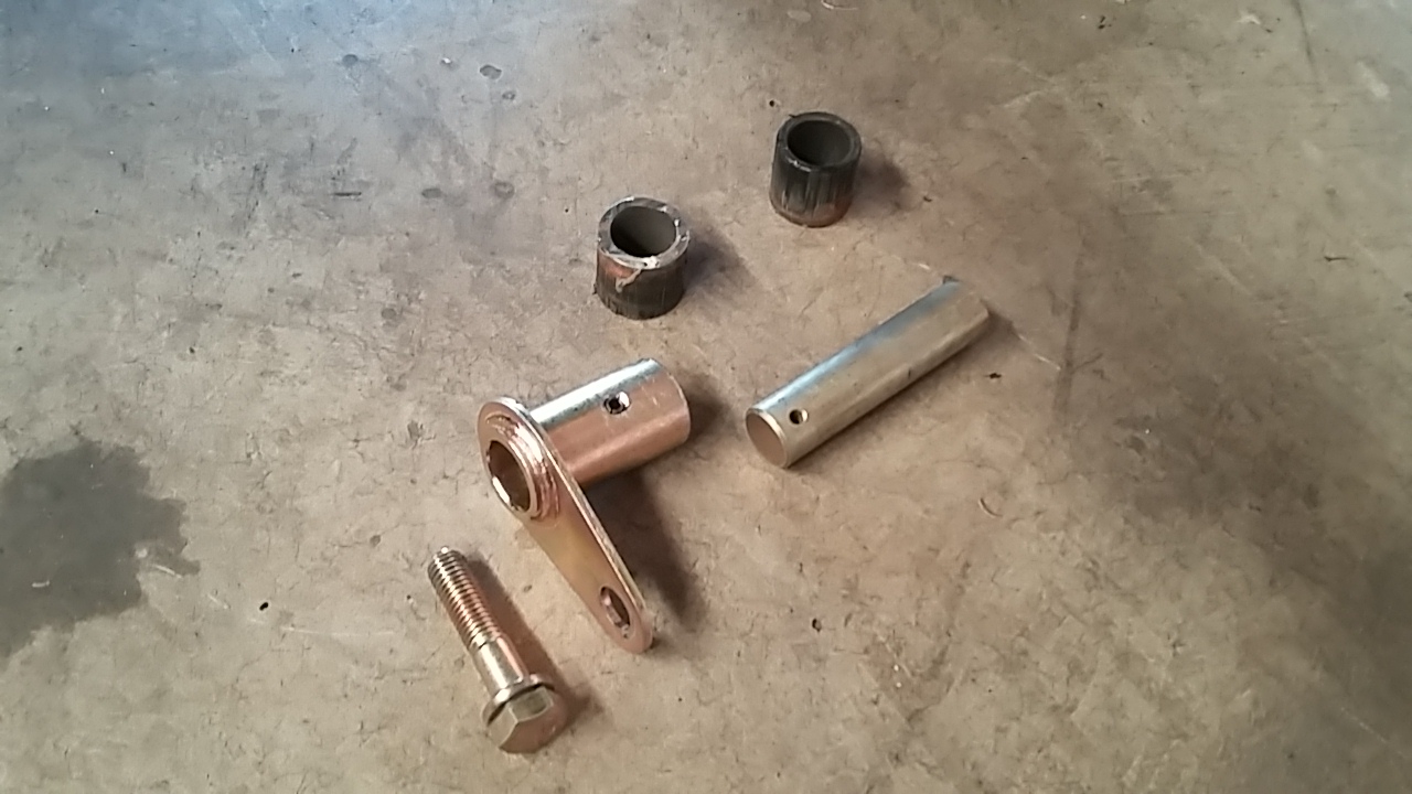

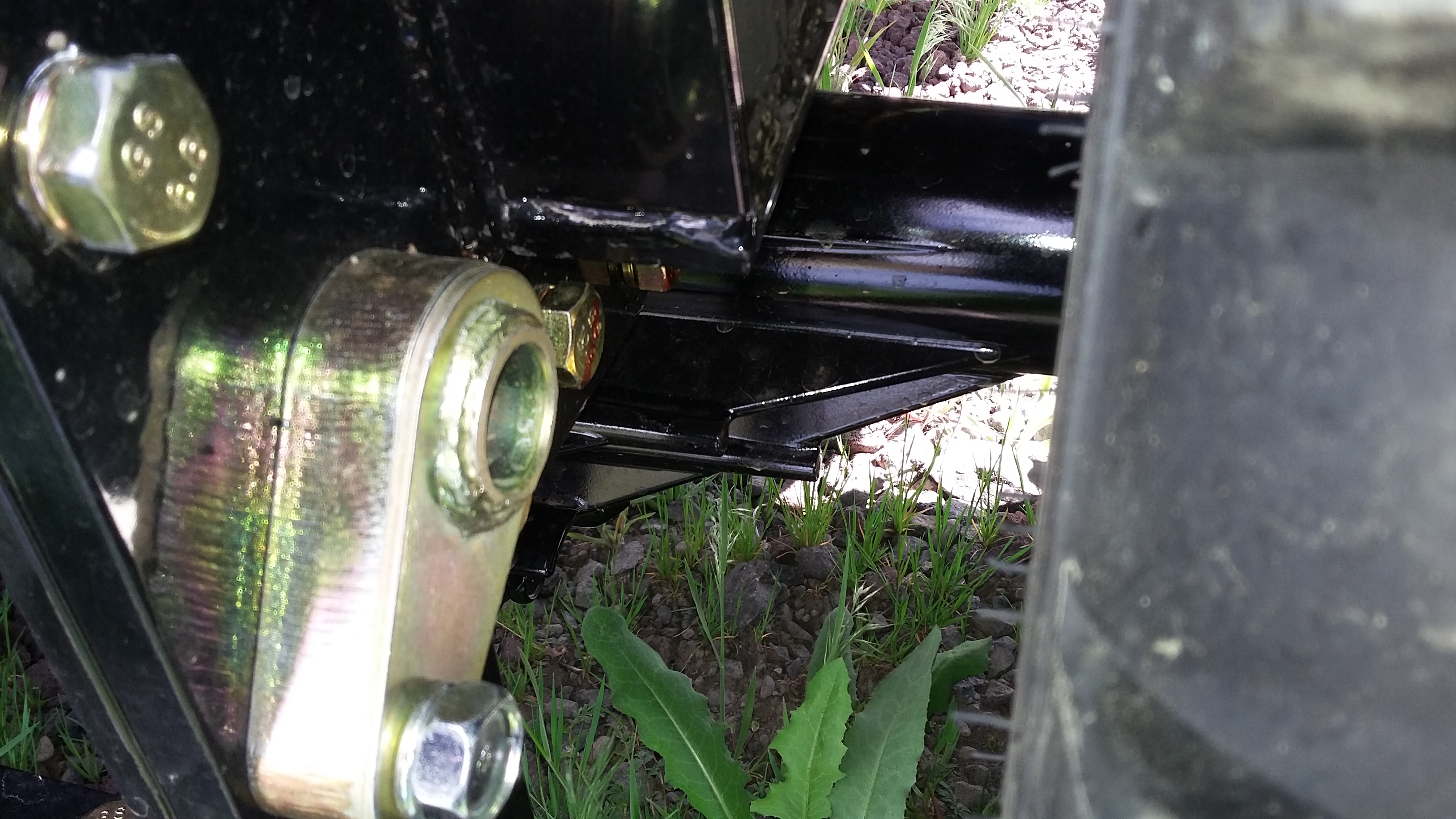

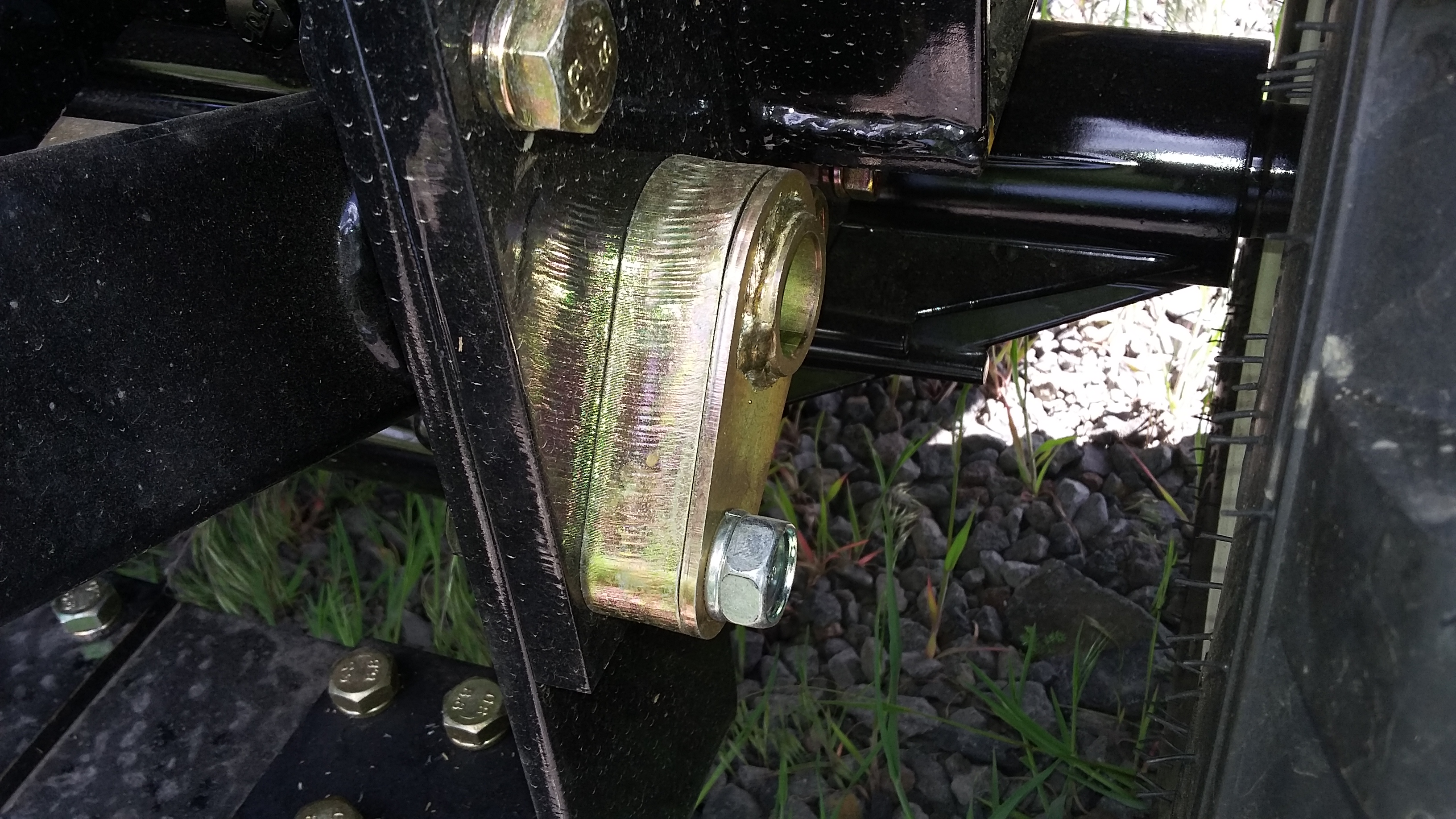

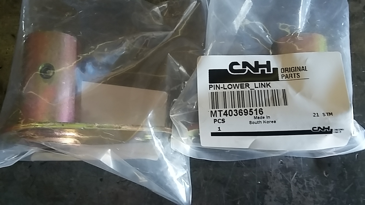

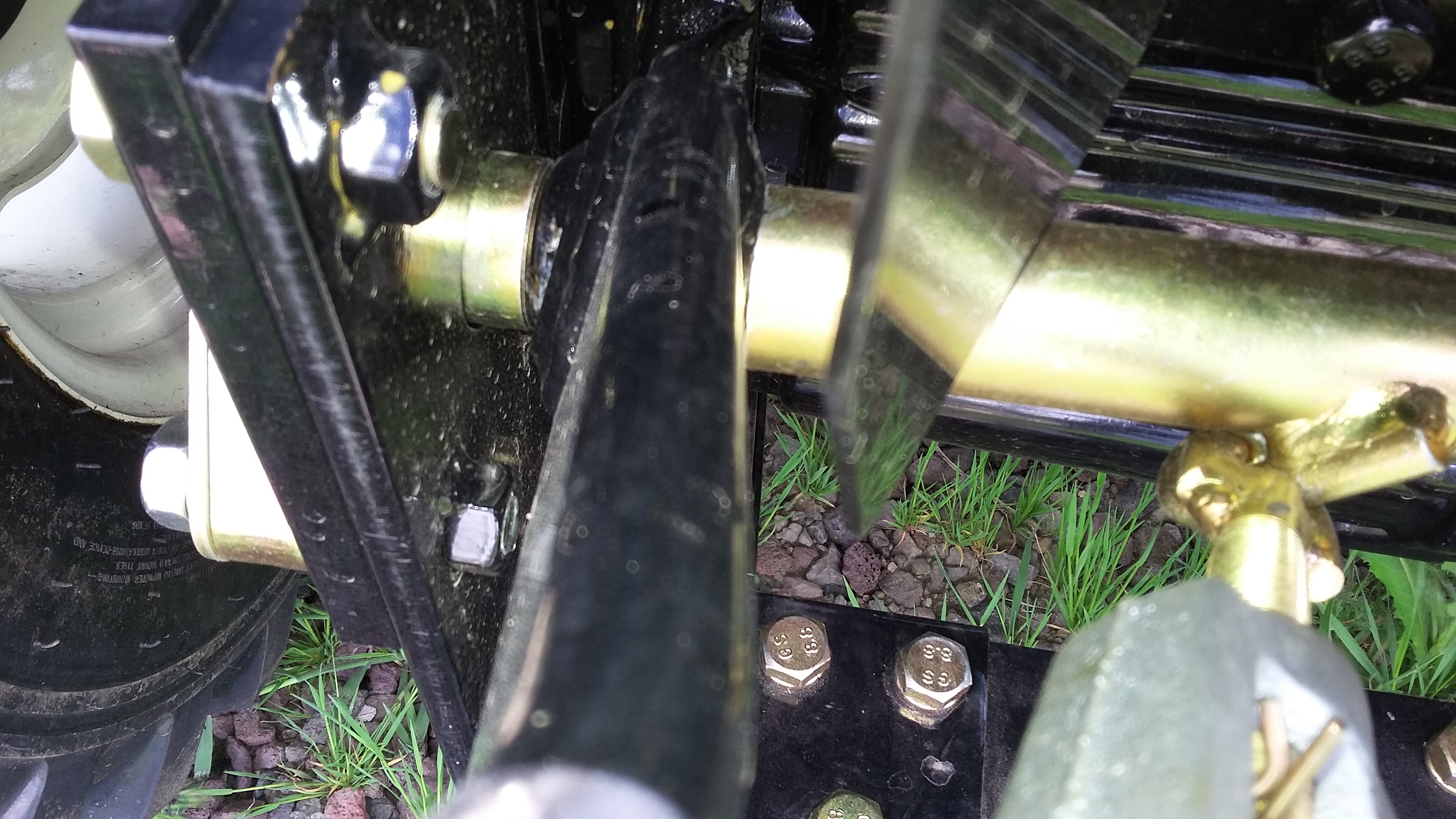

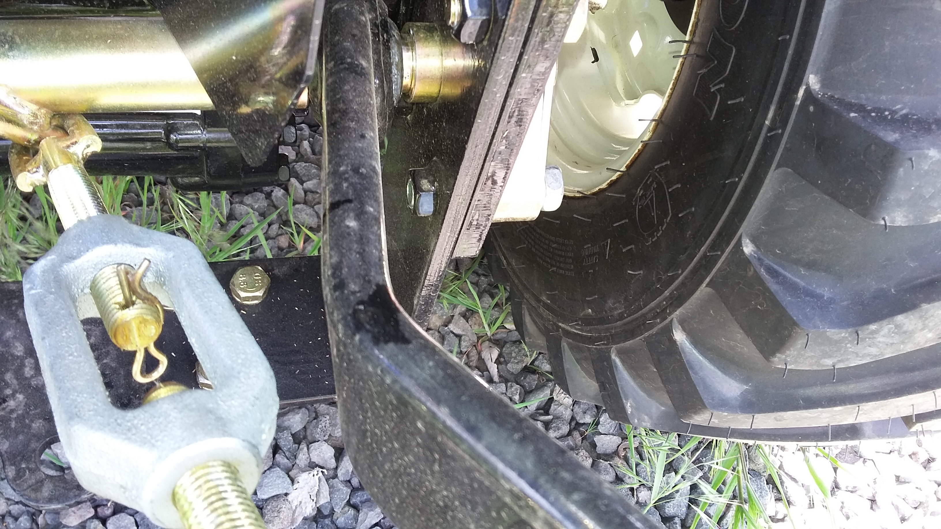

Gentlemen, on page 4 of this thread is how I purchased two "pins" for a total of $30 and modified my parts to put on my factory arms in the "new factory configuration". About an hours worth of work, some spray paint and I have the new factory setup on my tractor. Check it out as I posted pictures too.
