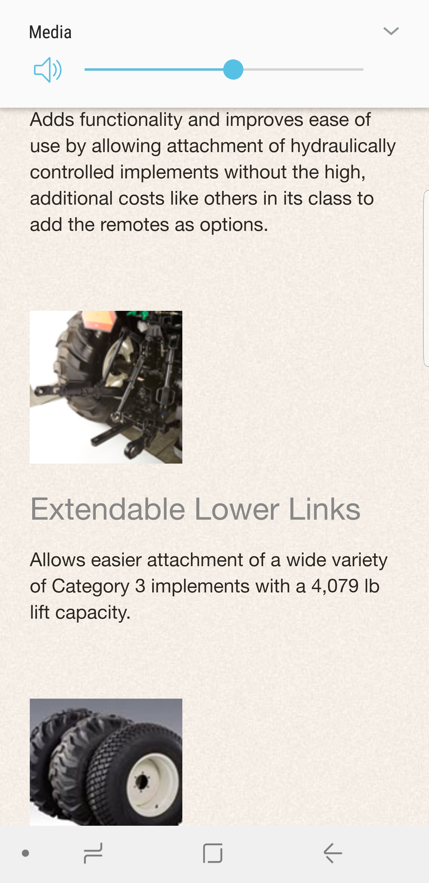

I found 4,079 lb as the number listed for the 3 pt on the LS.
I know for myself, I wish that I had a 16x16 trans at a minimum. When I disk, there are times where I simply DO NOT have the right gear. One gear the tractor pulls very easy, but to slow and the next gear up it lugs the engine to much and simply will not pull properly. And that is splitting gear ranges etc. The gear ratio needed simply IS NOT THERE. :(
This is what I see listed under specifications.
Hydraulic System
Hitch lift capacity, lbs: 6,614
Where are you seeing the 4,079 number? :confused:
/ LS MT573 vs Kioti RX7320
#11
This is where I found it.
