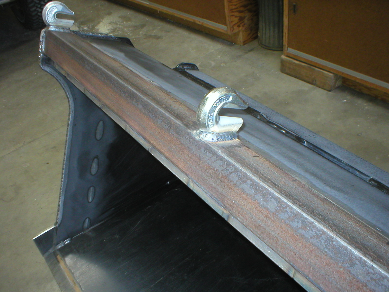

I did not back up my bucket hooks. I will let you know when I have a failure there. So far, so good.
/ LS R4047 #23
Please do! :thumbsup:
Is that hooks on the front edge and the top side? Any particular reason?

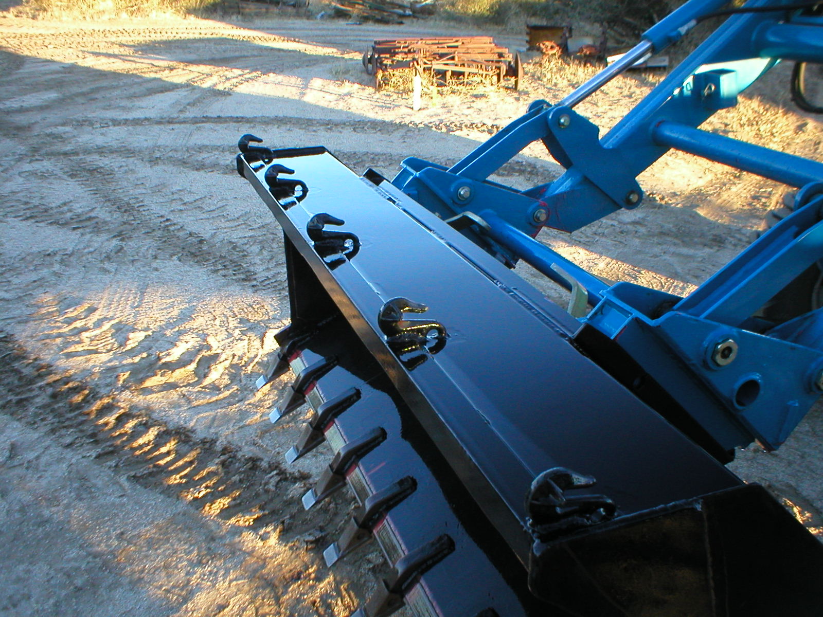

A bolt on tooth bar is what most guys use. I have a separate bucket with welded on tooth holders with replaceable teeth. The teeth or tooth bar make digging much much easier on the tractor and just plain easier to do.
On a side note, I have never seen any of the tractors that most of us TBNers have, SCUTs, CUTs or even UTILITY tractors advertised showing the tractor digging with the loader in any type of hard material. The ads always show the loader working with loose types of material. ;)

Short Game, I don't think that I insinuated that there would be a failure. :confused: But if you lift the weight capacity of your loader with the hooks welded to the bucket without any additional backing, there will be a very good chance that the bucket will bend. It may not happen the first or second time, but eventually the bucket will indeed bend. Seen it in person and here on TBN to many times. :(
But I'm glad that you have had no problems with your setup. :cool:

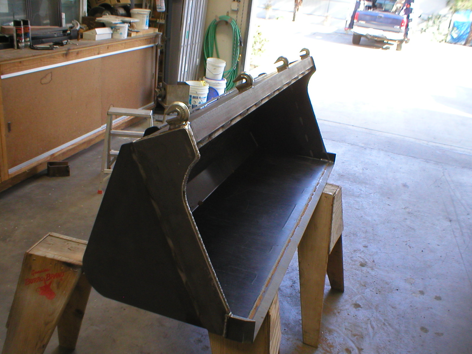

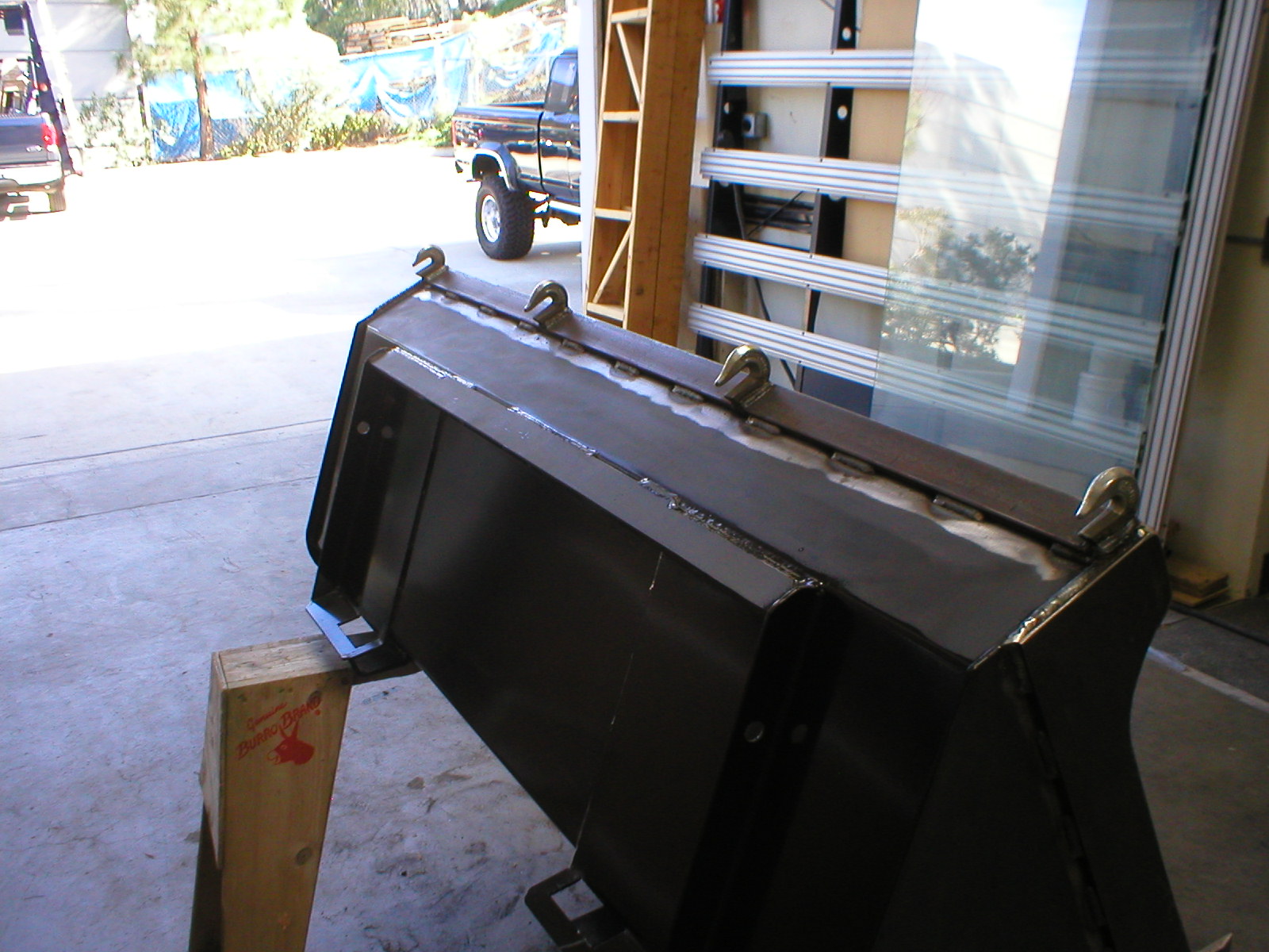

Yes. I put the grab hooks on the front corners such that the chain stays in with gravity if I roll back the bucket. My old Cub Cadet came with hooks at an angle that turned upside down when I rolled the bucket back, and if there was slack on the chain, it could fall out. So I liked the grab hooks angled that way much better. The slide hook in the middle is also the way my Cub Cadet was rigged when I got it. I learned to love that configuration. I like to lift and pull from the center when I can, and I use chains that are long enough so that I can just flip the chain over that large slide hook, pull up the slack and hang it in the grab hook at whichever end of the bucket I happen to be standing.

Well, I just aped what came on my used 27 HP Cub Cadet's loader. But here, once again, that Cub Cadet 417 loader (actually a Woods 165, I believe, though the Cub Cadet name is on it) is just better in every way (except for the quick disconnect bucket) than my LS 4100 loader. This includes how stout the bucket is too. I spent years doing maximum lifts and pulls with the hooks welded directly to that bucket with no sign of failure. So I never thought about how much thinner the steel is on the top edge of this bucket than the other one before I welded the hooks on it. I also set up a friend's Montana bucket the same way. I hope I didn't mess it up for him.

Couldn't really see your slide hook. Do you have another pic showing that?
I can see part of why you liked that loader, the cylinder is mounted with more angle giving it better leverage for lifting. The cylinders look a bit skinnier so that counters the additional lifting force you would get from the angle but it would also help the cylinders cycle faster. They made some interesting choices in putting it together but I think the length of those cylinders are the first thing looked at when trying to cost-cut and make loaders cheaper. Shorter cylinders are just cheaper...
The Cub Cadet bucket hooks were there when I go it. I only added the receiver hitch. The receiver hitch got more use as a socket for my 4.5' square tube boom. It's useless for that on the LS because the roll-back is so gutless. I have lifted 300 pounds at the end of the boom with my Cub. I couldn't lift 50 pounds on that boom when I needed to with the LS.
Here are closeups of each bucket.

Okay, so it is just a larger hook that won't bind the chain...
You may want to have a dealer check your hydraulics. The curl feels a little weak to me too but I have no doubt that I could curl 300 lbs with it. It may depend somewhat on how long and heavy that boom is... Maybe they assembled your curl hydraulics with a hose backwards or a clog on one side...
