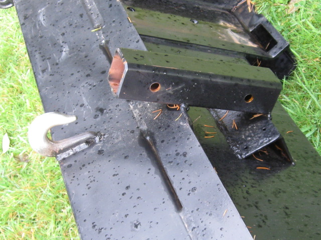

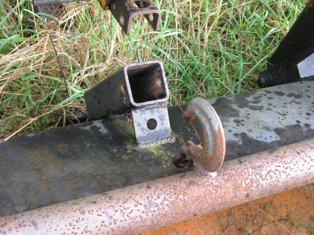

Yes. I put the grab hooks on the front corners such that the chain stays in with gravity if I roll back the bucket. My old Cub Cadet came with hooks at an angle that turned upside down when I rolled the bucket back, and if there was slack on the chain, it could fall out. So I liked the grab hooks angled that way much better. The slide hook in the middle is also the way my Cub Cadet was rigged when I got it. I learned to love that configuration. I like to lift and pull from the center when I can, and I use chains that are long enough so that I can just flip the chain over that large slide hook, pull up the slack and hang it in the grab hook at whichever end of the bucket I happen to be standing.
Short Game, I don't think that I insinuated that there would be a failure. :confused: But if you lift the weight capacity of your loader with the hooks welded to the bucket without any additional backing, there will be a very good chance that the bucket will bend. It may not happen the first or second time, but eventually the bucket will indeed bend. Seen it in person and here on TBN to many times. :(
But I'm glad that you have had no problems with your setup. :cool:
Well, I just aped what came on my used 27 HP Cub Cadet's loader. But here, once again, that Cub Cadet 417 loader (actually a Woods 165, I believe, though the Cub Cadet name is on it) is just better in every way (except for the quick disconnect bucket) than my LS 4100 loader. This includes how stout the bucket is too. I spent years doing maximum lifts and pulls with the hooks welded directly to that bucket with no sign of failure. So I never thought about how much thinner the steel is on the top edge of this bucket than the other one before I welded the hooks on it. I also set up a friend's Montana bucket the same way. I hope I didn't mess it up for him.

Couldn't really see your slide hook. Do you have another pic showing that?
The Cub Cadet bucket hooks were there when I go it. I only added the receiver hitch. The receiver hitch got more use as a socket for my 4.5' square tube boom. It's useless for that on the LS because the roll-back is so gutless. I have lifted 300 pounds at the end of the boom with my Cub. I couldn't lift 50 pounds on that boom when I needed to with the LS.
Here are closeups of each bucket.
