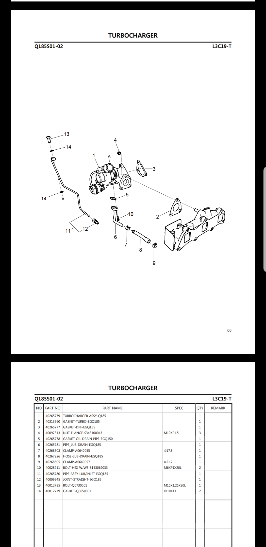

So I've noticed on the ls website that almost all ls xr models use the same engine from 35 to 55 hp wonder what the difference is. Looking at new holland boomer 35 and 40 the engines are the same as are the turbos and ecu according to part numbers.

As far as I know, no one has cracked the code on these LS engines yet to reprogram the ECU.
I do not believe there are any differences in drive train either. That would not make much sense from a manufacturing point. To have to retool just to make a different transmission for the same frame tractor with the same engine with different ecu programming.
From what I understand, there is a difference in turbo size from the 45hp to the 50 and above in the XR models. Though that might be a bit off. I know they are different and I have the smaller one. And it is very small!, but I can say I have a turbo! :D
Other than that, I belive it is just ecu programing that is the difference. Before too long, someone will 'crack the code' and we will all be driving around more powerful tractors :laughing:. But I wouldnt hold your breath. LS is not exactly John Deere with Right to Repair BS.
