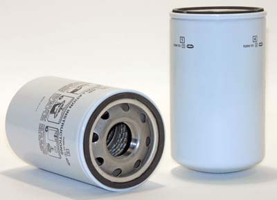

Thanks! Do you know the part # for the hydraulic filter? Is it by any chance this?
This was taken off the rocknrods 2nd post and is the Wix 51715 & Napa 1715 Hydraulic Filter . I cant seem to find any info on the R3039 engine and am not smart enough to know if the same filters apply to the R4010...
All I changed was the hydraulic filter at the 50 hour period (and of course the oil and filter) not the hydraulic oil itself, that was what my dealer told me to do. There is also a magnetic drain plug on the bottom of the transmission that I removed and cleaned off some small metal shavings, but that is a real pain because you get a large rush of hydraulic fluid as soon as you remove the plug. I was ready for the fluid and had a drain pan and a second person when I did it, I just held my hand over the whole as the boy cleaned off the magnet. After I was done I strained the fluid a caught and reused it and I only had to add a small amount to top it off. In any event cleaning the plug off is a real pain and messy to boot, in my case there wasn't very much on the magnet but still and all I am glad I did it better safe that sorry I guess as a matter of fact I am almost at 450 hours now and I may check it out again just for good measure.
Thanks I guess I overloooked it. I am not having any luck cross referencing that filter. Tried to cross it on wix website, with no luck.
Anyone have any luck crossing it with another filter?
Comparing the OEM filter numbers in posts 71 & 68 with Underdog57's cross reference list in post 136, the 3033, 3038, 3039, 4041, all use the same filters.
