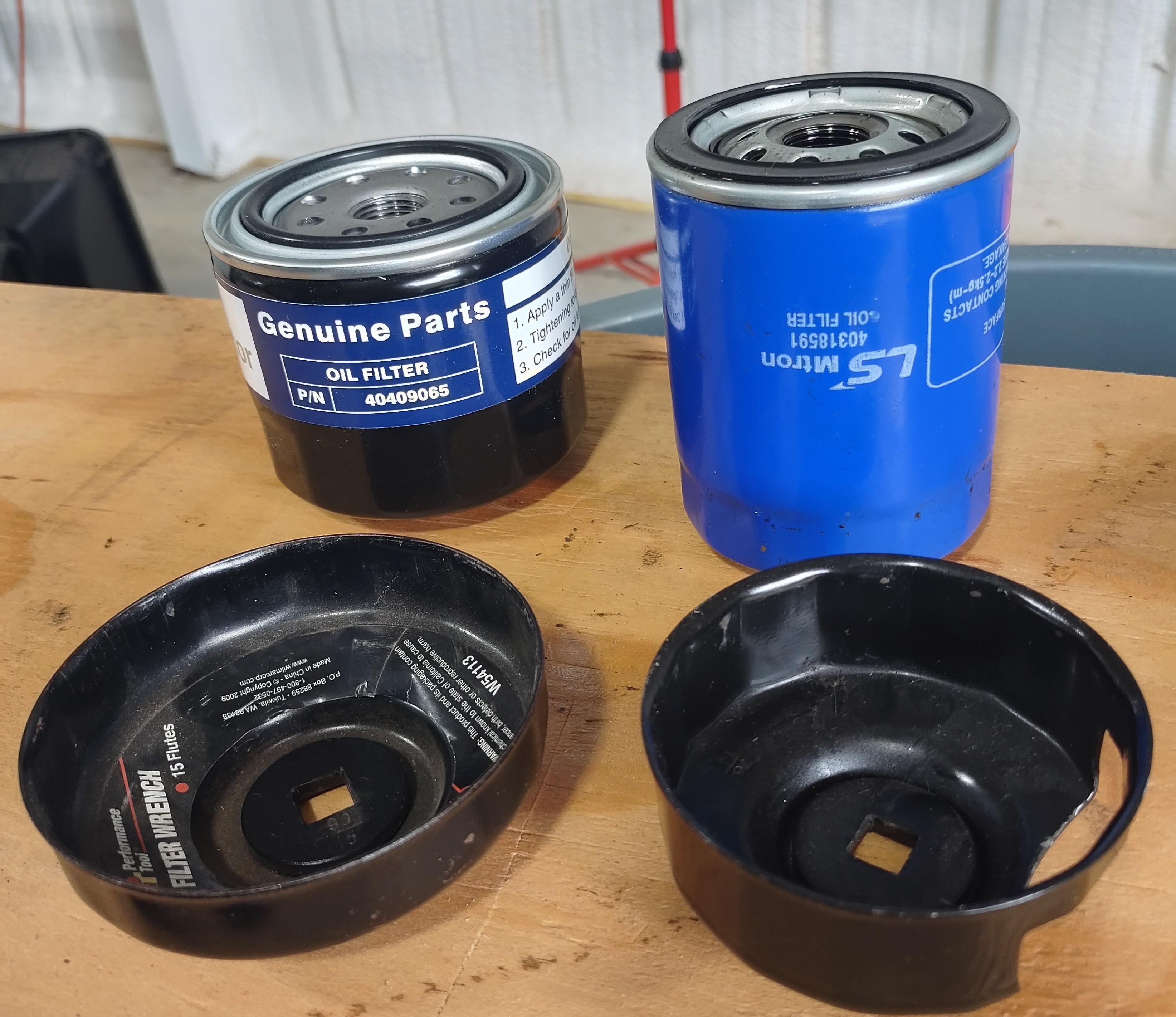

Seems like above mentioned filters are all from china. So I guess
I'm stuck buying LS brand. Anyway, for those you who don't
have a CUT but do have a Utility Tractor, XU6168/MT 573 or similar;
the LS part #'s have changed and so have the filter sizes.
Oil Filter: old part #40318591 / New part #40409065

Those changed back around 2020!
The same numbers for my MT240HE, The 40409065 is shorter but fatter.

I had bought a filter pack and multiple oil filters a few years back. It's what
the dealer sold me (old numbers). The filter pack had a filter or 2 that were
the wrong size for my machine. The oil filters were fine, but I've now used them
up and had to order some more. In the meantime the original dealer went
belly up. Just posting to let others (less aware of newer numbers) like me.
Definitely shorter and fatter.
