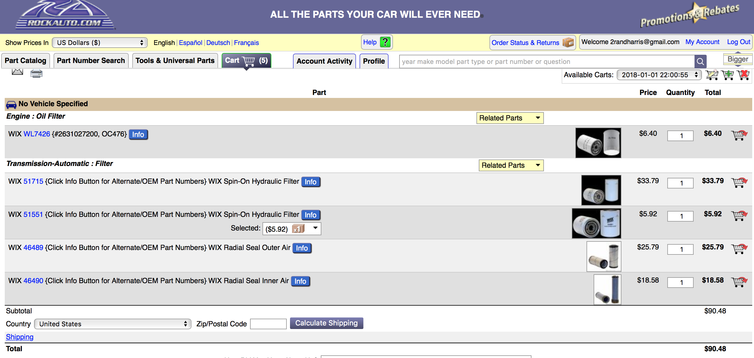

pn 40236010 oil filter cross to fram ph 10637 wix 57106 lf 3828. it took a lot of time to find this info.
   / LS Tractor Oil, Gas, & Air Filter Information #292
That guy was me. I bought my filters from Rockauto ($6) WIX WL7426 Oil Filter | RockAuto
I bought 3 of them, so the shipping wasn't too bad in the long run. When you take off your old filter, would you send it to me? I want to cut it open and compare it to the Wix unit, I'll open one of those up too and post pics.
As far as the hydro-static filter at 50hrs, I'll do mine this spring at about 65hrs, just because it's cheap insurance.
Hydraulic filter is at Rockauto too ($33) WIX 51715 | RockAuto
Fuel filter Rockauto ($6) WIX WF8395 Fuel Filter | RockAuto
Wix WL7426 definitely does not match my factory filter, which by the way was the hardest filter I have ever had to remove, by far. I'm going to try the Wix/Napa number that my dealer said to use. Original diameter is just under 3 inches, the 7426 is about 3.25". It was immediately obvious that it wasn't a match when I got the original.off finally :)
   / LS Tractor Oil, Gas, & Air Filter Information #293
I got the spec from the manufacture of the engine, not LS. The internal spec match that of the LS filter, it's just a bigger because the engine in other applications pumps more oil through it at higher RPM's. more filter material is never a bad thing. I searched a long time to make sure it was a correct spec'd filter. I too had a had time getting the original LS filter off.

Can someone confirm that one the XR4140 its the WIX 5151 for the oil filter?
