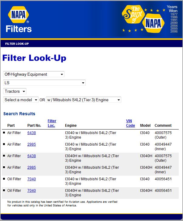

I might have missed it but has anyone come up with filter numbers for the R3039? I think the attached picture are the correct NAPA numbers for oil and air.

Originally Posted by Underdog57
2013 LS R4041H Engine - S4QL Mitsubishi Tier 3
Oil filter / OEM # 40006977 / NAPA # 1334 / WIX # 51334 / Bosch # 3310
Fuel filter / OEM # 40006997 / NAPA # 3128 / WIX # 33128
Hydraulic Filter / OEM # 40007638 / NAPA # 1715 / WIX # 51715
Hydro Transmission Filter / OEM # 40007563 / NAPA # 1551 / WIX # 51551
Inner Air Filter / OEM # 40049447 / NAPA # 2985 / WIX # 42985
Outer Air Filter / OEM # 40007575 / NAPA # 6438 / WIX # 46438
Update: The NAPA Oil filter #1064 & Wix Oil filter #5106453 would not fit my tractor. The correct oil filter for my 4041 is NAPA # 1334 or Wix # 51334 or Bosch # 3310.
These should be the Corrected numbers above ^
