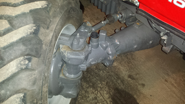

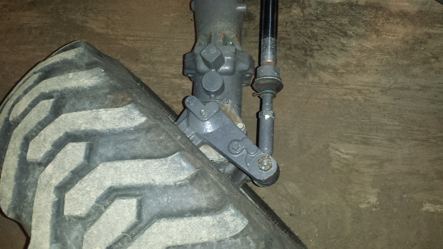

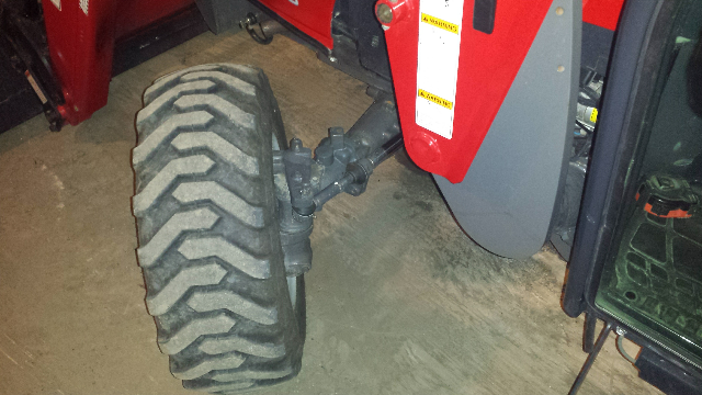

Here's my Massey: note, Massey (Iseki) puts the steering cylinder & tie rod behind the front axle. They are built into 1 unit.
Driver's side, looking from behind the front axle:

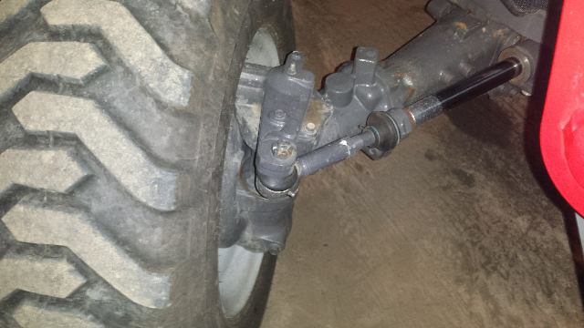

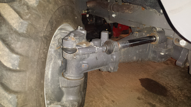

Passenger side, looking from in front of the axle:
And note, that little pool under the front is drainage from a fresh power washing this evening :D.
