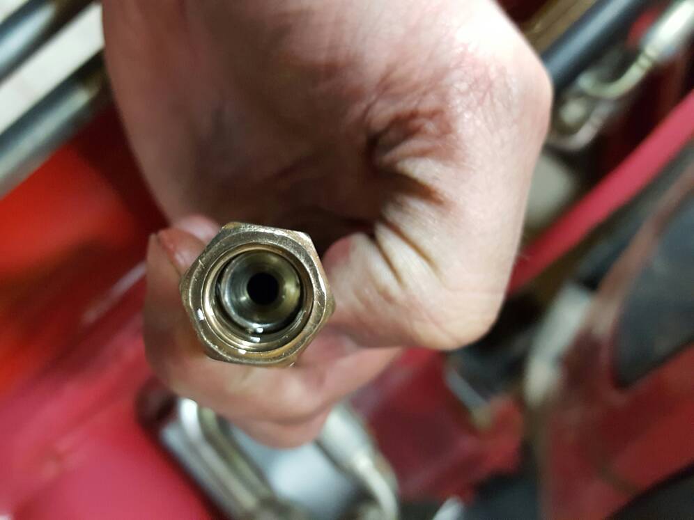

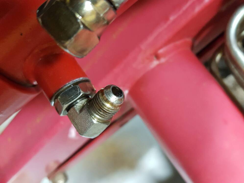

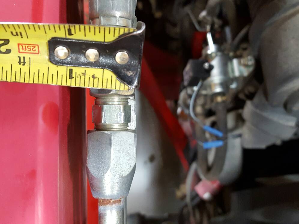

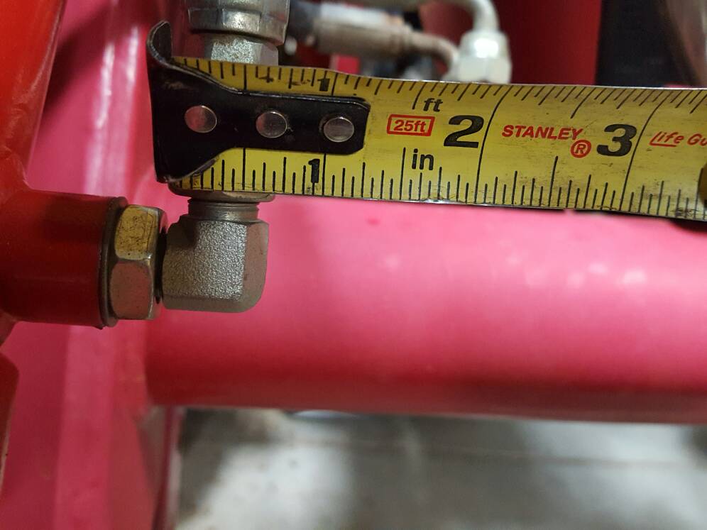

Does anyone happen to know the JIC fitting size on the LT200 loader for the T233 T273 T293 tractors? Looks like a 5/16 or 3/8"

Maybe pictures will be helpful.
uploadfromtaptalk1461722881989.jpguploadfromtaptalk1461722889263.jpguploadfromtaptalk1461722899403.jpguploadfromtaptalk1461722905298.jpg
/ LT200 loader JIC fitting size? #4
I had problems trying to replace a hose on a alamo long arm mower. A #4 nor #6 jic didnt fit, tried metric, nope. Turns out they used a #5jic. I didnt know they even made such a thing, but thats what it was
Confirmed they are JIC-4 1/4" . Thanks for the help.
I was incorrect above, they DO NOT use JIC-4.
Final confirmation that the steel tubing usings a JIC 6 fitting and the cylinders themselves use a JIC 5 fitting.
