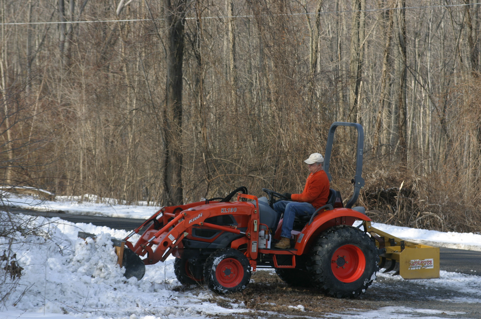

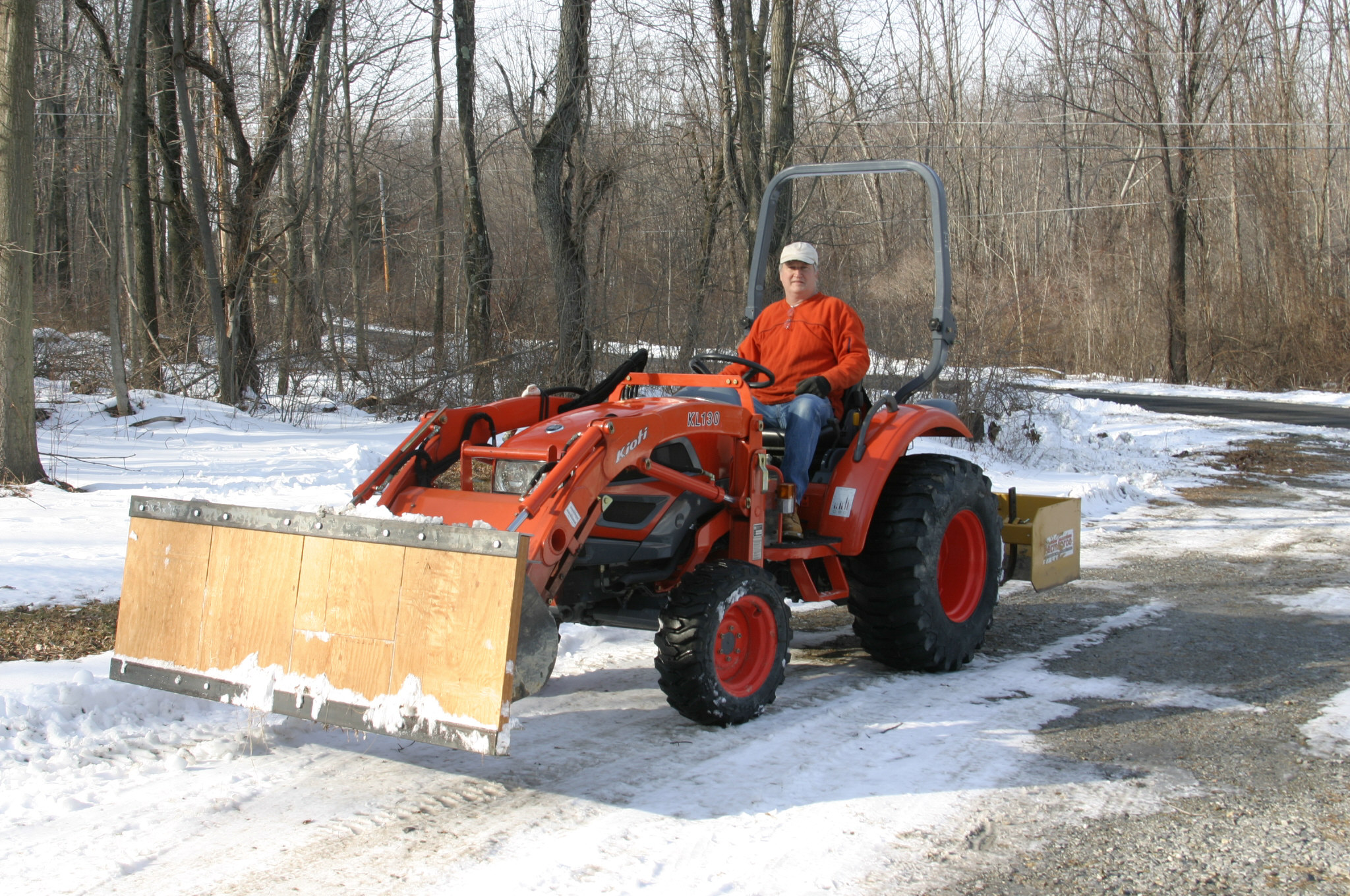

Well done. Good feeling to have an idea and then see it come full turn to actually working. :cool2:
Now, on to the next idea or premonition. Sounds like you are well on the way too. :)

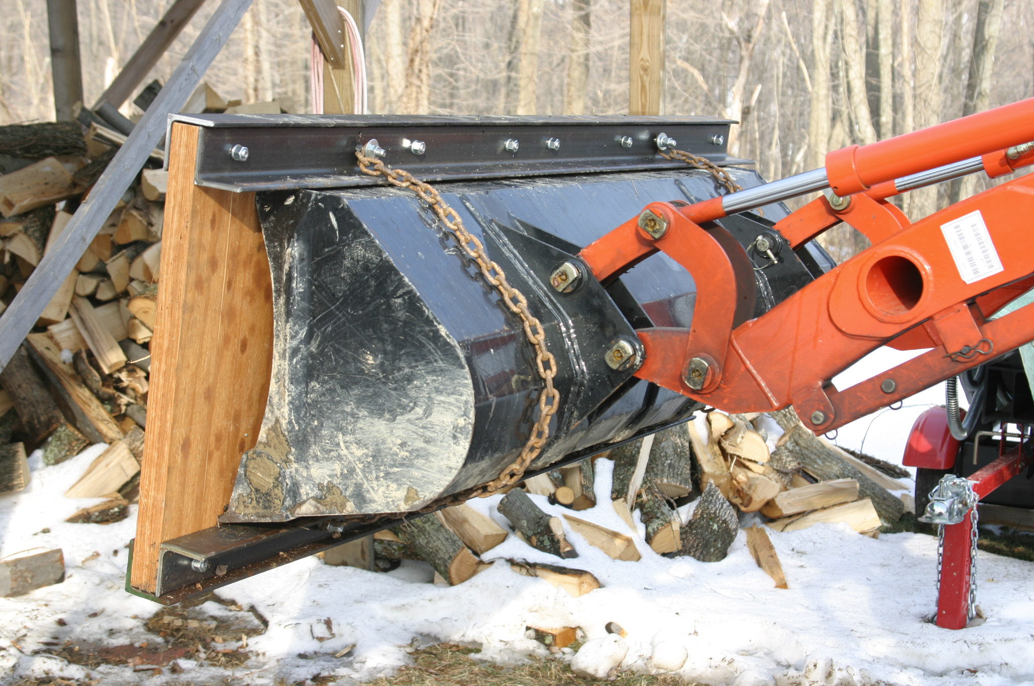

I had a friend build the same thing out of 3/4" plywood. He cut a full sheet in 2 2'x8' strips. He then placed each piece on cinder blocks and wet it repeatedly while adding weight to the center till it had the shape of a snow plow. He then Gorilla Glued and Pneumatic Stapled the two pieces together making a 2' tall by 8' wide by 1.5" thick plow blade. He did as you did and used heavy angle iron on both the top and bottom though bolted with 5/16" bolts every 8" or so. He used 2 2" wide ratchet straps to secure it to the bucket similar to yours. He had less than $50 in it since the plywood he got damaged at the lumber yard cheap.

I think it looks great! Gives me ideas to build my own. I'd slap on a good coat of poly to seal the wood from moisture and it should last a good long time.

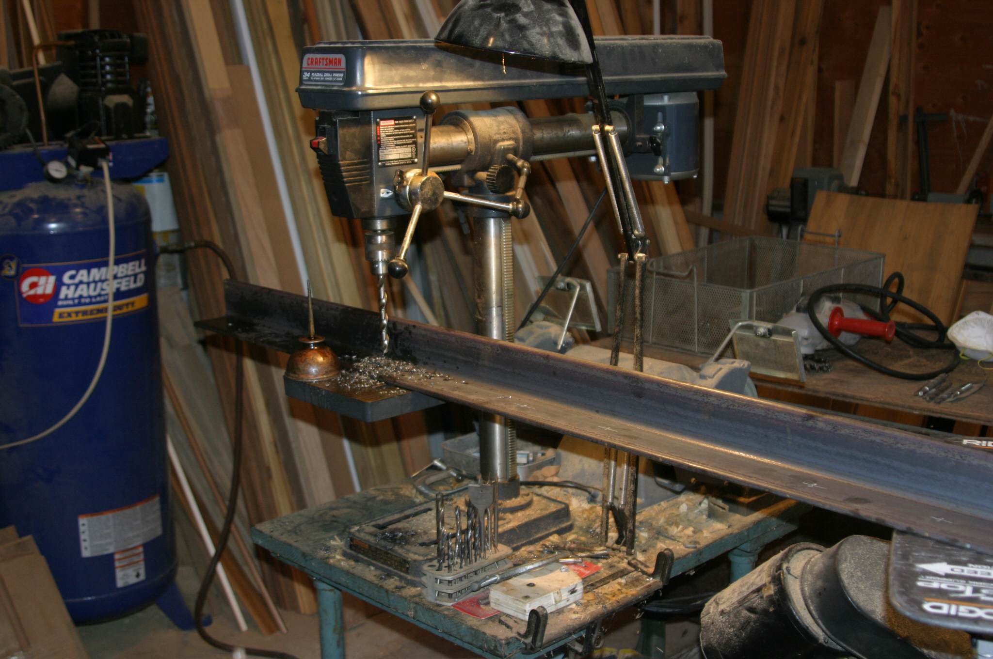

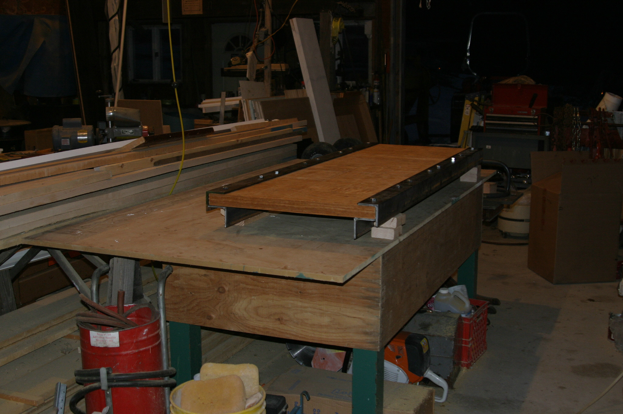

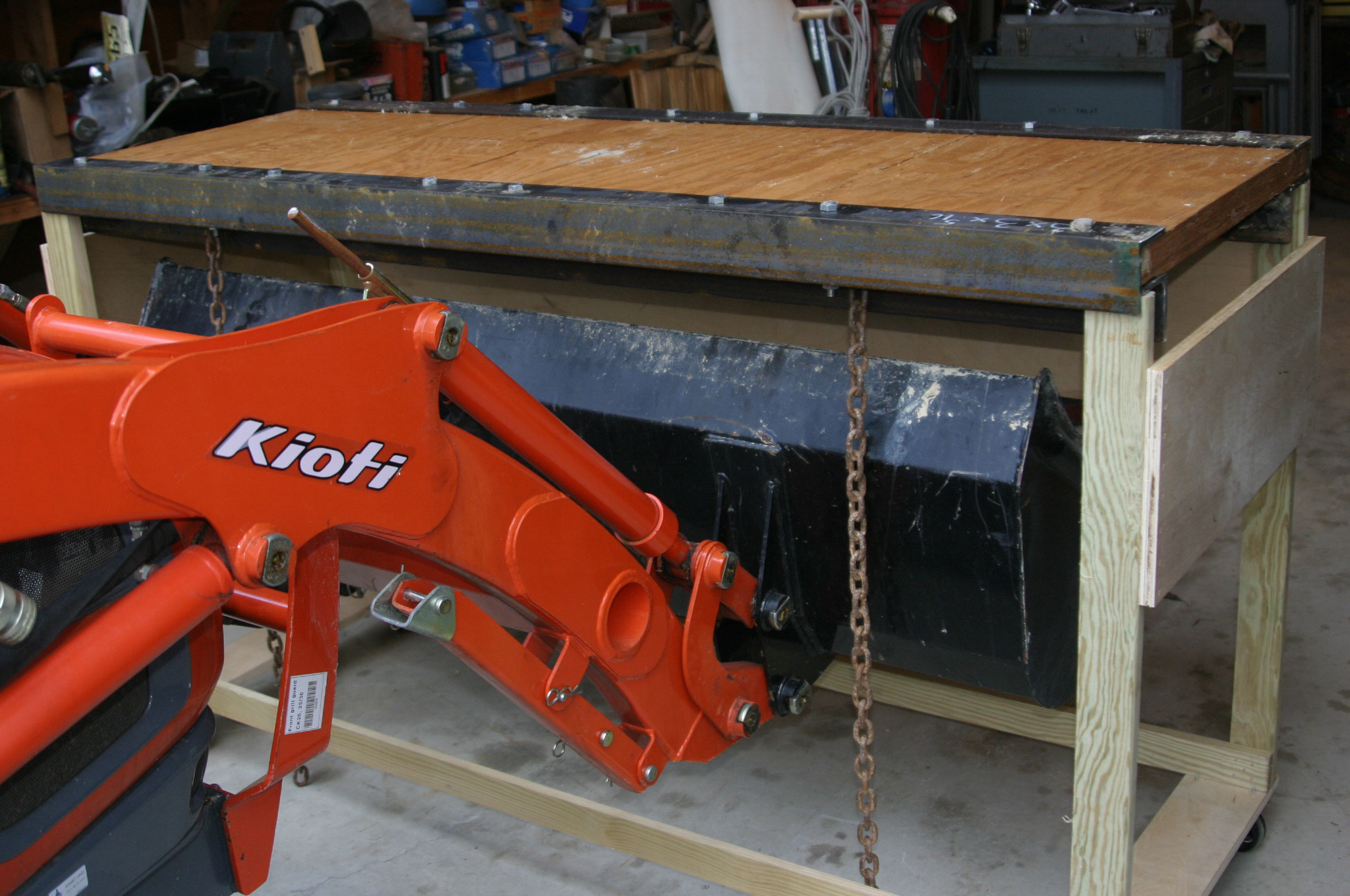

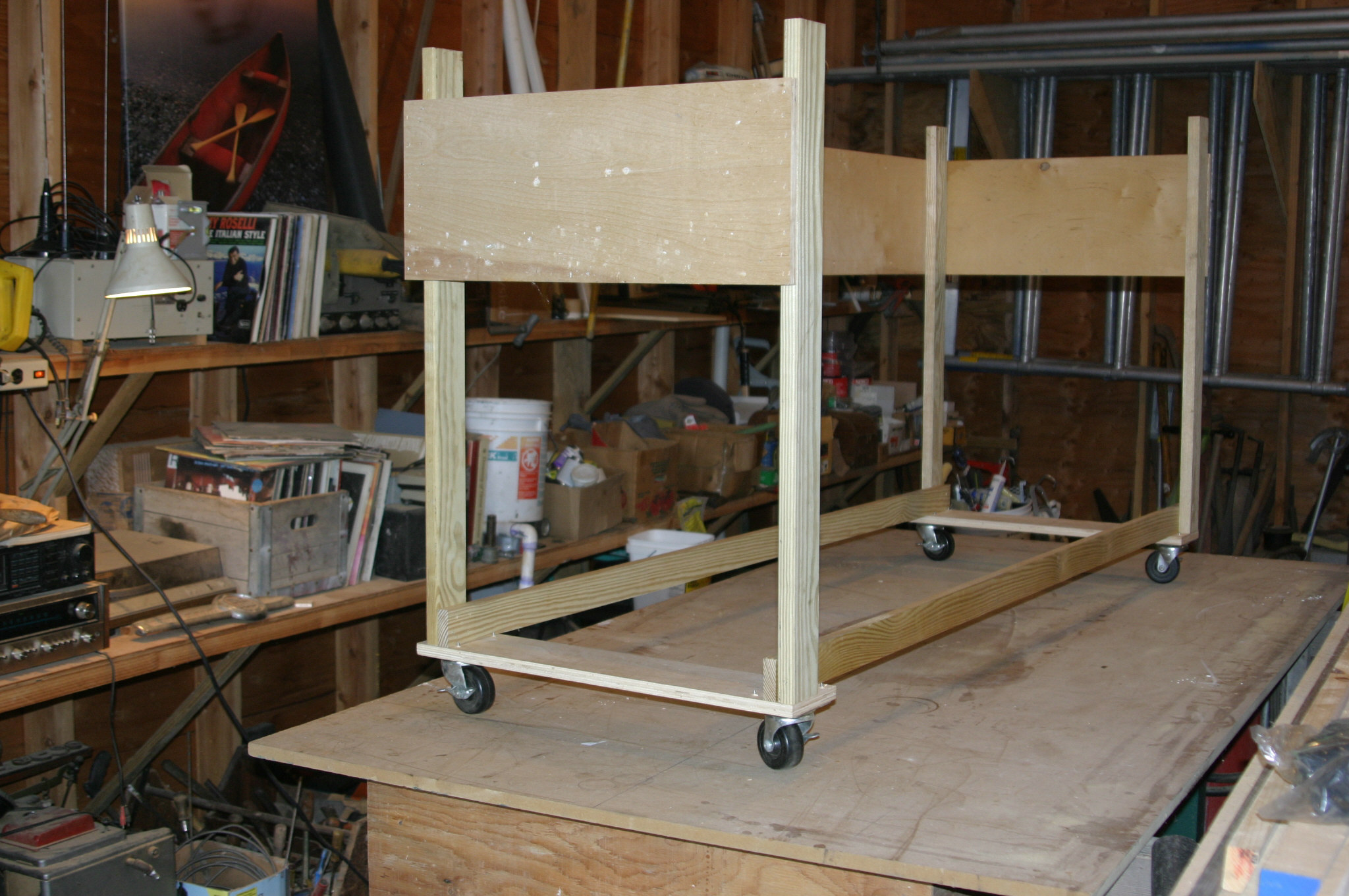

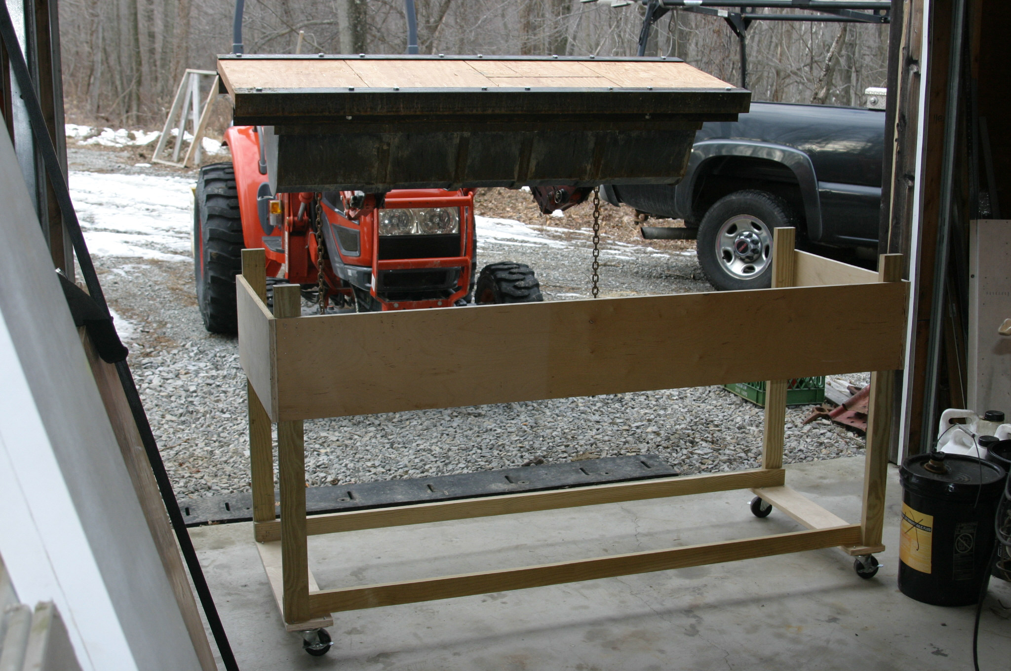

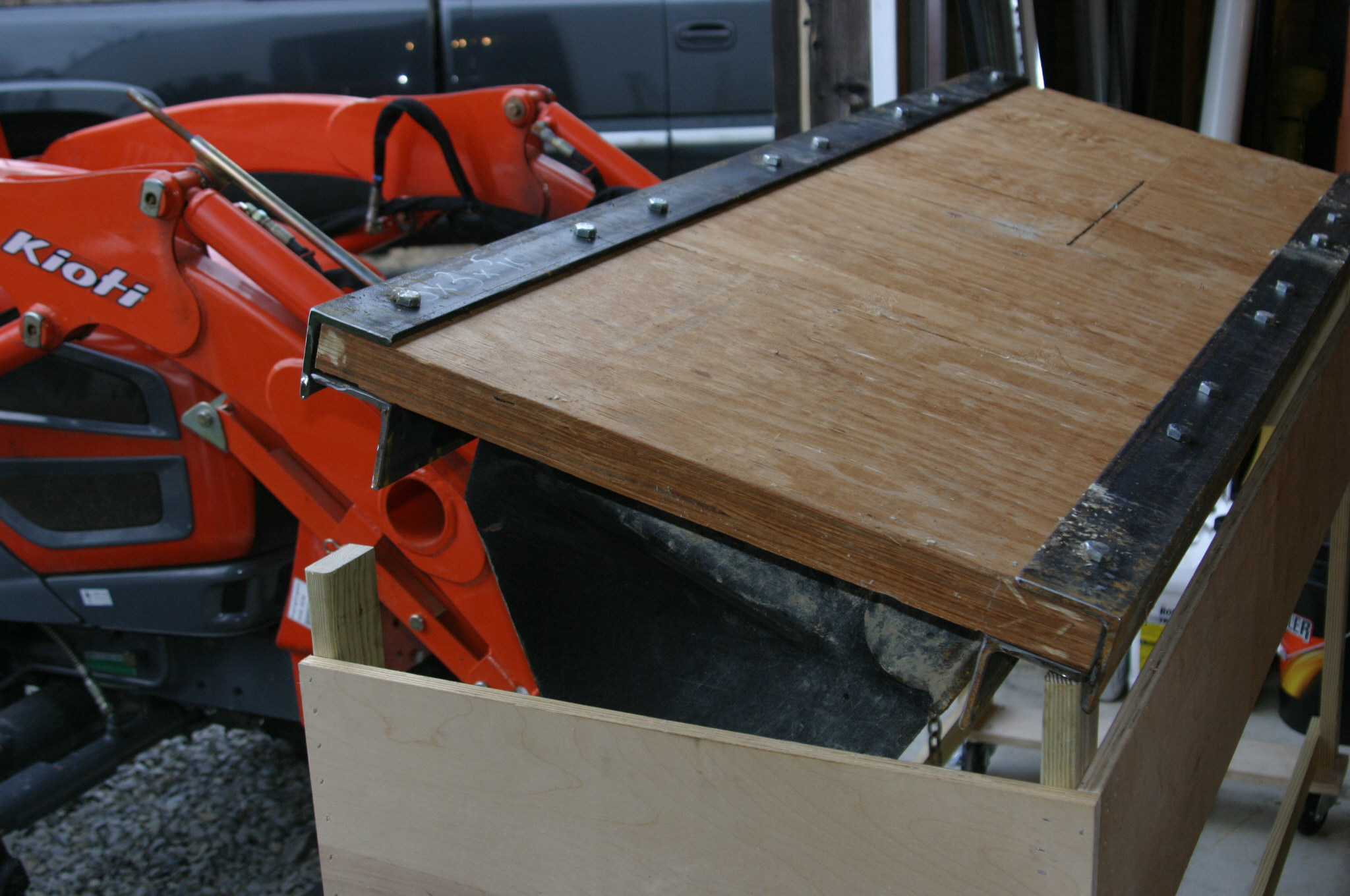

The lvls come with a wax coating, so I'm thinking paint is a no-go. Not painting the steel is just my inherent laziness. Today I'm gonna figure out a good place to drop it, maybe make a stand with wheels, or set it on some horses, I'm out of floor space..
Thanks for the comments!
/ LVL snow push
#25
I'll put a band of plywood with a shelf on it to sturdy this up, now that I marked how high it can be. Would be better welded up, but when you only have a hammer...
