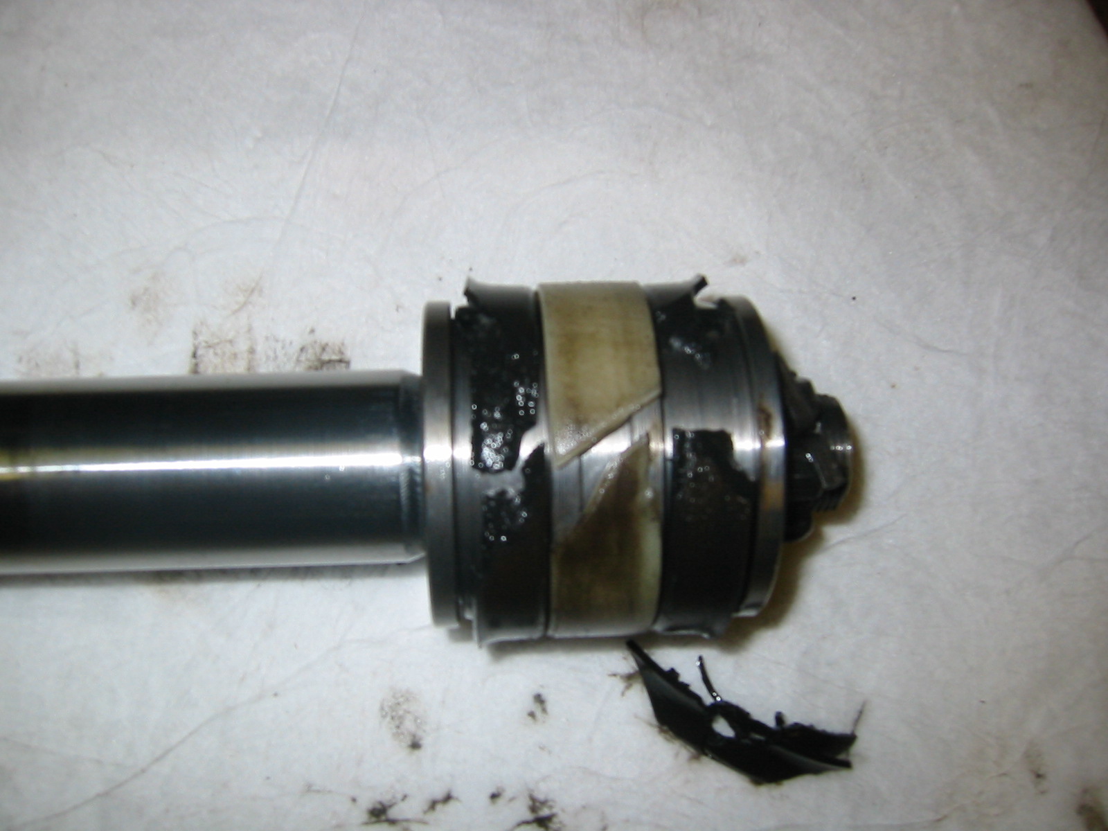

Bought a rebuild kit from circle G for a LW 6 dipper cylinder. Tried to take the darn thing apart to no avail. Got the snap ring off and pushed the gland inside. Then took a three piece retainer from inside the outer bore off, and still can't get the rod out. Does anyone have any tips or even better, photos on the rebuilding of the LW 6 cylinders??

After you push the end in and remove the three piece retainer, the piston and rod will come out, but it will not be easy. The edges of the machined areas in the cylinder are not chamfered so the seals will hang up on them. Plan on rounding those edges a little prior to assembly, it will make it go a little easier. You will need a piston ring compressor or similar tool for assembly.

Bob, you were right, tapped right out. Now of course there's another problem, the rebuild kit doesn't have the piston seals and wear ring in it. Looked on the circle G site where I bought the kit and don't see the piston parts there. Do you have a source for the piston seals and wear ring?? Thanks much
/ LW6 dipper cylinder disassembly???? #5
I bought mine from Tom at Keno Tractor in Oregon. They weren't the exact kits but the rod lip seal and piston seals were correct. You won't find that hard nylon wear ring anywhere except maybe China. Don't break it, it's supposed to have a ~45° split in it. I wound up getting the large O-rings from O-Rings West (local supplier but ships one or a hundred worldwide). Talk to Phillip at Circle-G, he may have the right kit after all.
Thanks again Bob, you've been very helpful. That nylon or teflon wear ring is broken, you can see where the 45 split was,,, much wider now. Will have to track down the parts, thanks again

I wouldn't worry too much about it being broken, unless it's broken in three pieces. It's function is to keep the piston centered in the cylinder, not being an oil barrier. The new cup seals should be an opaque polymer, a much better material than the OEM's.

Well I have to say (looking at picture) that your piston cups are worn. I thought mine were bad but they don't even show that much wear. I also had problems finding them (still have not rebuilt it yet). Circle G said they did not have any thing to match. When I get sometime, I am going to take mine (boom cylinder) to a cylinder rebuild shop and they said that they can match the parts exactly, but with better parts. INFO YOU I did buy a new cylinder from FarmPro parts site for 136.00 and change delivered. Did not fix my problem though.

Let us know how you faired with finding piston seals and parts. I went to two unrelated hydraulic specialty shops in Seattle. They both had the same parts books. Nowhere could identical (or close) matches be found.
