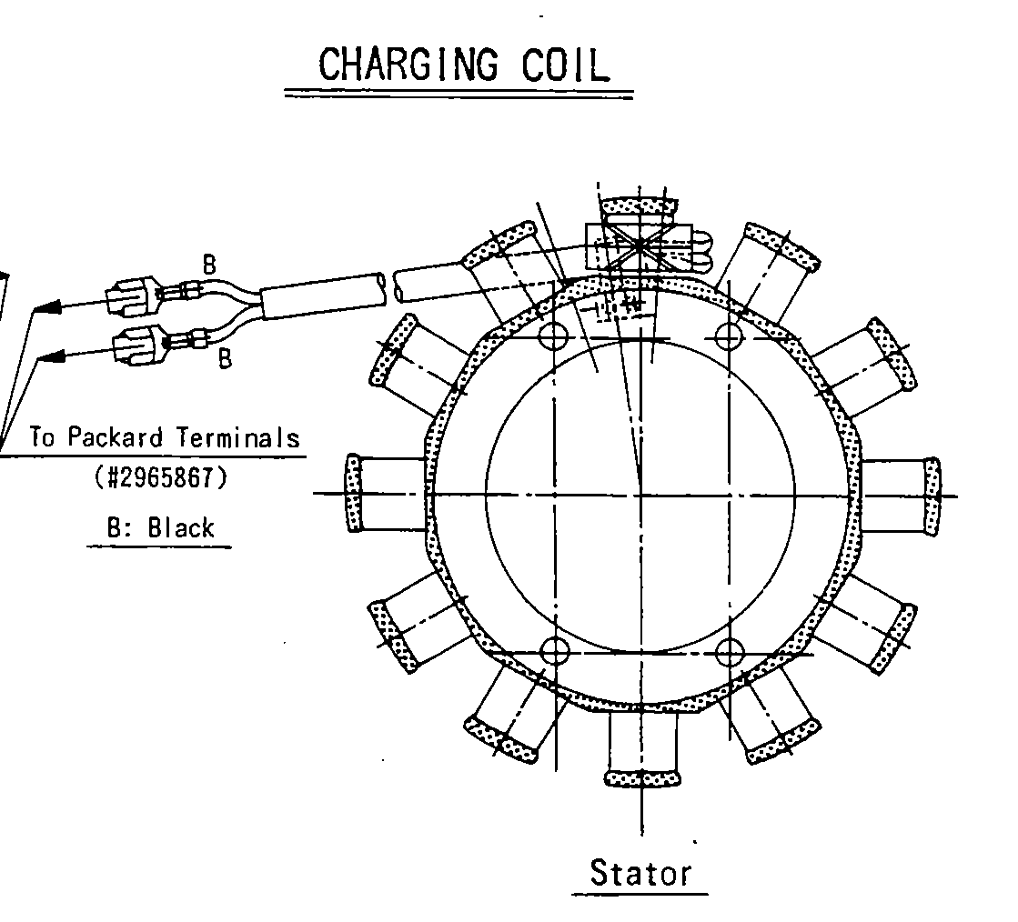

Here is a drawing of the charging coil, note that there are two leads coming from the coil.

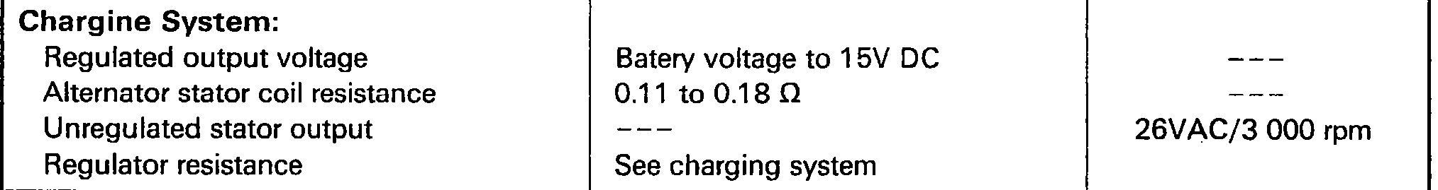

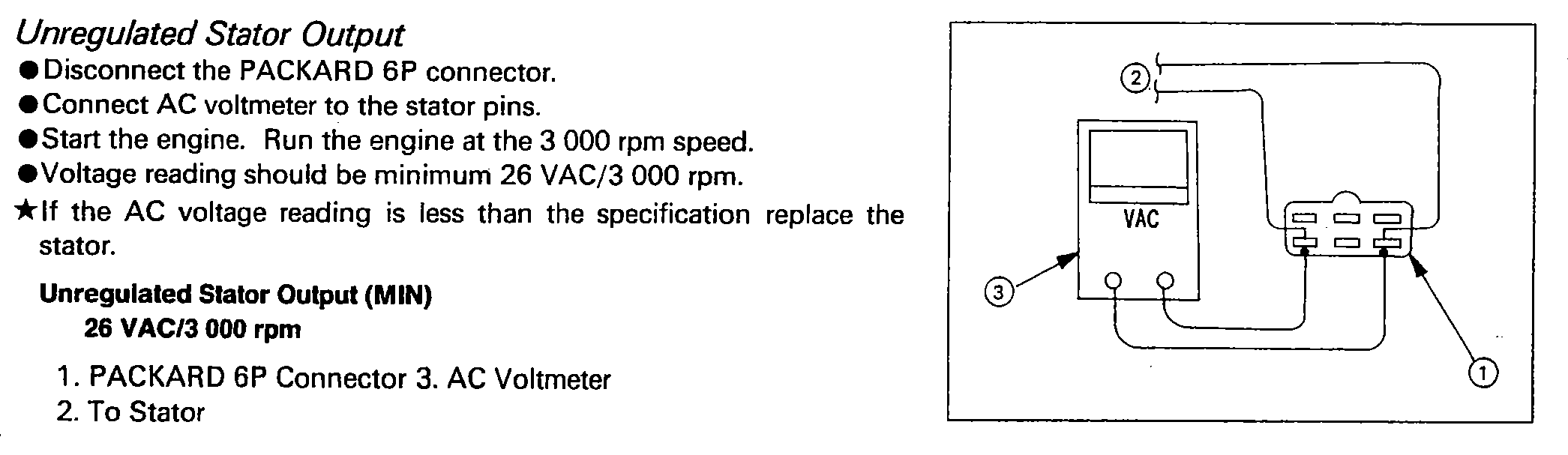

Follow these instructions to determine if your charging coil is working.
