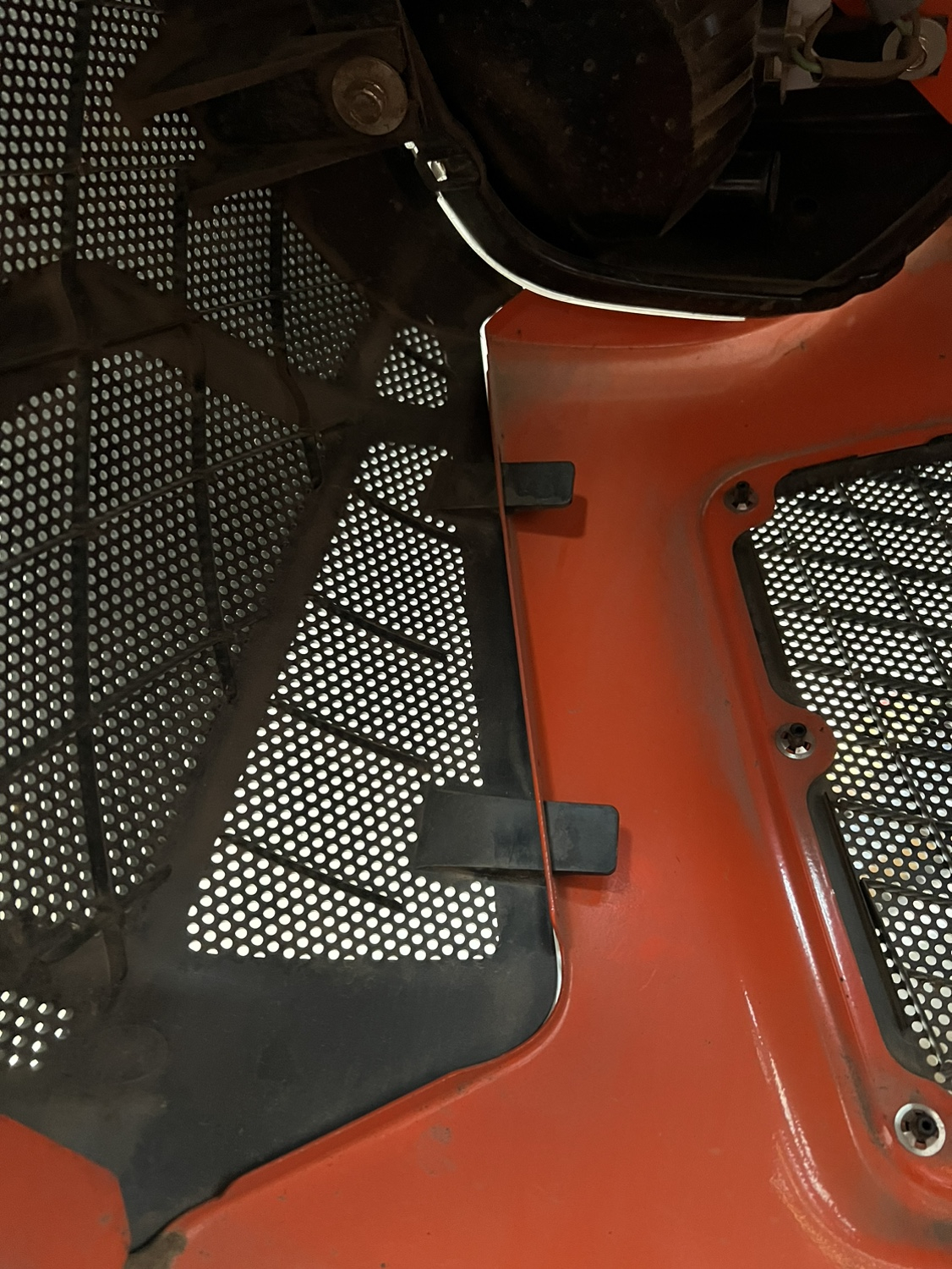

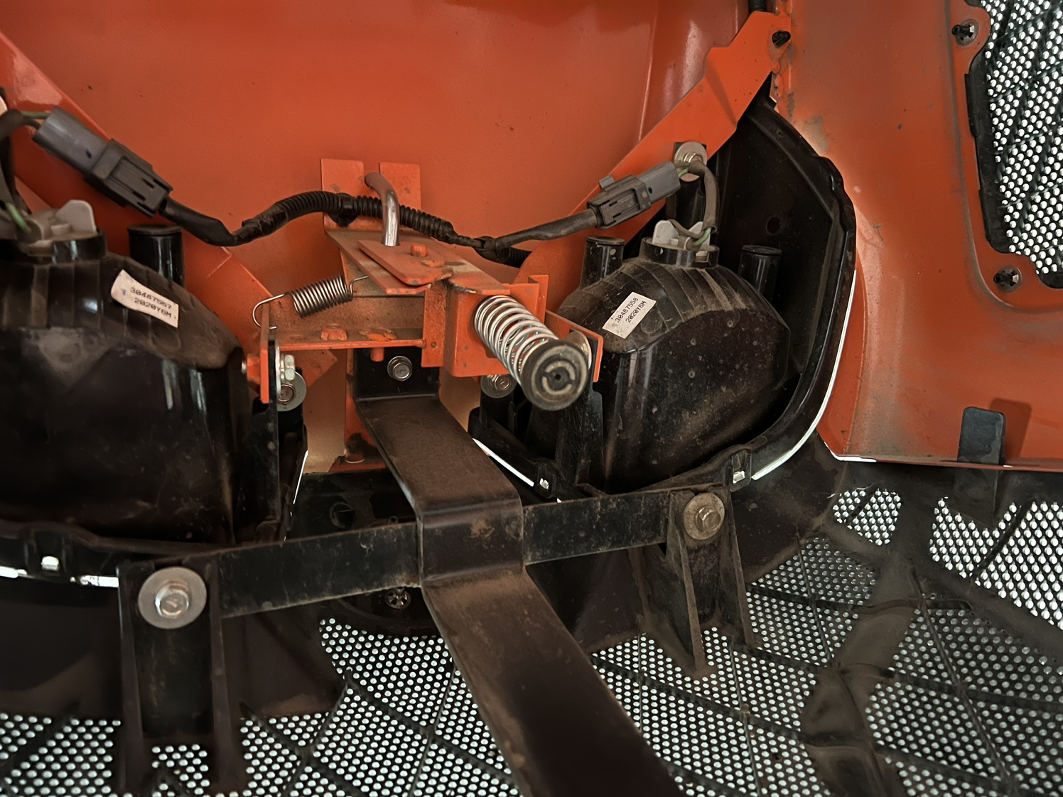

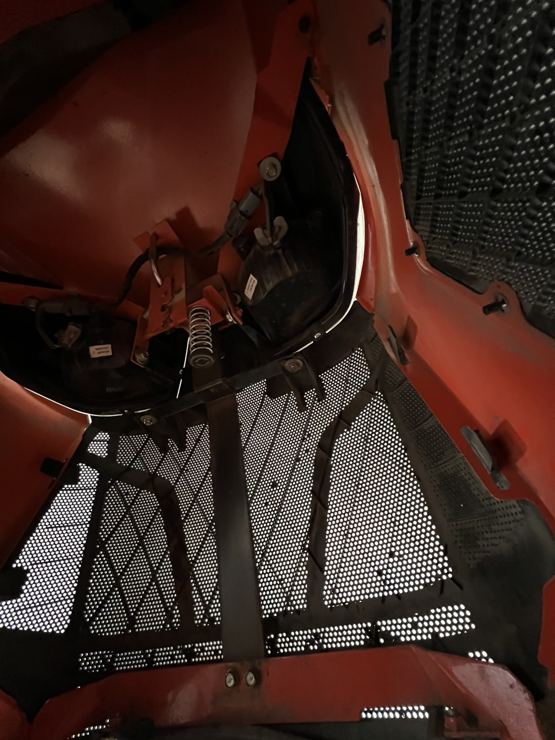

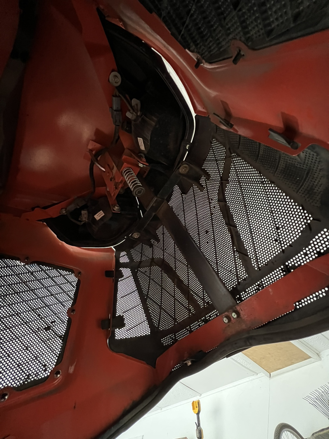

   / LX2610 Hood will not open #15
Some pictures on my LX2610:
   / LX2610 Hood will not open #17
nice pictures, can you get a few shots of the linkage that holds the hood up. I think that may be where the problem is since he said the hood opens a few inches then blocks
#18
Guys- thank you for your suggestions, all are were good as well as the photos. My friend just left, it was a simple fix and a foolish mistake on my part. I must have not attached the hood prop as it was catching in the lip of the bottom side of the hood. We were able to reach in and clear it.
