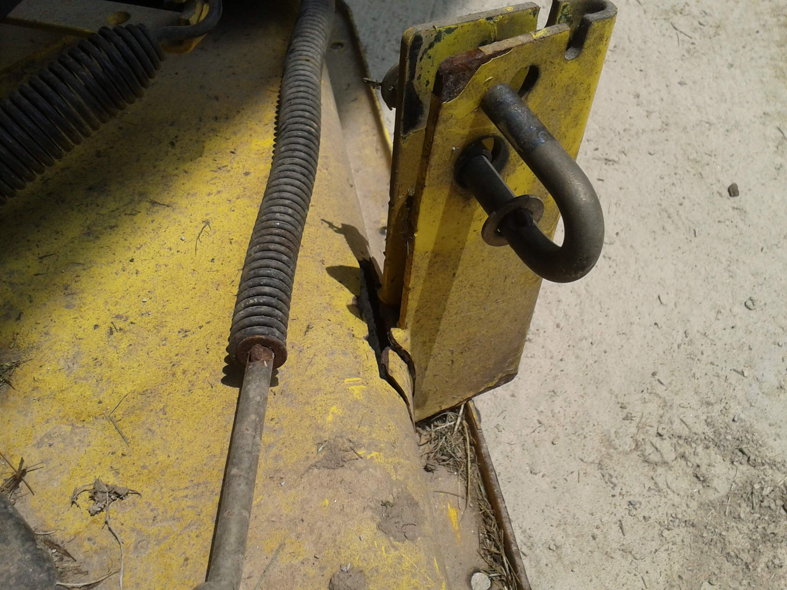

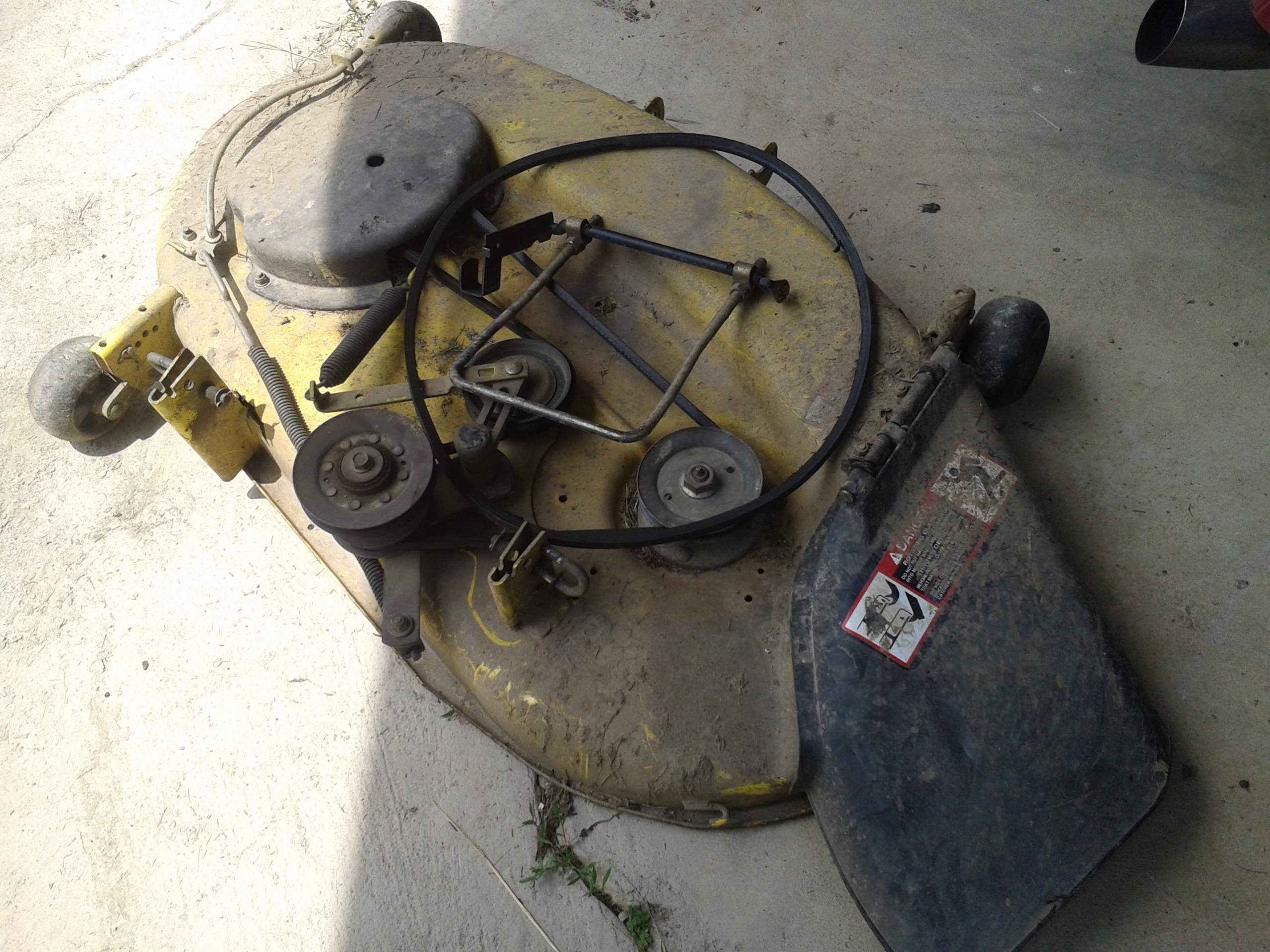

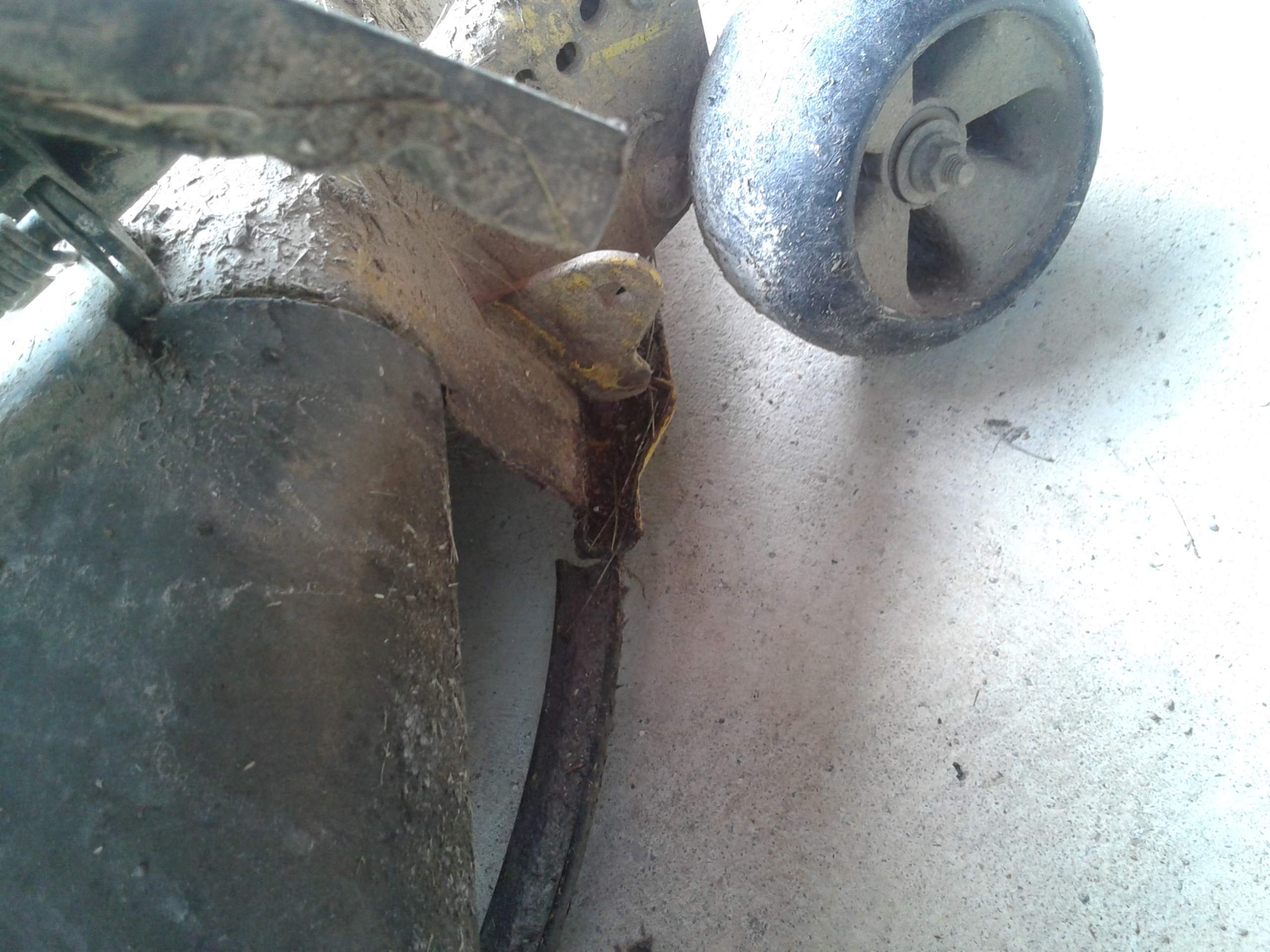

I dropped the deck this morning. Wow! It looks beat!
One of the rear brackets is cracked (see pic 2) and the exit opening is broken (pic 2).
The belts don't look great, so I'm hoping that is the problem.
The PTO with no deck attached is silent and spins great.
So far the spindles do not wobble, I need to remove the cover for the last, but I do not think that is it.
I cannot find any shiny spots inside and the blades manually do not hit anything that I can see.
So... Unless it is just loose/worn belts I am at a total loss for why it is making so much noise.
I paid to have it serviced 21 hours ago, and clearly they did not drop the deck and I suspect they did not lube the spindles.
Any help and advice is greatly appreciated.

   / LX266 mower making strange noises when PTO (Mower) engaged #16
WOW!!
That deck has been through **** and back.
Where has it been, and what has it been through?
Sorry, but it is not a tank.
Shocked that 210 hours can lead to that much torture.
Now to get you some help.
I'd take it to a good welder and ask if he/she would weld it back into some semblence of wholeness.
There isn't an issue of timing, as there is offset in the blades so they cannot touch. But I'd suspect something has bent the deck and/or the spindles that the blades are not running in the same plane.
While off, rotate a blade around to see if the tips pass each other in the same plane. Do it for each combination of the 4 tips. Hope that it may just be a bent blade such that replacement blades will fix the problem.

I'd clean it(top/bottom). Pull that cover off see what it looks like underneath.
Fill grease fittings put on new belt/blades . Weld or brace that grass chute bar.
Oil good and give it a whirl. I suspect when you slap it all together it will be fine. Check to make sure blades have to be set correct or same way. ;)
Store indoors if you don't already.
Hide keys maybe that fox has been taken it for joyrides ! :D
Wishing You and Family The Best !
Boone

That deck is in need of some welding and if feel like a bit of a drive just bring it over. It really is not that bad. Probably just needs spindle bearings and seals.
It does not look to me like a timing belt type mower. I looks like it only has 2 blades or is the back pulley a spindle also?
I just had to re bearing the BX1500 54" deck and mowed with it yesterday.
