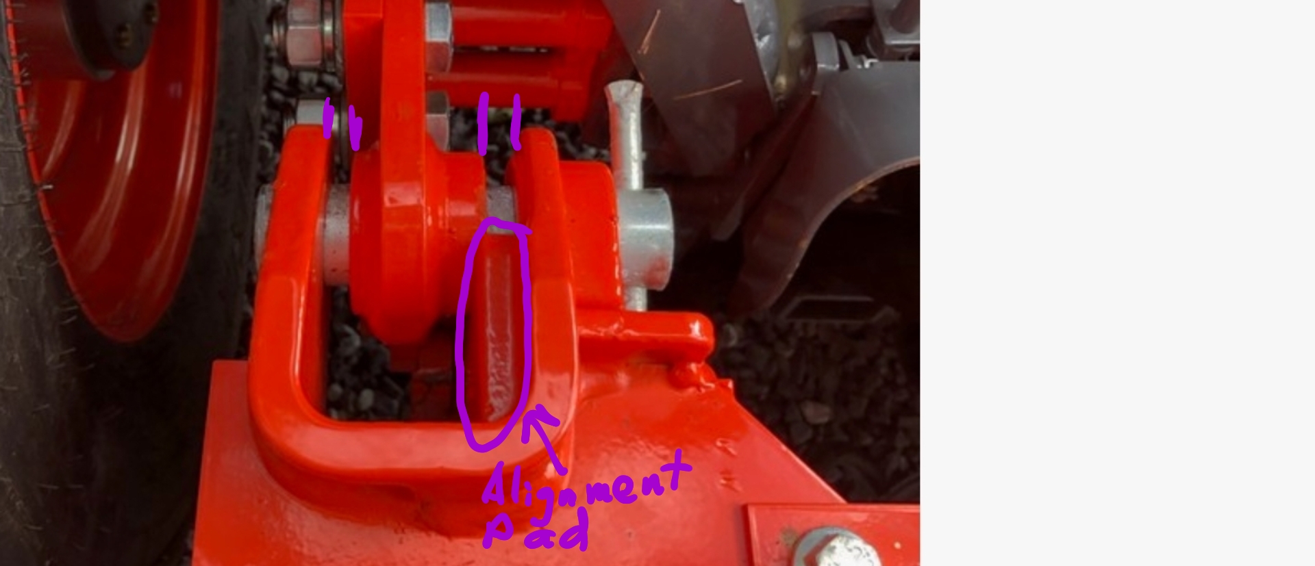

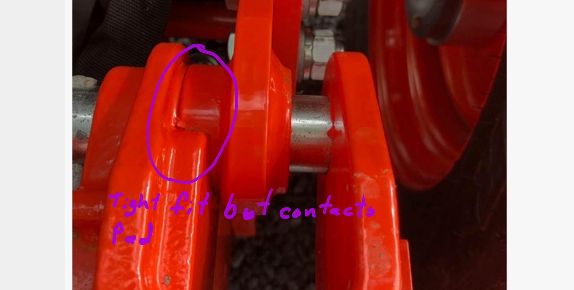

Bottom of backhoe fits into hooks tight zero clearance. Top left mount is shifted way left of alignment pad and doesn't contact it by much. Top right mount fits nicely on alignment pad. More issues here than just opening up holes to let a pin slide in easily.
Don't have a BH77 but a BH90 with same type of mounting system. On mine the bottom mount fits snug. The top mounts are perfectly centered and contacts the alignment pads equally left right.
Personally I wouldn't allow any bending or opening up of holes. Either some type of assembly error or something's fabricated out of tollerances. If it's a fabrication error demand new and don't allow rework.
   / LX3310 LX2610 Owners with BH77 BackHoe
#18
What are the alignment pads? Which pic? Are they the upper “bushings” attached to the subframe that the upper pins slide through?
Do you mean “top right” has shifted left? The 3rd pic is the right side of the tractor and there is no pin visible on the left, and that’s the side that does not want to drop in.

Too much paint build up on the alignment pads can cause clearance and pin fit issues. My thinking is the top mounts clearance left and right sides should be equal after dropping into bottom hooks. Both should contact the pads equally.
   / LX3310 LX2610 Owners with BH77 BackHoe #20
On mine everything was machined so precise after dropping into the bottom mounts and pushing the backhoe against the top pads the pins slide in without having to bump the hydraulics further to align holes. When it was new I had to remove some paint.
