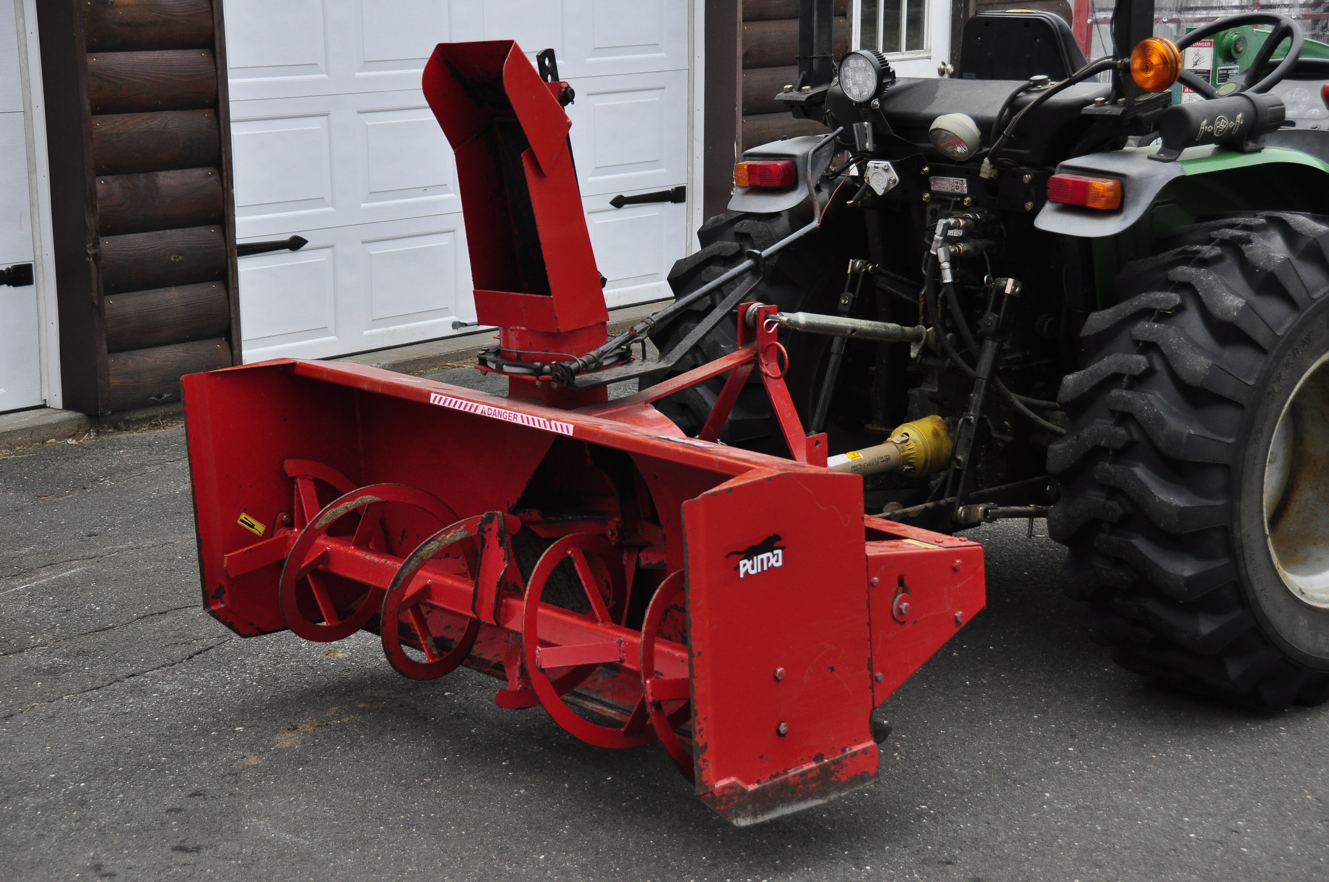

I googled the blower that you have and it appears to have an open chute, almost all the way from the base to the top. If this is the case, try closing off that open area, and you should get a lot more distance. If it works, make this modification easily removable, so if the chute plugs up, it can be cleared with minimal effort.

Just went and clamped a piece of plywood over it no better. Anyone know what effect it has by the amount of the fan that is closed off?

I was reminded of one other idea that may help. In my reading there is a modification that many have done and that is to bolt rubber flaps on the fan/impeller blades, especially if there is a gap between the blades and the housing. Just search "snowblower rubber fan blade modification" on youtube. In my case my impeller is 22" in diameter and there is only about 1/8" between the impeller and the housing so I have not added the rubber flaps. I realize that your subject line indicates you were looking for feedback from other Lynx owners, yet we non-Lynx owners keep bugging you with suggestions - sorry.

I have a Puma blower, and I don't get anywhere near 30 feet. More like 15. But it clears snow well at a reasonable speed, so I am happy with it. I think to get more distance it would need a faster impeller speed and or larger impeller. My impeller is 22". Pronovost sells a speed accelerator with a 1 to 1.4 gearing. They say it takes 45hp to use.
How much of a gap do you have between the impeller and the housing? You can add rubber strips to close the gap, and that will increase your throwing distance. There are a number of youtube videos showing the improvement.

Gap is 1/8 a the the most I use to do the rubber flaps to walk behind blowers. I'm thinking it just might be the blower design

Try ed increasing engine speed made little difference my fan is 21 and the other blower is 24 I wanted to try Thay blower on my tractor but he doesn't want to be bothered with taking his off.
Fan diameter does make a difference in snow throwing distance.
A few years ago I upgraded from a 64" wide Puma to a 64" wide Frontier.
Other than age, the only significant difference was the impeller diameter.
Puma 22" Frontier 24".
Some large areas of my snow blowing required re-blowing the snow again to get it out of the way.
To insure max throwing distance, it's about the only time I run my snow blower at the full 540 pto rpm.
I don't know the snow blowing distance difference in feet between the two snow blowers,
but with the 24" impeller snow blower I am not re-blowing nearly as much snow as when I had the 22" impeller snow blower.
