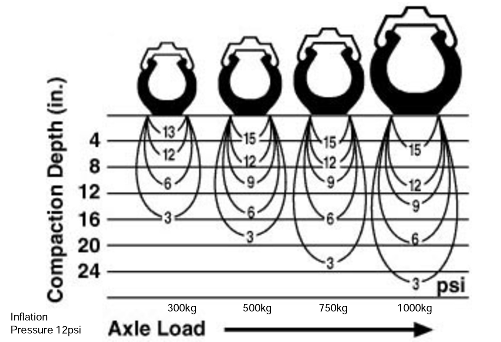

I'm on some pretty serious slopes, so I really want the ballast for extra stability. As long as the tire's psi is the same shouldn't compaction be the same ballasted or not?
Here is an illustration from testing different tractor sizes, tires all inflated to 12 psi, small tractor to large tractor, tire size changing with tractor size to match load capacity. In the past, I had the opportunity to visit a facility where they tested soil compaction profiles like this, primarily for evaluating materials and methods for road construction but also for agricultural purposes. Concrete channel 2 meters deep and 5 meters wide so compaction would not be affected by the base. Soil type to be tested trucked in (massive amounts) controlling soil moisture, other parameters. Drive across, then measure compaction profile using nuclear reflection. Quite impressive if you want to construct a road or building but overkill for ag, except easily identifying advantage of large track tractors over wheeled versions when it comes to compaction. Also why we are seeing farmers spend big $$$ for track type grain carts so as to not destroy next year's yield by compacting it like concrete toting out this year's harvest.
