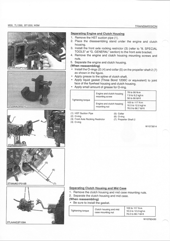

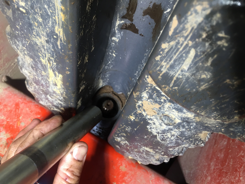

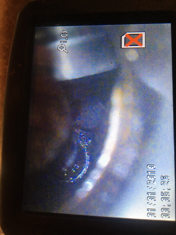

I brought it home and took front drive shaft off to try and absolutely verify the propeller shaft is leaking and not from axle. After you take drive shaft off which is pretty easy, this collar you see in pic slides off. The other two pics are iPhone pics I took of a handheld snake camera. You are looking at the propellar shaft and the seal that is about 5" in housing.I think it's safe to say propeller seal leaks. On the positive side, I have never had to add oil because of this leak, it minor compared to the 12 gallons it feeds from.. On the last pic it is a page from service manual. It says there should have been an o-ring on end. There wasn't.

The 4wd output shaft and transmission input shaft looks identical to my 5240. I did not have to remove the mid case as your instructions say. You can get to the 4wd output shaft seal with a couple of picks after you have removed the snap ring. It really wasn't too difficult when I did mine.. I consulted the mechanic at the dealer beforehand. He has done several. You'll want an extra set of hands though. You need to keep constant pressure on the shaft to make sure it doesn't slide forward after you remove the snap ring. I am told it is very difficult to reinstall it if it comes out.
I also lifted up the mid case with an engine crane so that it was tilted up in the air. We lost maybe a 1/2 gallon of fluid that way.

I was thinking you meant you didn't split the tractor and replaced seal from propeller opening. No, you don't take the mid off, just split like yours.Difference is the loader frame makes it labor intensive. That pic is from a service manual, not instructions for seal replacement.
