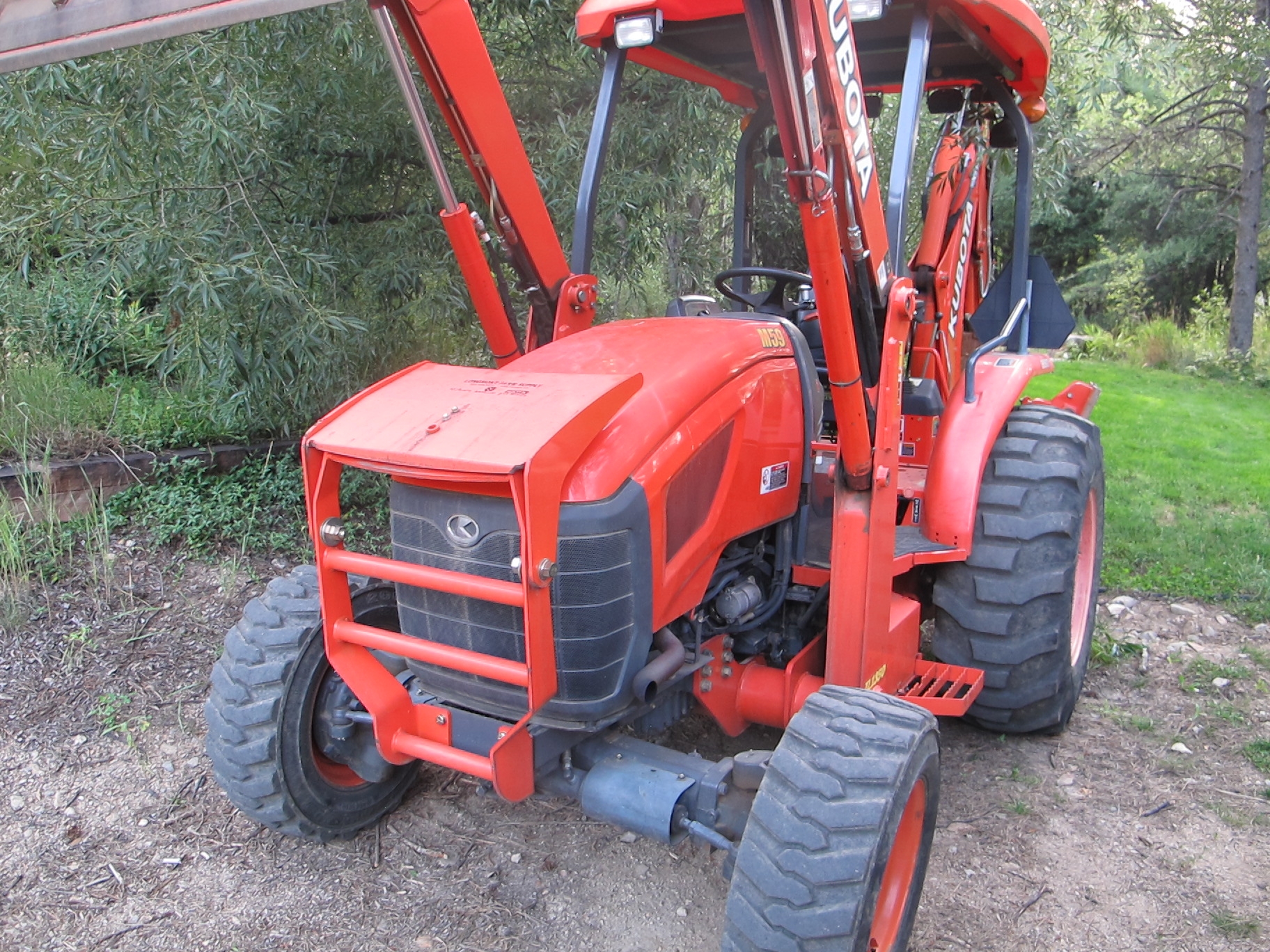

Part of the reason that the M59 is so much fun to modify is that it was designed by someone who really understood the artistry of mechanical design. You can see the M59 designer's attention to craftsmanship in the optional dual use Hood Protector.
His hood protector is such a basic thing that it could be overlooked - but Kubota's M59 designer not only made something to protect the front, but made it strong enough, attractive, and multifunctional. The whole tractor is like that.
