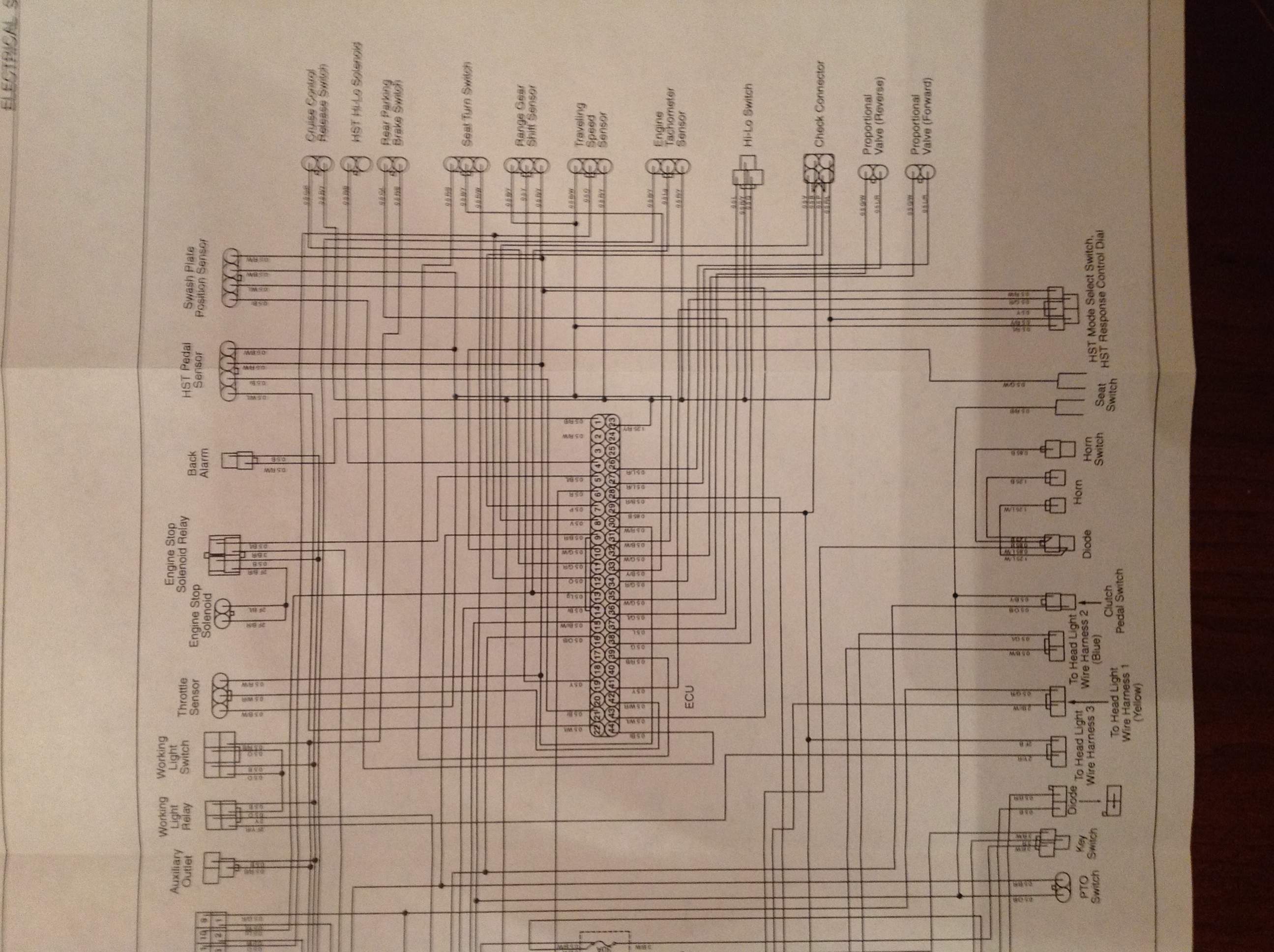

T12 and T13 are the swash plate main and sub position sensors. The expected values are in previous attachments. If they are not normal I think I would check the wiring and connectors.
I can send you the adjustment sequence for these sensors. However, it sounds like you have no signal at all.
   / M59 will not drive
#24
I do have a voltage reading from the sensors, it just doesn't change as I give it throttle. Thinking this means something between ECU and swash plate is wrong?

Ok. Tractor is fixed!!!!! It was the switch on the high/low selector lever on the left of the steering column. Switch had shorted. Whew!! I was about to have to rent a machine to dig a footing tomorrow. Got a guy that works for me that has a friend who's a heavy equipment mechanic and he took a look at it tonight. Have no idea how he traced the problem down, but be said before he looked at it that electrical problems were his favorite to work on. Looks like he's pretty darn good at it.
