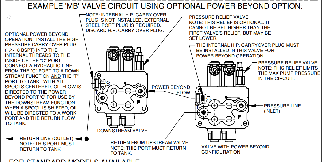

He'd have to remove the power beyond from the 3 stack valve he got from Fit Rite. Probably should contact Fit Rite for instructions.
   / M62 Fit RiteTop'nTilt/Rear Remotes #12
Example of power beyond plug in a Prince valve. Some valves are different and have an adapter with o-rings to seal the high pressure from the tank circuit.
