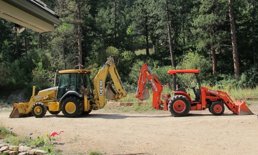

We have a Kubota M59 TLB, which is the M62 predecessor with a slighly shorter BH boom.
Yes, the Kubota TLBs are noticablly more stable on hills than a tractor because they weigh twice as much and because a lot of the weight is low down due to heavier duty construction.
You can also add rear wheel weights and spacers.
But with that many acres, and considering the price range you are already looking into I would recommend a full size TLB. Something like a low hour Deere 310G - actually any model 310 from the older E to the newest ones would be more stable than the Kubota. And they are comfortable, too. The JD310 stability and durability is in a whole different league from homeowner TLBs like the Kubota. I know that for a fact as we live in the mountains and have both.
Stop by your yellow (commercial) Deere shop and try one out.
Our 310 has a buddy seat plus room for the dog when we drive it to town.
Whatever you get, get it with a thumb. I try to go straight up and down hills. When I have to traverse a hillside I pick up a log with the hoe+thumb and swing it alongside the uphill side of the tractor as a counterweight. It helps a little with the pucker factor. Better yet, get a dozer to make you some roads.
There will still be plenty of work for the TLB after the dozer leaves.

As JWR says, the Japanese don't seem to understand about widening the tractor wheelbase for hillside work. But American farm tractors do.
There is a 3pt kit for the M59/62. I'd get it if you go that way, but swapping the hoe and 3pt is enough of a chore that you may want to keep your eyes open for an extra 3pt tractor.... an older American farm tractor for the 3pt hillside work. Although compact and utility size tractors don't have much ability to widen their stance, the next size up in the tractor world are those farm or ag tractors and many offer adjustable width of the wheelbase.
Our old JD "B" ag tractor isn't much good for anything except 3pt work, but like most farm tractors it came with long rear and front axles. The tires can be extended out along those axles to nearly ten feet total. That makes it almost as wide as it is long, looks ridiculous, but is almost impossible to flip. You can find ag tractors with extra long and wide axles.
My own view about hillsides is I try every way possible to avoid going there.
Both of our TLBs will will slide sideways before it begins to feel tippy. I don't know why that is so, but am very glad it does. Both have wide construction tread tires with heavy sidewalls. The M59 weighs a bit over 8000 lbs, the JD 310 about twice that.
