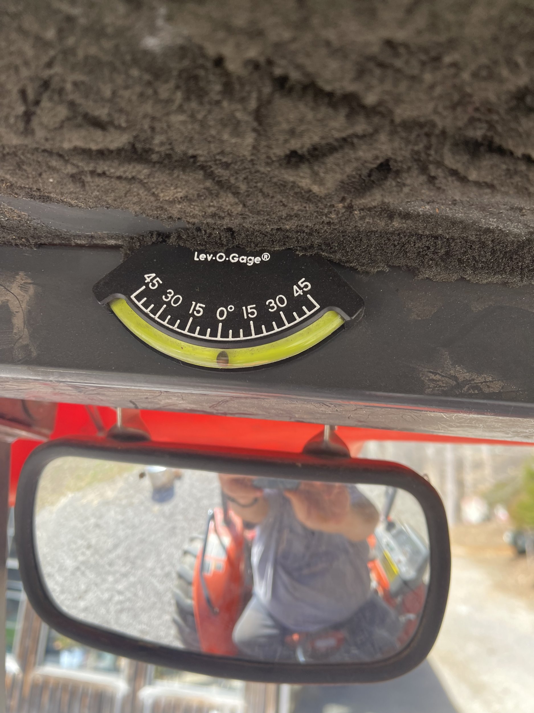

Stability on the side hills worries me too. Those areas can be more in the 25% (15 degrees) range. Will the M62 be more tippy than the JD 4710? How does the backhoe affect the tippyness?
Here is what I have done to my L39 for stability and to increase loader capacity. See: L39 Fuel Pump Turn Up. Zoom-zoom, sort of. My neighbor has an SV95 CTL, getting rid of his fairly useless L3901. CTL faster stronger, more maneuverable than TBL, but good to have the swiss Army Knife.

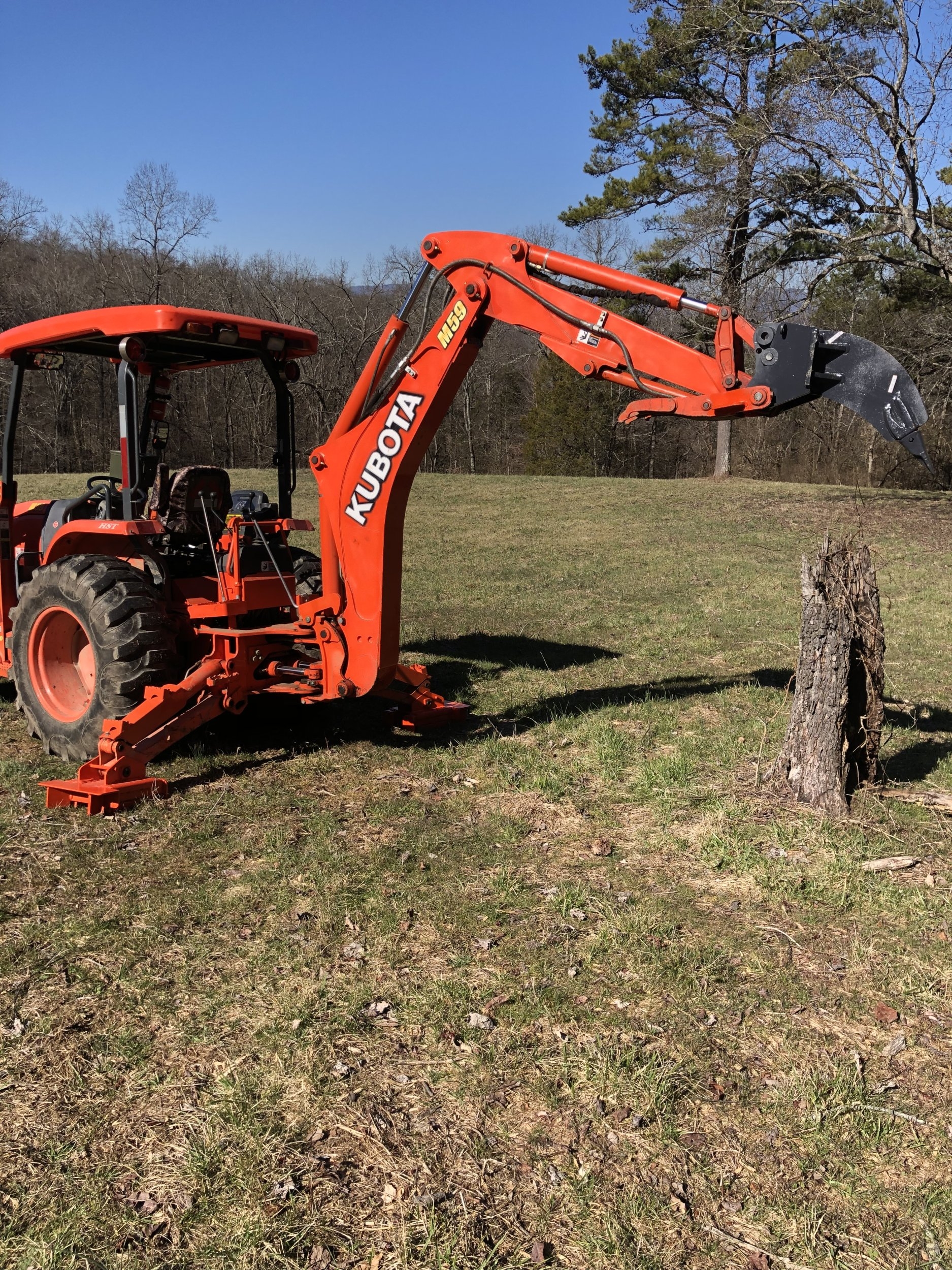

We have a Kubota M59 TLB, which is the M62 predecessor with a slighly shorter BH boom.
Yes, the Kubota TLBs are noticablly more stable on hills than a tractor because they weigh twice as much and because a lot of the weight is low down due to heavier duty construction.
You can also add rear wheel weights and spacers.

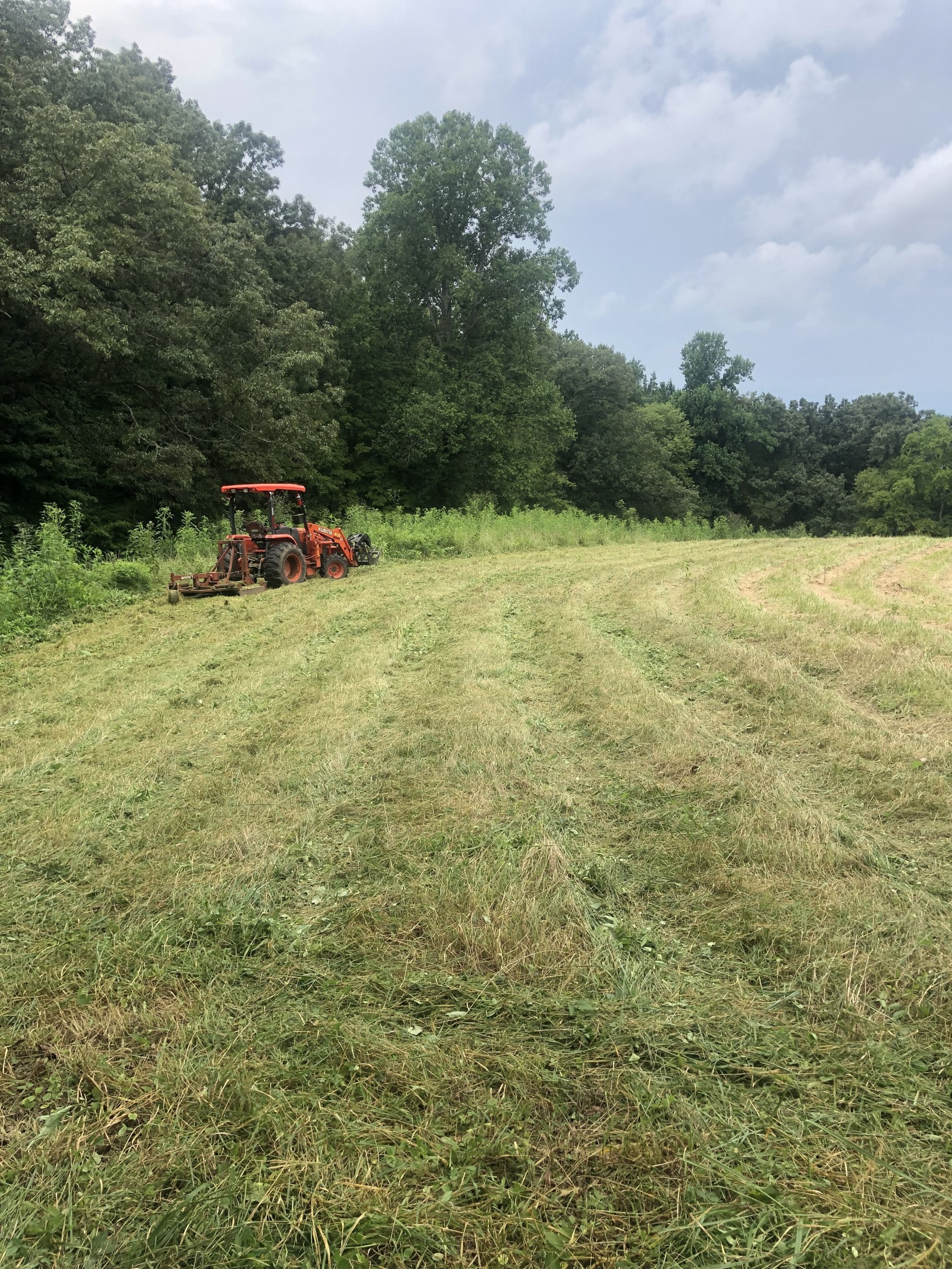

Whatever you get, get it with a thumb. I try to go straight up and down hills. When I have to traverse a hillside I pick up a log with the hoe+thumb and swing it alongside the uphill side of the tractor as a counterweight. It helps a little with the pucker factor. Better yet, get a dozer to make you some roads.
There will still be plenty of work for the TLB after the dozer leaves.

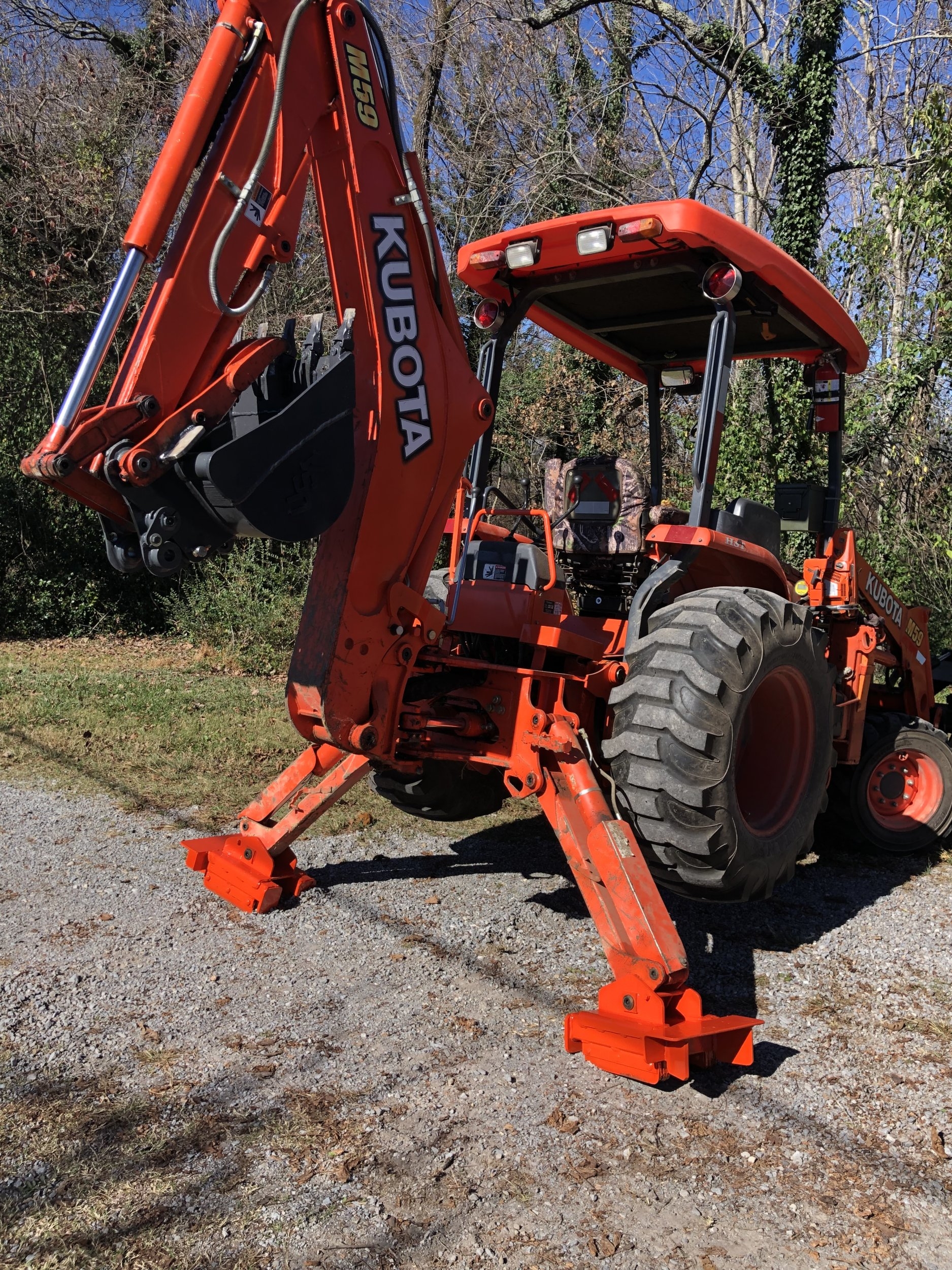

Had Ford 4500 backhoe for over twenty years. 2wd. Very tippy on our hillside farm but proved just how handy a backhoe was. So much improved over ag tractor backhoes.
Had the M59 for years before finding an backhoe attachment. Pleasantly surprised how stable the M59 was with the backhoe. Still have to carefully, constantly swinging the boom when traveling or loader work on slopes. Comfortable to control. Good power and controls for a compact machine.
Not the machine for large excavation jobs but more than capable for owner, farm and construction. Footers, septic, road, ponds, creeks, trees, etc. Compact size more valuable than larger capacity for our use.
