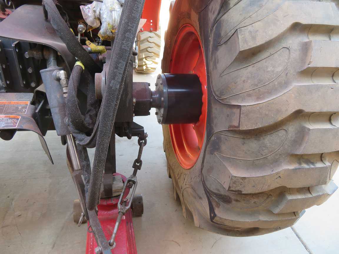

Just to follow up, I ended up installing a pair of 6" spacers on the M62 rear wheels. They came from Bora, and are aluminum. Apparently they're a custom made item, and they took 9 months to deliver them. I haven't had to mow yet, so I haven't had much of a chance to see how much stability has improved on side hills. But just knowing there's a wider stance back there is comforting.

About your wheel spacers: They look exactly like the ones I bought for my smaller B2150. Of course the bolt pattern and overall size is different for your model, etc. I am shocked it took them 9 months !! My guess is that Covid-19 had them shut down for much of that period !? When I ordered mine 3 or 4 years ago it was about 3 weeks as I recall to get them. Not long and certainly not months.

That should make a considerable difference in stability. Interesting what you think of reduced turning radius and clearance around trees.

Back on topic: RedNeck you will absolutely find a big difference in stability on side slopes. It will be much less tipsy. 6" per side is significant.
