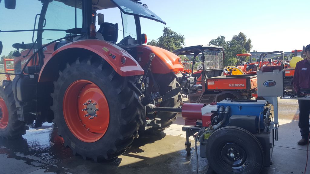

Here we are with the M7 hooked to the dyno. It made 142hp at 580 PTO RPM. With the throttle turned down to 2005 RPM/540 PTO RPM it made 110 HP.
Brian
