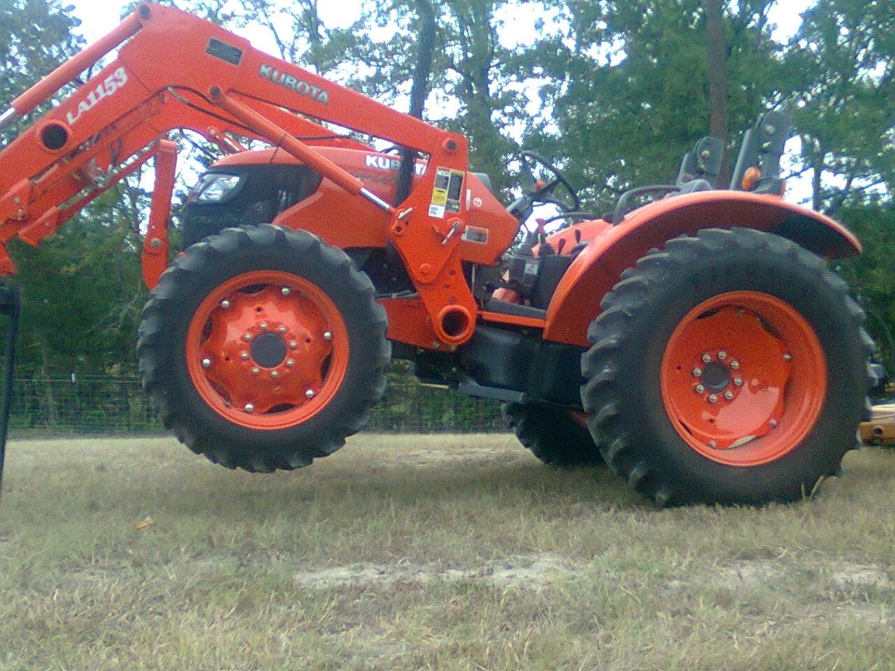

I un-loaded 4-2500lbs pallets,every month for the past 5mnths,the 5040 is usually the one thats at the barn to un-load....
I may be done with cubes this year but if not next time I un-load will snap a picture,I have the tires loaded but have to use 4x4 to move them into barn..

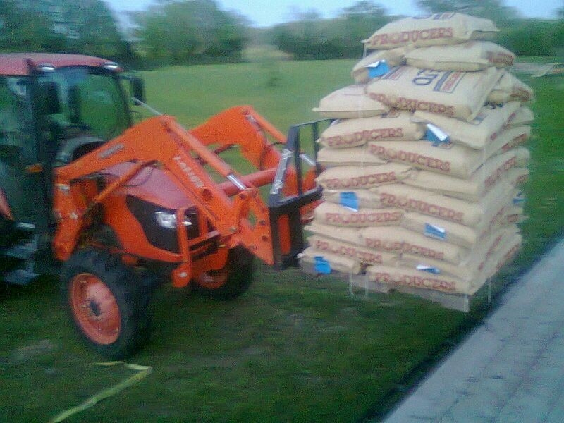

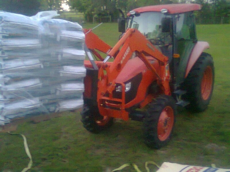

I didnt have the 5040 around at lease place,so had to use the 7040. Tractor isnt loaded on rear and only has hay spear on back. Ton of feed in each picture they are just stacked different....
