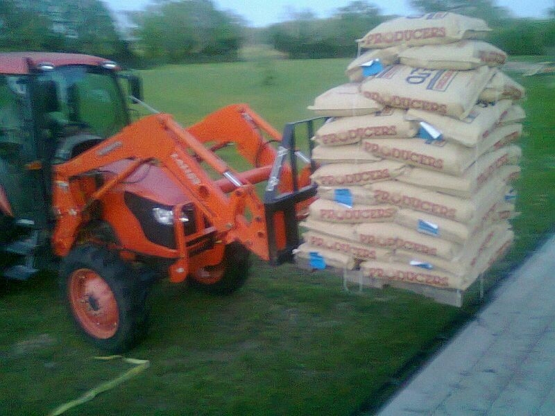

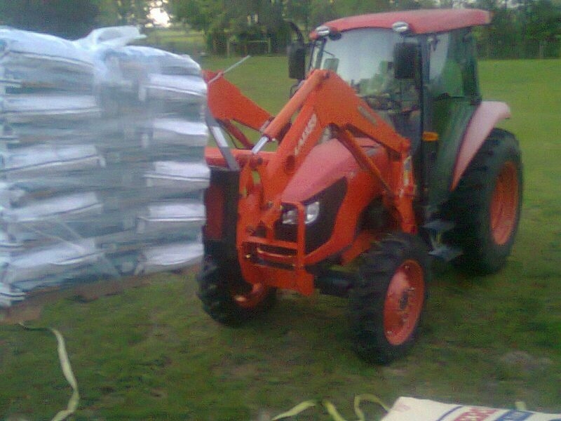

Wow! Whats the pressure in those fronts?
larry
I cant remember but it rides smooth while shredding,if going to do alot of loader work may need to add alittle. My Pallet fork are on the 5040,had to use the Hay forks to un-load.
