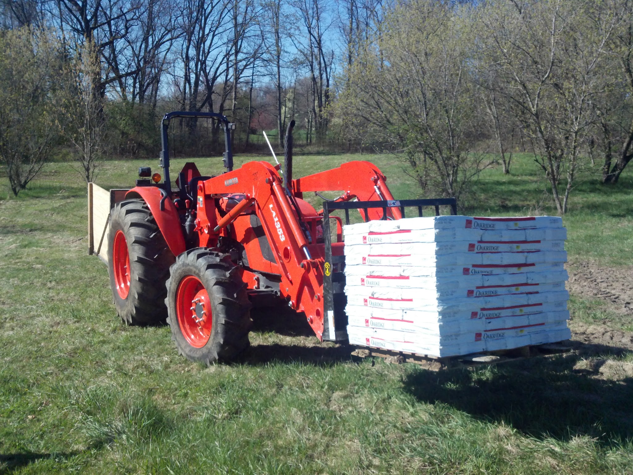

Those numbers are to full height if you look at the Canadian site they give all sorts of numbers especially the very useful point to 60" off the ground 800 mm forward of pivot or approximately the bucket front edge the la1353 on the 8540 will lift just under 4000 lbs the real reason i bought the M8540 over the M7040 LA1153 at 2650 lbs remember my 5000 lb rated forks weigh just over 400 lbs so that comes off the capacity. with that said you could probably narrowly load a 2000 lb pallet onto semi a truck but it would be very close.

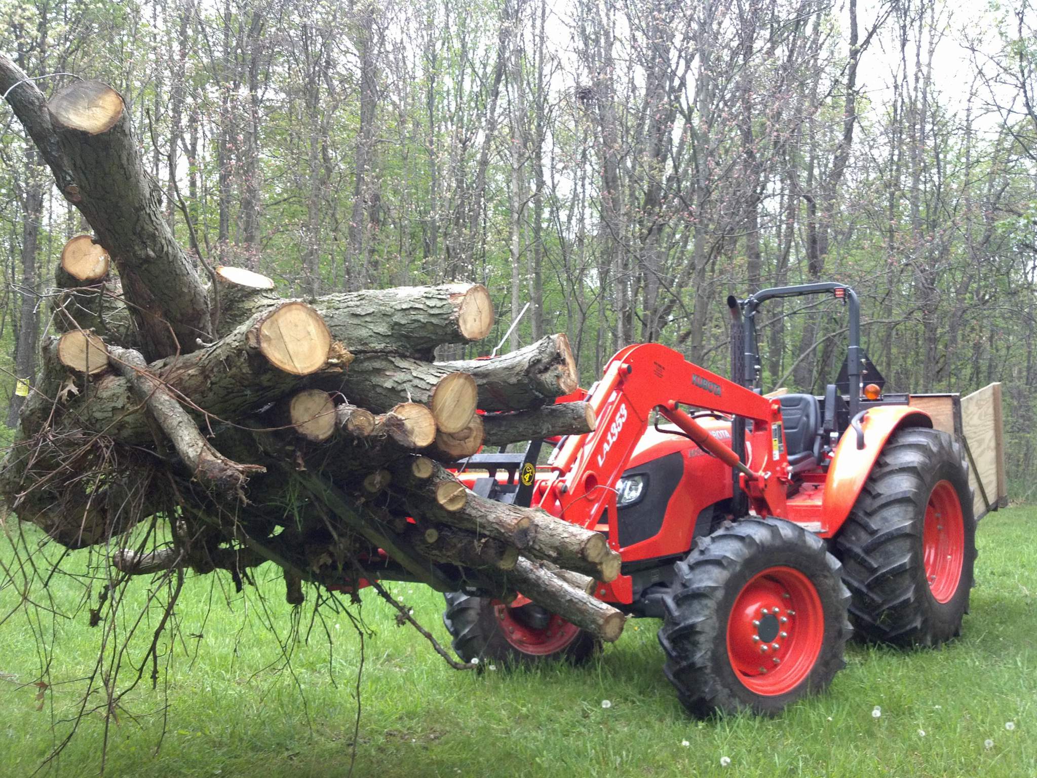

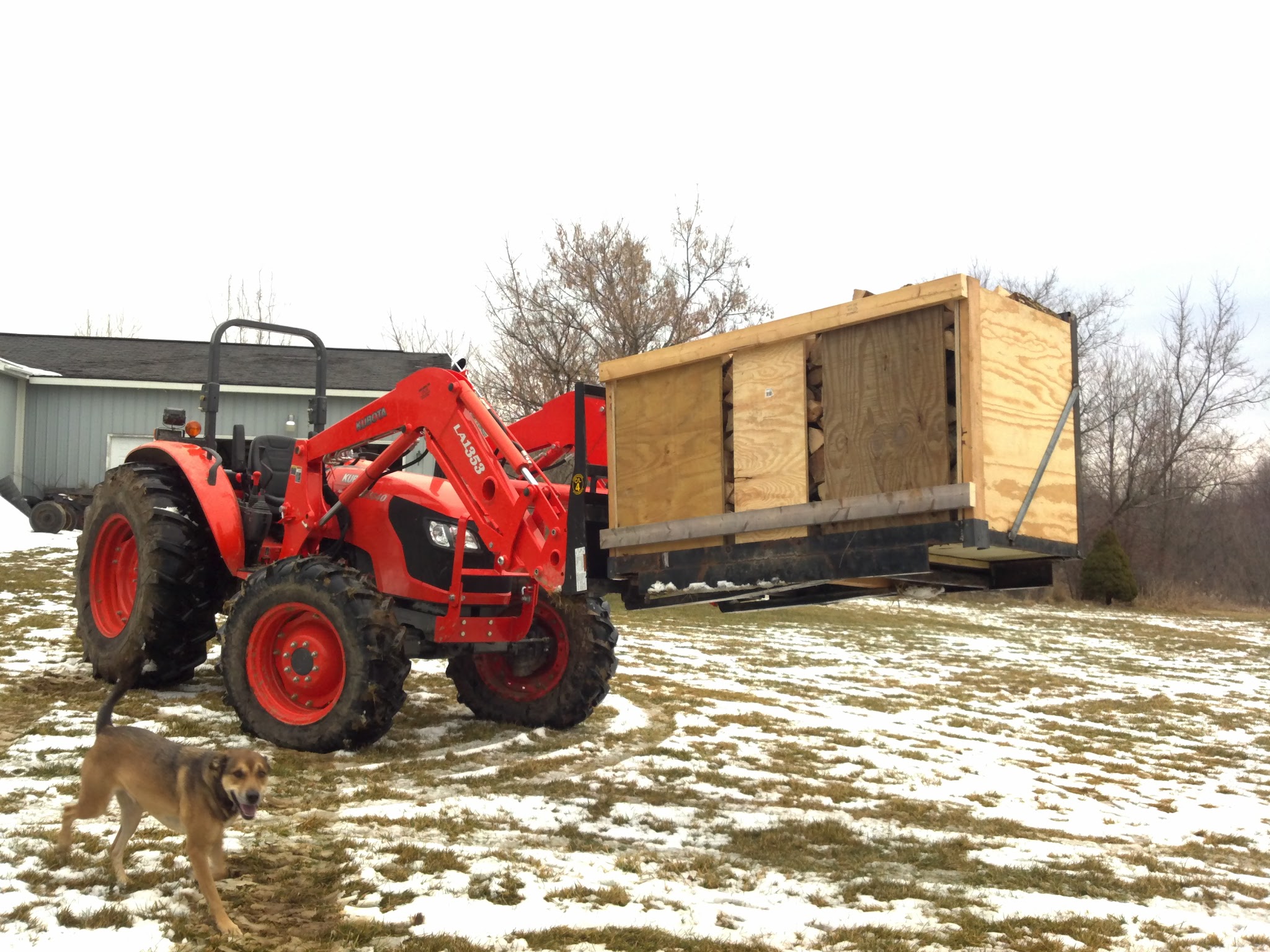

Some pictures of what the La1353 is capable of lifting. I took 3 full pallets of ~2600-2700 lbs of shingles off the lowes guy after he said there was now way he could get them out to my barn with he 3 wheeler fork lift. In the first picture i was loading just under a 1/2 a cord of wood into my pickup truck in a box that weighs close to 500 lbs empty. I lifted two 3000 lbs pallets out of a freight truck for the neighbors 36x42" i had to grab them long ways out of the truck one of the heaviest things i've lifted with my loader. No need for a forklift or skidsteer with the LA1353 :D
